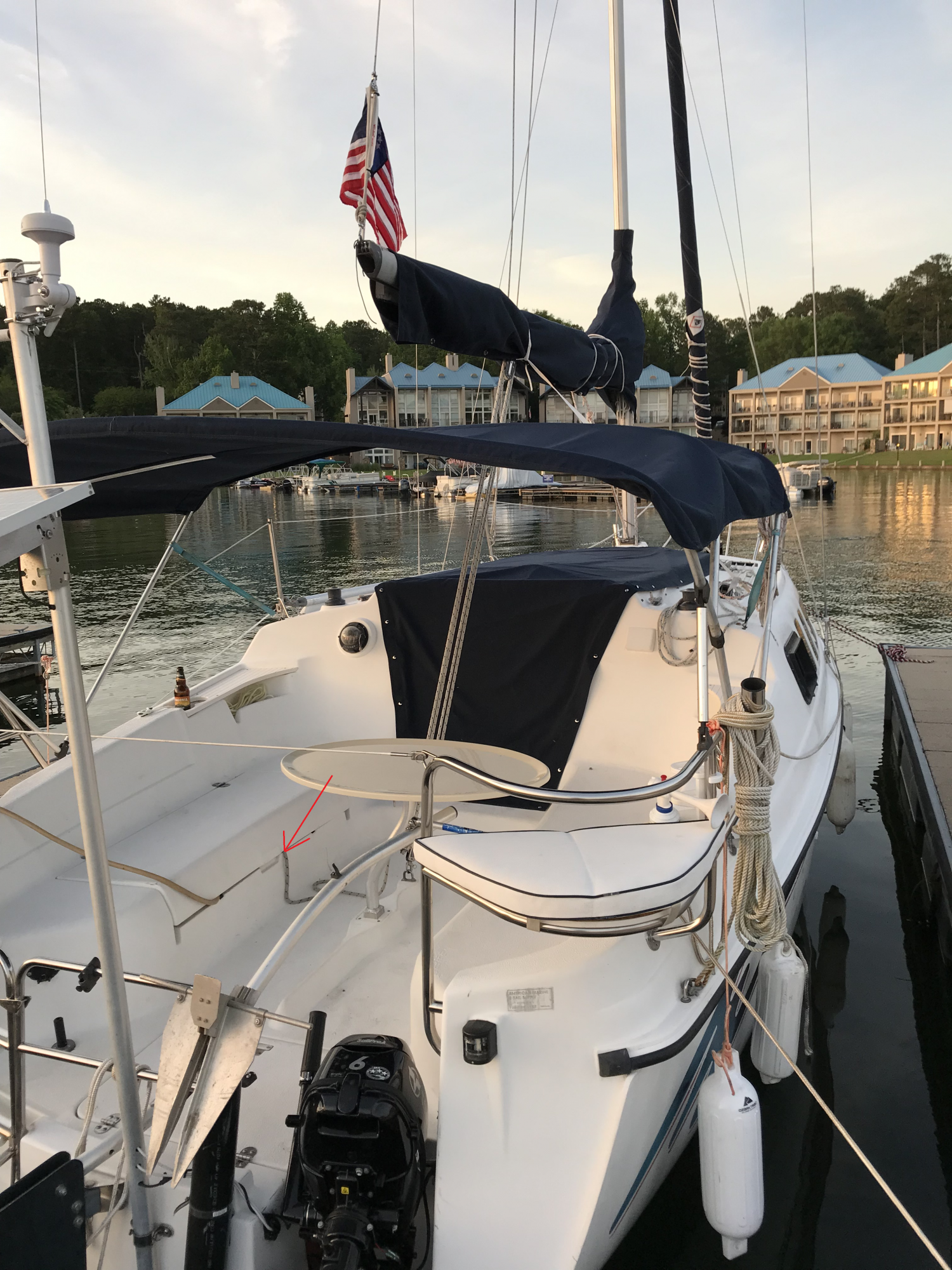

What was a PITA on the H26 was the length of the main sheet. It was WAY too long and you always had a lot of extra rope to coil ... I stowed the excess in the cockpit locker and still had a coil of it on the floor to let out the sail when necessary. Here is a pic of how you had to stow the excess sheet...
BUT! you could not shorten the length of the main sheet because the main sheet and block system double-dutied as part of the mast raising system and you needed the extra length then.

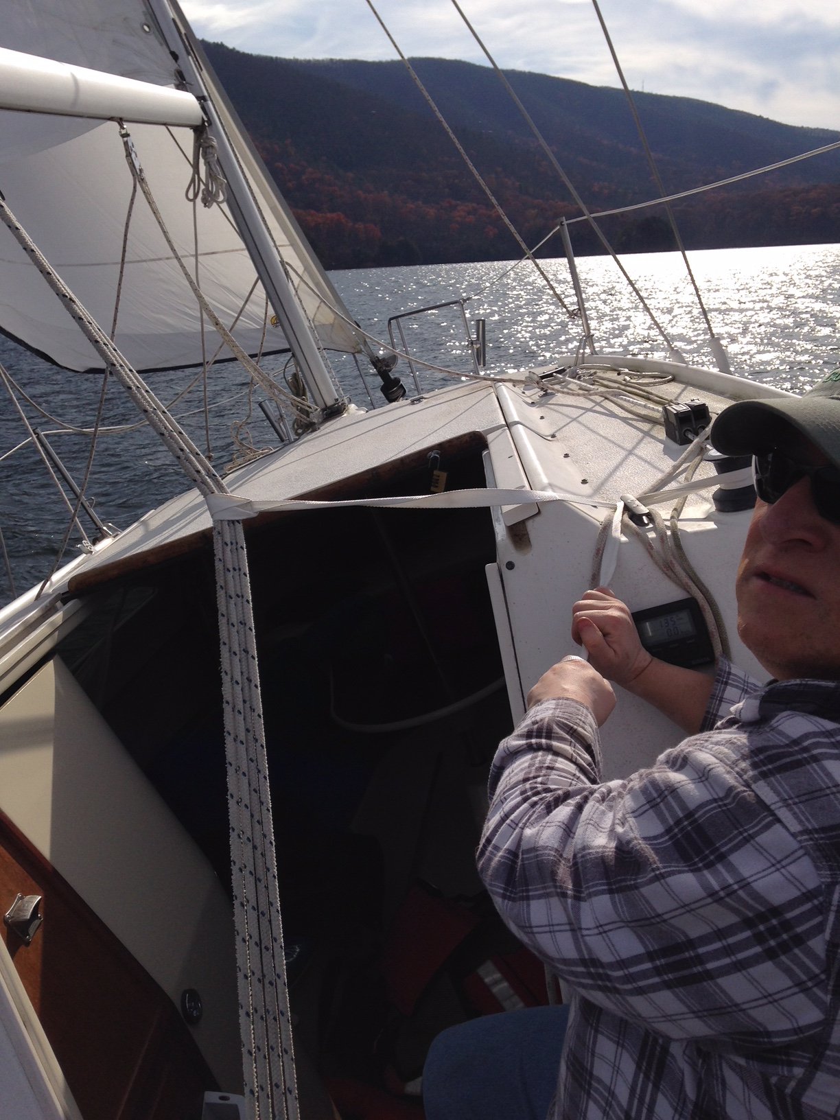

The pic above also show the setup of the mainsheet before I installed the traveler. The mainsheet anchored at a point that was midship. There was no way to get the boom to centerline or even close to center line. It really affected your upwind performance.
Before the traveler, I would bring the boom over this way...
