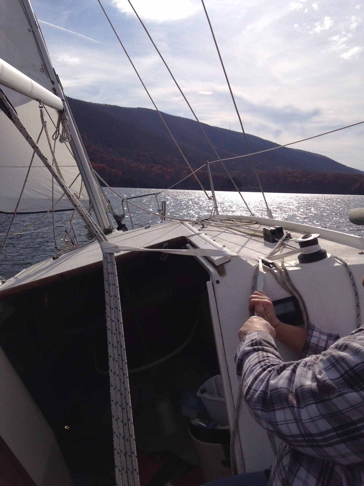

I have a 26 and not a 260 so maybe different but, I was surprised at how well my boat points. I'm less impressed with the performance on a run. One thing the 26 and 260 could benefit from is a traveler system. When pointing I use a sail tie to haul the sheet to windward. This small adjustments greatly improves the upwind performance a lot for my boat. YMMV

I have been thinking of a traveler right at the hatch opening. moving the sheet forward to make room for more bimini and well its a traveler

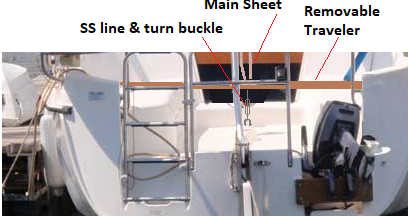

I have been looking into this traveler for my boat...
But it is pricey... so I have been thinking about designing my own. Something like this....

I like the removable traveler idea except for my family of five moving about the cockpit. I'm certainly going to try the tweek line and may add a traveler in the future.

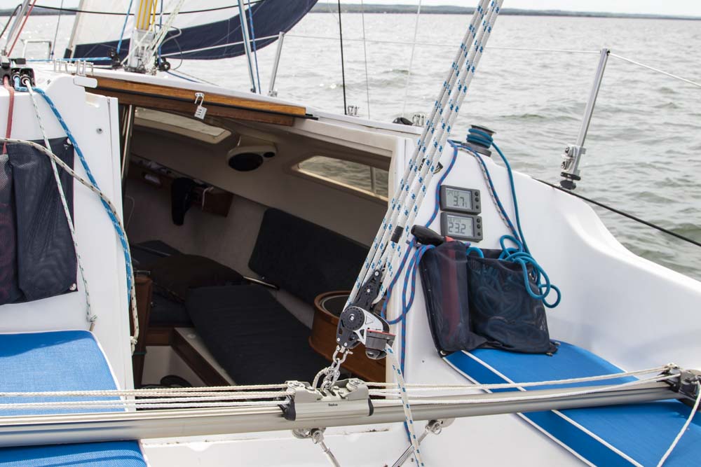

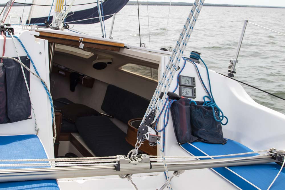

I make a point of never contradicting @Crazy Dave Condon when it comes to his knowledge and background with Hunter boats. However, adding a main sheet traveler did improved the pointing ability on my 2007 Hunter 25. A traveler allows for much more control in all points of sail and especially in pointing. As for proper mounting, the center of the traveler is attached to the original main sheet bracket and is split out to spread the load over a wider area. The ends are bolted to the seat back rests with backing plates. Access to the inside was gained by cutting hand size rectangular openings in the liner. The liner cut-outs were reinstalled and secured with mahogany trim frames.
As mentioned earlier, new sails also helped but if I had to choose only one addition, I would go with a traveler.

13,096
That looks perfect!!!!
