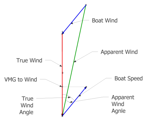

If you can sail at 45 degrees to the true wind, and can get to 5.5 kts of speed through the water, in 10 kts,of true wind speed, you’re doing quite well for a 26 foot cruiser.
But what you’re going to see at your windex and mast head wind instrument will show some thing different. The windex will show the apparent wind angle and apparent wind speed.
For example, a Benteau First 27.7 can do about 5.5 kts though the water in 10 kts of true wind at about 45 degrees off the true wind. The mast head windex will show an apparent angle of about 29 degrees off the wind, and an apparent wind speed reading of about 14.4 kts.

VMG to wind3.89
T Wind Direction45°
T Wind Speed10
Apparent Wind Speed14.4
Boat Speed5.5
Apparent Wind Direction29.4
TWS = AWS - BS *0.8
Boat speed as % of true wind speed55
VMG as % of true wind speed38.9
masthead fly
Click on graph to print out larger paper that you can plot other points on.
I can't go that fast when I'm hard on the wind. My boat tops out at about 5.8 on a broad reach. And you are correct. I was not thinking about apparent wind. However, I can get my windex inside of the tabs and for me.... I call that good enough.
