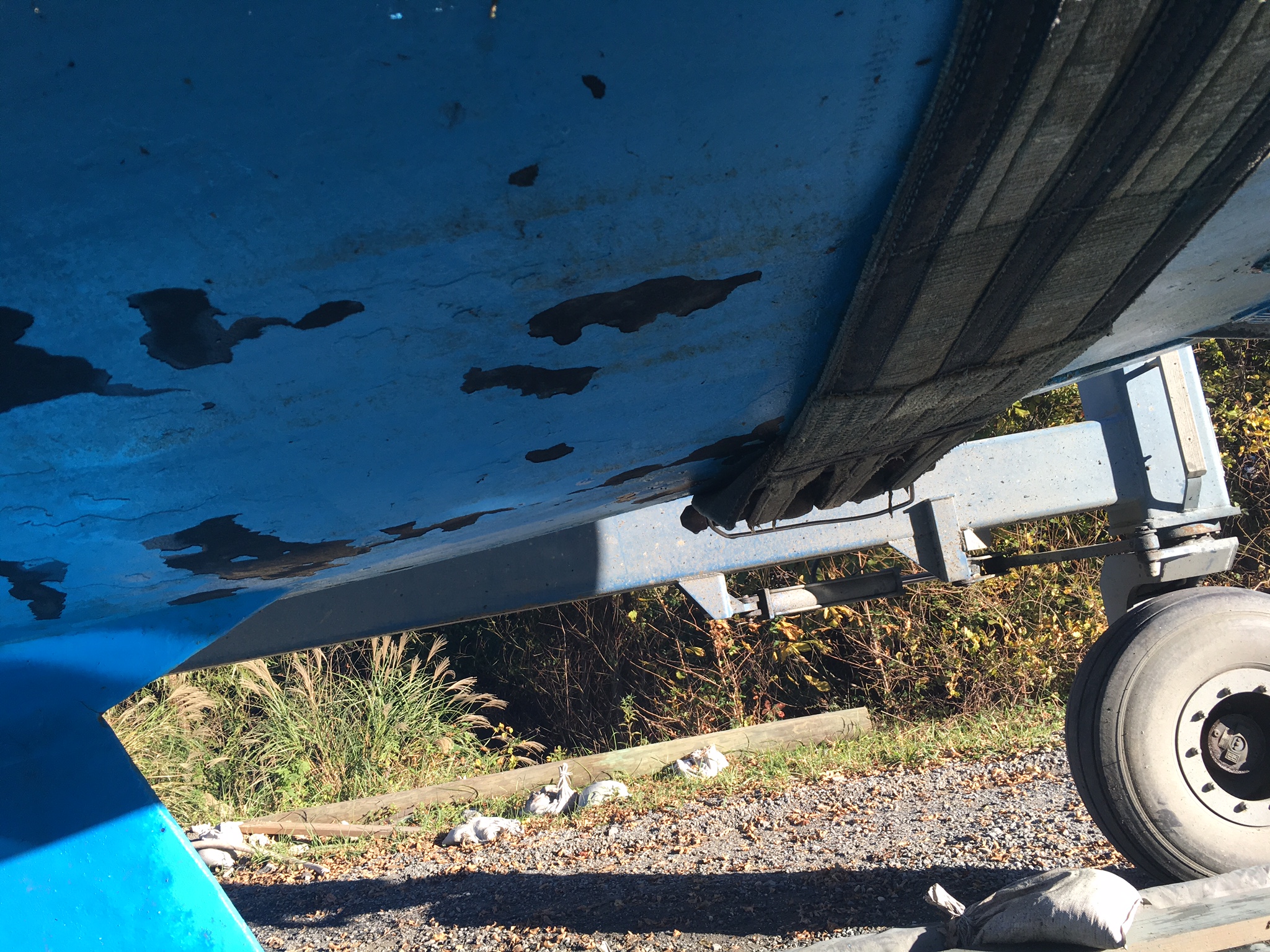

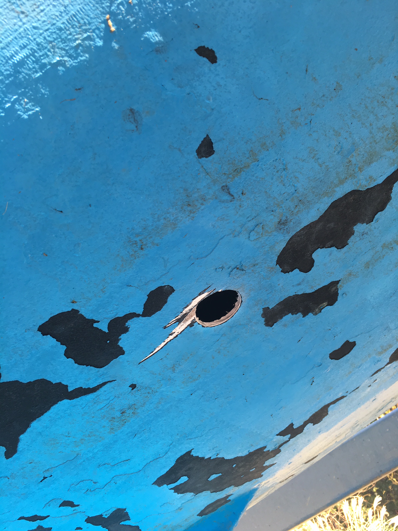

I have an 88 Hunter 30, and have it hauled out every other winter for storage and maintenance. During the haul last Monday, the marina guys noticed a large indentation under in the fiberglass under the shower pan area. I don't see any indication of the area hitting an underwater object, and it's on the bottom of the boat, far from where any jackstands might have been the last time it was hauled. If you pound your fist on the glass in that area, it sounds noticeably more hollow, and flexes a bit compared to the areas around it. We used a hole saw to cut into it, and the fiberglass around it is dry, not cored, and not delaminating. The total area is dented is around 3ft by 2ft.

The inspection camera is a great idea. I'll be ordering that today. Above are a couple of Picts.. The dent is easier to see in person. You can't see much through the hole, but the camera will really help.
