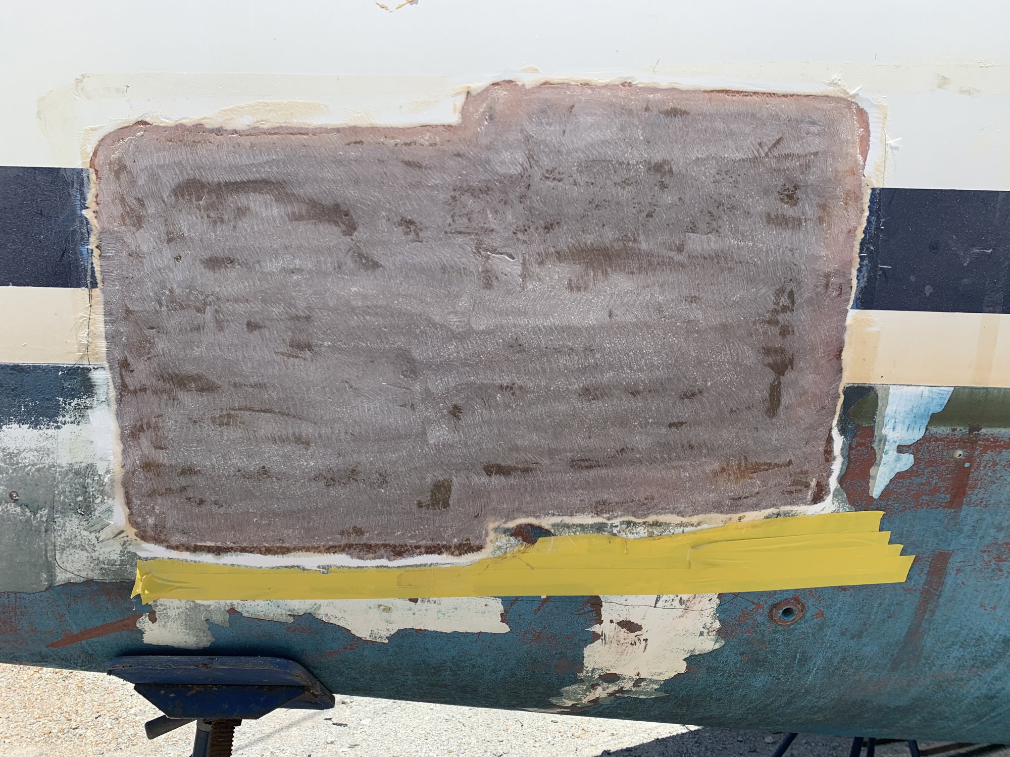

Exactly, they rounded the corners, no longer square. Why not cut rounded corners in the first place, I would. That way you don't have to make a larger hole.

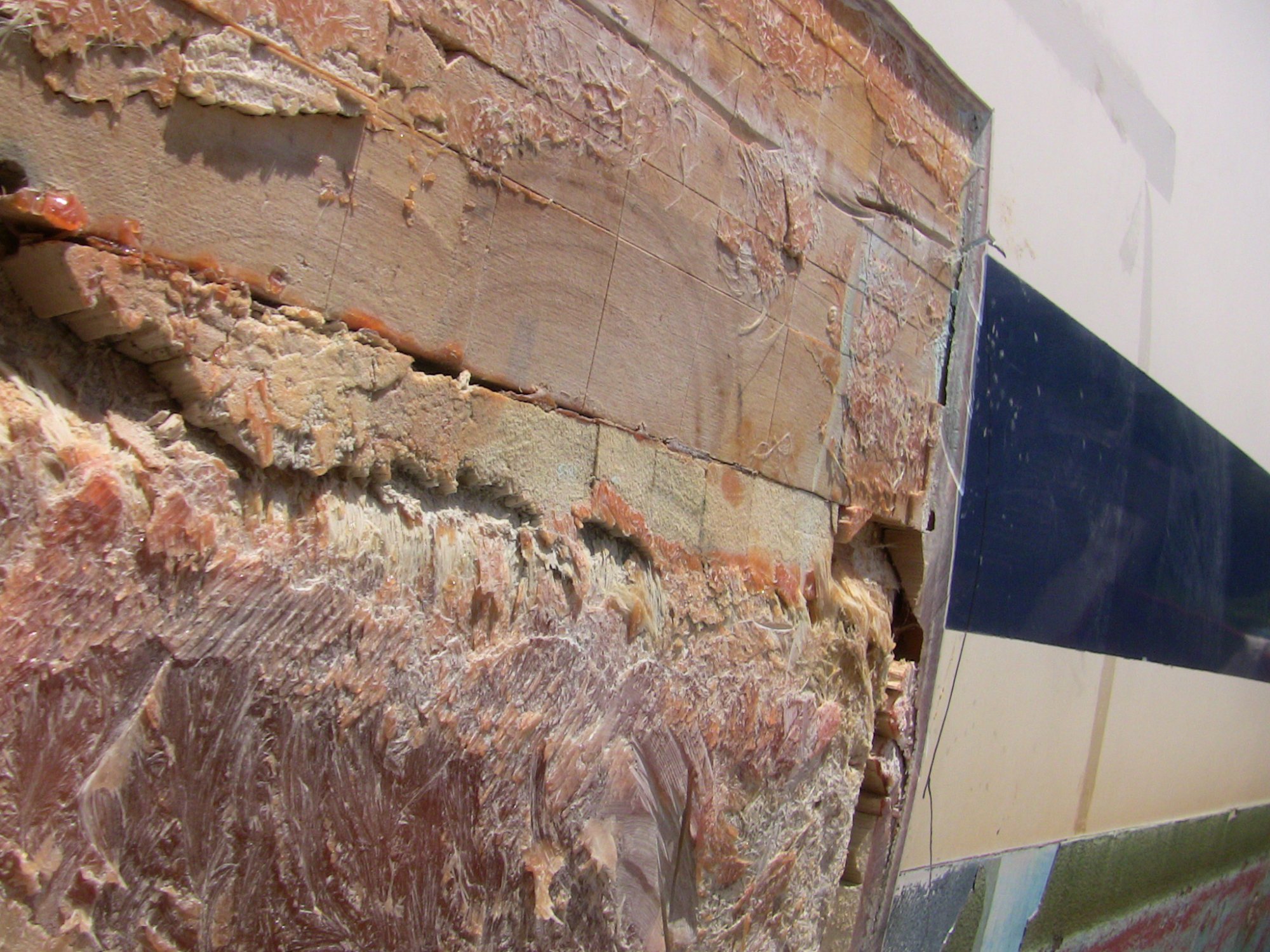

Do you have any photos of the prep done to the opening before they glassed in the patch?
No.
But I know what they did.
Note the Yellow tape in my 2nd Photo above.
The FRP expert used 4 strips. That is his way of remembering the Layering he did.
1) His first layer used Coosa Board , then cure.
2) Next layer then cure.
3) Same thing
4) Longest and Thickest.
The first cut out was done from this damage picture and FRP expert did not know what was beneath the outer hull.
Similar to a surgeons cut with out X-Rays.
You may see the temporary patch screw holes in the corners and the foam SeaTow put on to seal it. But there were no leaks inside.
In my opinion , after the fact, we cut too large of a cut, but we did not know at that time.
Jim...

Sure, you might cut a square hole for expedience if you know you're going to be cutting a larger hole later. In the OP's case, they could see the deflection from the outside and knew its dimensions, so would've have been much more prudent to cut the hole assuming it would be the only one needed. The square hole guarantees you're cutting twice. Also, they over-ran the corner with the saw, not a sign of competence. I would assume the dent was oval/circular in shape, a square just doesn't make sense.
