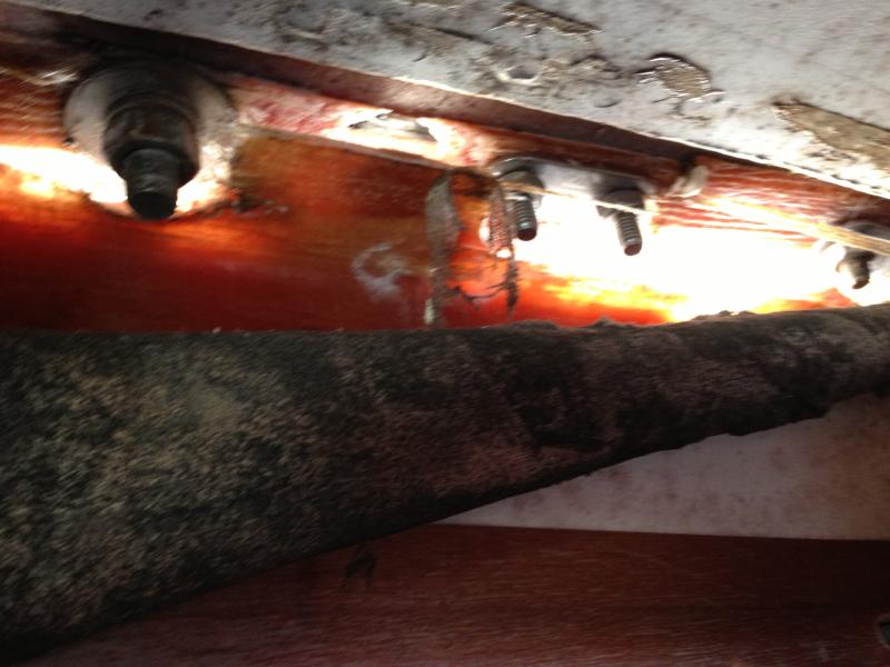

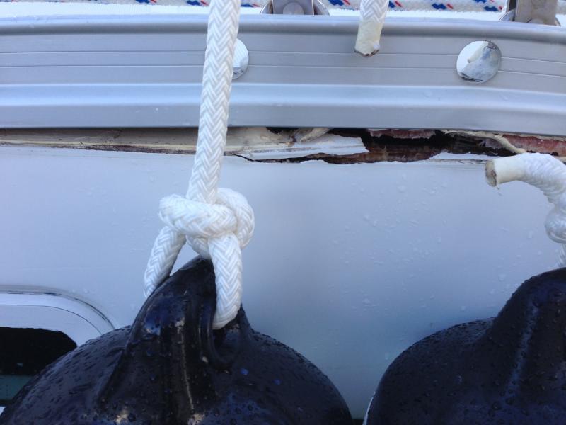

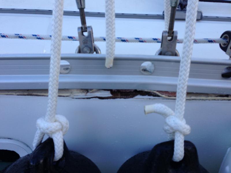

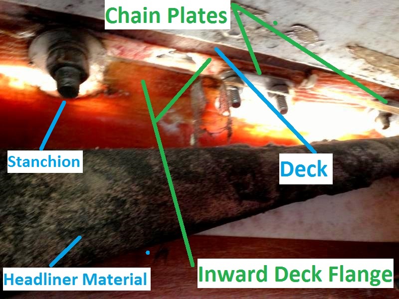

I have attached three pictures which illustrate the extent of the damage caused to the deck and hull. The damaged chainplates for the upper and lower shrouds are attached to bulkheads. Also, I don't have the rigging history on this boat yet, but I will certainly ask the previous owner. With respect to the mast, it wasn't down when I purchased the boat. Lastly, I did commission a survey inspection prior to the purchase, which BTW passed with flying colors. Thank you for the kind advice.

I responded to the other thread in add all sailors already but I think the description above and your interior picture posted above demonstrates my thought that the boat wasn't built to Beneaeau standards.

My armchair tells me someone removed the structural struts in order to renovate the interior and failed to reinstall them. Go after the surveyor who should have caught this.

Not only does there not appear to be a bulkhead, there does not appear to be any stay/chainplate ties to the hull.
I get the feeling this is not as it came from the factory? Beneteau has a good reputation as much as I have read, just cant imagine this is how it was made. Also cant imagine a surveyor wouldnt have seen this, but they cant see everything?

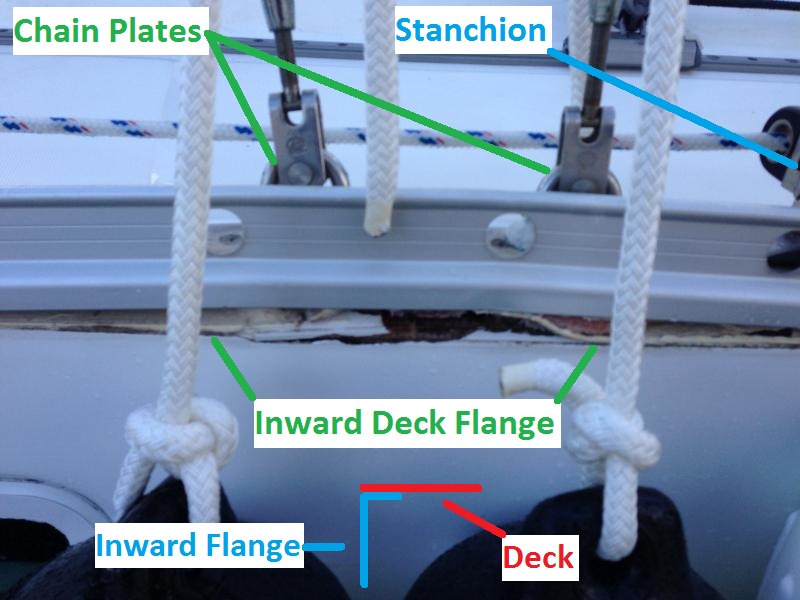

This is what I see from the images posted. If you have more images with better detail please post them.
INSIDE:
OUTSIDE:
It appears to me that the inward flange on the hull is potentially thin when compared to the washer holding the stanchion (probably a thick washer for the loads). Part of the flange is stuck to the deck and part of it stuck to the hull, so it split in two/delaminated. It is a little tough to get a feel for thickness from the images..
Still, from the pictures, I can't see any signs of reinforcement of that area, as in a thicker glass layup or ways to "distribute" the loads imparted by the chain plates to the hull flange & hull..
The actual chain plate backing plates are also VERY, VERY small to hold up a spar on a 31 footer without any "struts" helping to take the loads off the deck. I would expect to see that chain plate design on a small day sailor but not on larger cruising boat?
I can't imagine this is the way it left the factory? Someone please tell me it did not leave that way.... :doh: Perhaps another Beneteau 311 owner, who is concerned about these images, will open up access to his chain plates and post some photos??

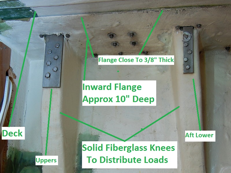

Here's a 36' fin keel sloop for the sake of comparison..
Not saying the Beneteau needs to be built to this level, but it is how some builders/designers deal with these loads... In the past I have been very impressed with the Beneteau chain plate designs, especially on the First series of boats.

That construction is unlike any I've seen in a Beneteau.. Our 3 Firsts have had SS rods that tie the deck fitting to the structural grid. Our first 260 (with 400 sqr ft of sail) has outboard shrouds like yours and they terminate with this fitting on the hull. Inside the hull is double thickness down to the grid. I hope you get this sorted, keep us informed.
