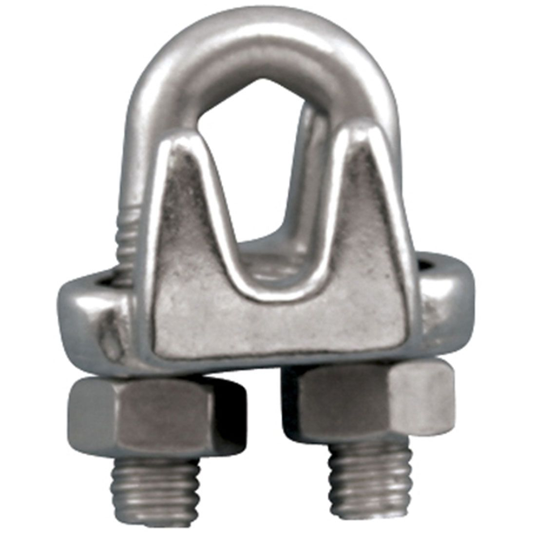

Sounds like you will be going with dynema but if you decide to build your own in the future, the most expensive part of the operation will be the swaging tool. And as mentioned, aluminum on SS is not a great choice. For the loads you are considering, a good alternative would be to use SS cable (inexpensive) and SS cable nuts like these...
I keep some of these and some extra cable in my box of emergency parts.
