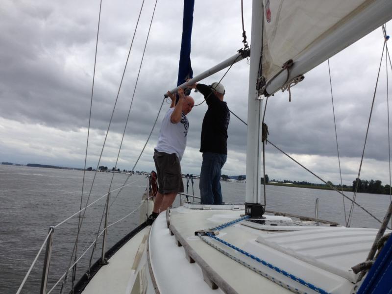

Whisker Pole Rigged
Ok, so thank goodness someone snapped a pic of me trying to figure this out. I did realized quickly the mast led line or lift line was attached to the mast end of the whisker pole and I reattached it to the extending end of the pole. I then adjusted it so it was level to the deck. The mast end of the pole is jaws down on a big eye bolt or U bolt. The telescoping end jaws down on the furler sheet that I was trying to pull out. I know it is not the best pic, but hope it helps.

Review of connections . . .
The line from the mast goes onto the pole at the extended end to support the pole. The pole is clipped onto working sheet (the one you'll pull to unroll the jib) The lazy sheet must be loose (this could have been causing the bind-up) and the furling line must be loose to allow the sail to unfurl (this could be a cause as well).

Thanks Clark, all those were done. I know the picture shows the line from the mast on the mast end of the whisker pole, but I realized and changed that right away. So at this point sounds like it was set up right, but something else is wrong. It really felt like the pole was to long even when collapsed all the way.
