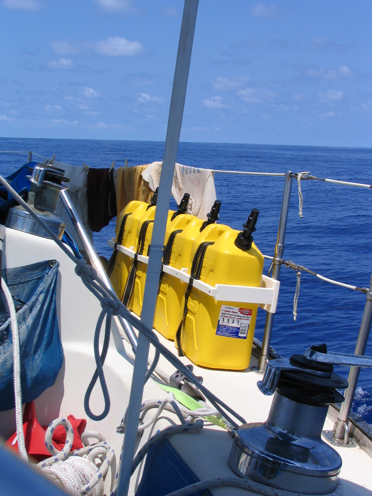

I carried four 5-gal jerry cans on deck when I brought my boat up from Ft. Lauderdale. They were in a custom holder made of starboard.

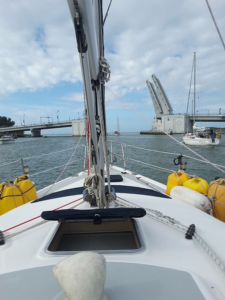

We do 2-3 week cruising trips every year here in SW Fl. and always take extra water jugs Diesel jugs and extra outboard gas strapped on my deck and no way I would carry any kind of fuel in a locker or down below.
Once had a gas can on back stern leak into a locker and traveled down into the bilge and the odor was so bad my wife wanted to end the trip and go home,she could not sleep and it took a week to get the odor to stop.
Your boat do what you think is OK but I don't know anyone that carries fuel in a locker or even worst down in the Cabin,I am sorry but that is crazy.
