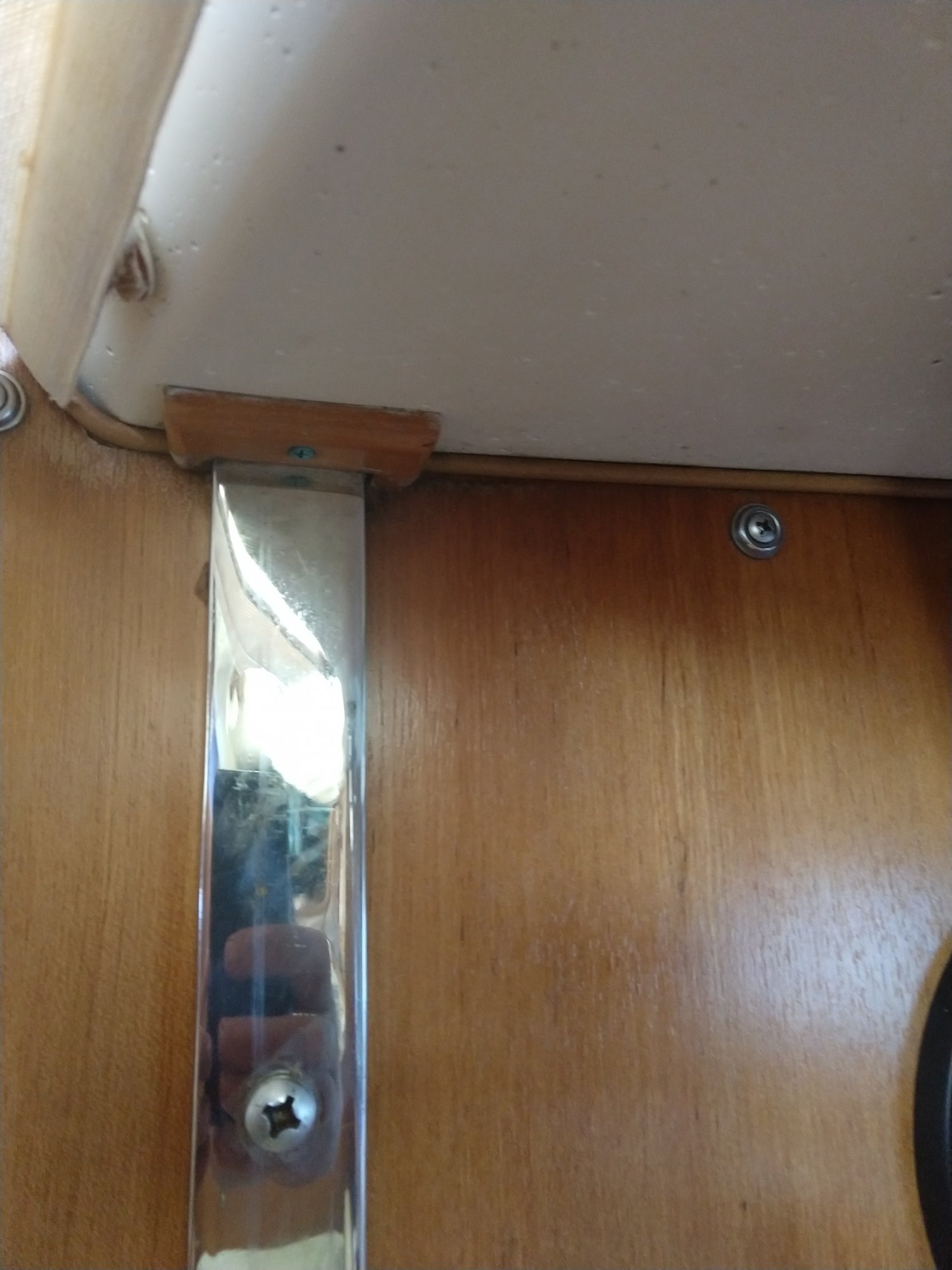

That little piece of wood is an interesting detail. Otherwise, it looks pretty straight forward.

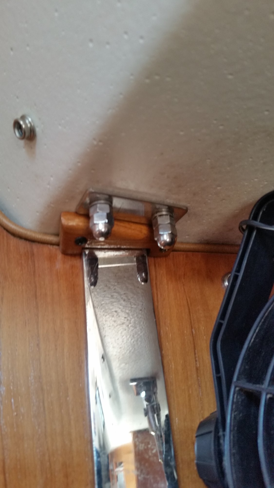

We are tackling removal, inspection and rebedding this week. What's interesting is that your cover is through bolted. On our 2001 the cover is held down with screws. I was thinking of through bolting them. Do you have pics on the other side of the bulk head?

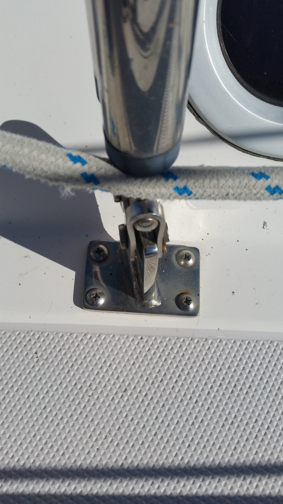

Thankfully I have the new style chain plates. I owe you guys two more pictures, one of the chain plate from the forward side of the bulkhead and the other from topside (I think that other picture was one of the stays). The part I am scratching my head about is that there are no bolts visible on the forward side underneath, but there are clearly 4 screws on the topside part.
I did just read Curt's post about re-bedding and I have pretty much the same set up. I was hoping to be able to do this quick and dirty while the mast is up, but if I have to pull everything I may need to re-think this. It also appears the two after screws are bolted down below and my big question was about the forward pair of screws as I cannot see anything forward of the bulkhead. I am wondering if they are just screwed into the deck.

That top down picture is definitely the cap shroud chainplate and what is connected to the bulkhead below. That would lead me to think that Catalina used screws on the forward part of the plate if you don't have bolts coming through in the vee berth.

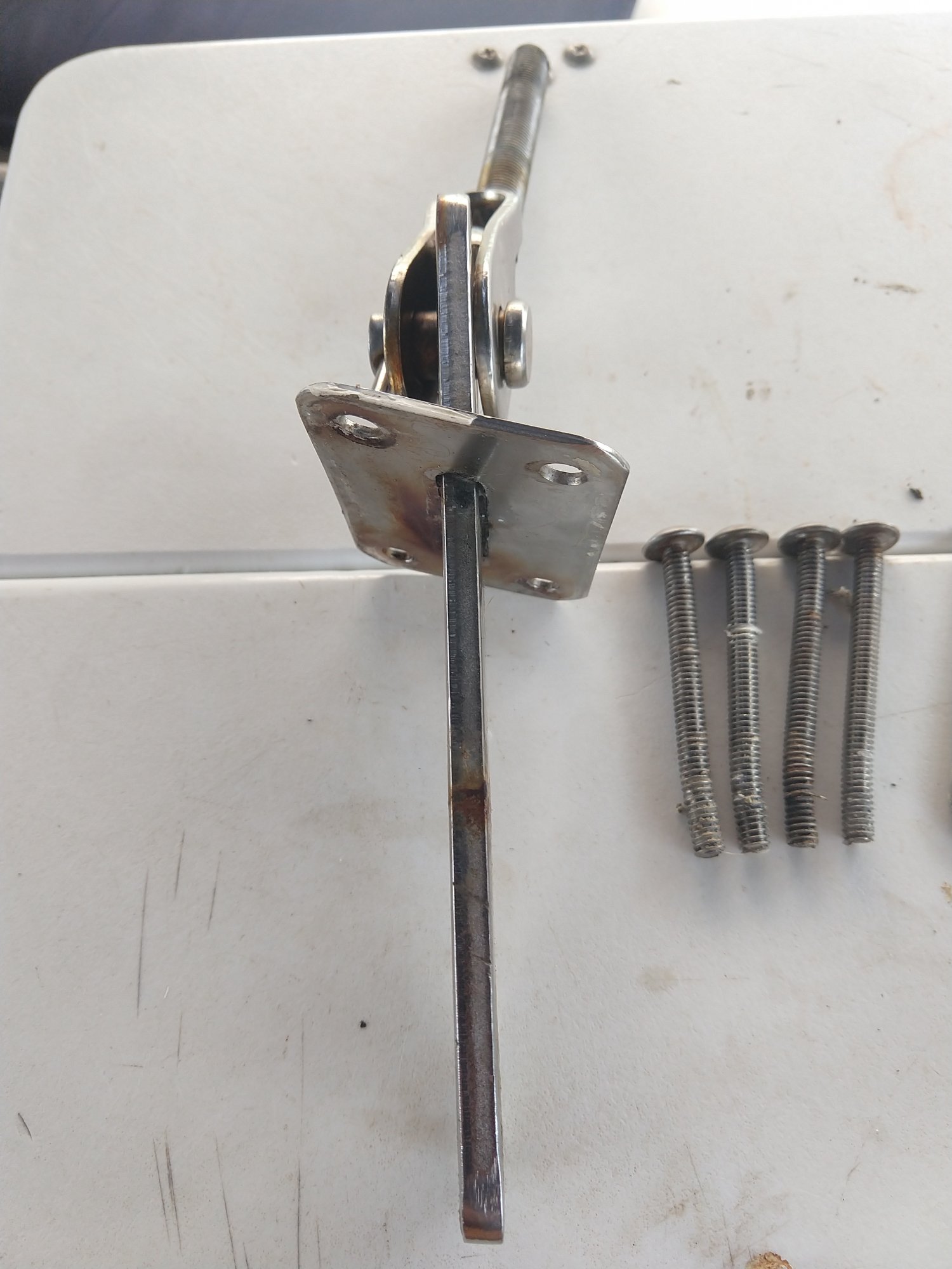

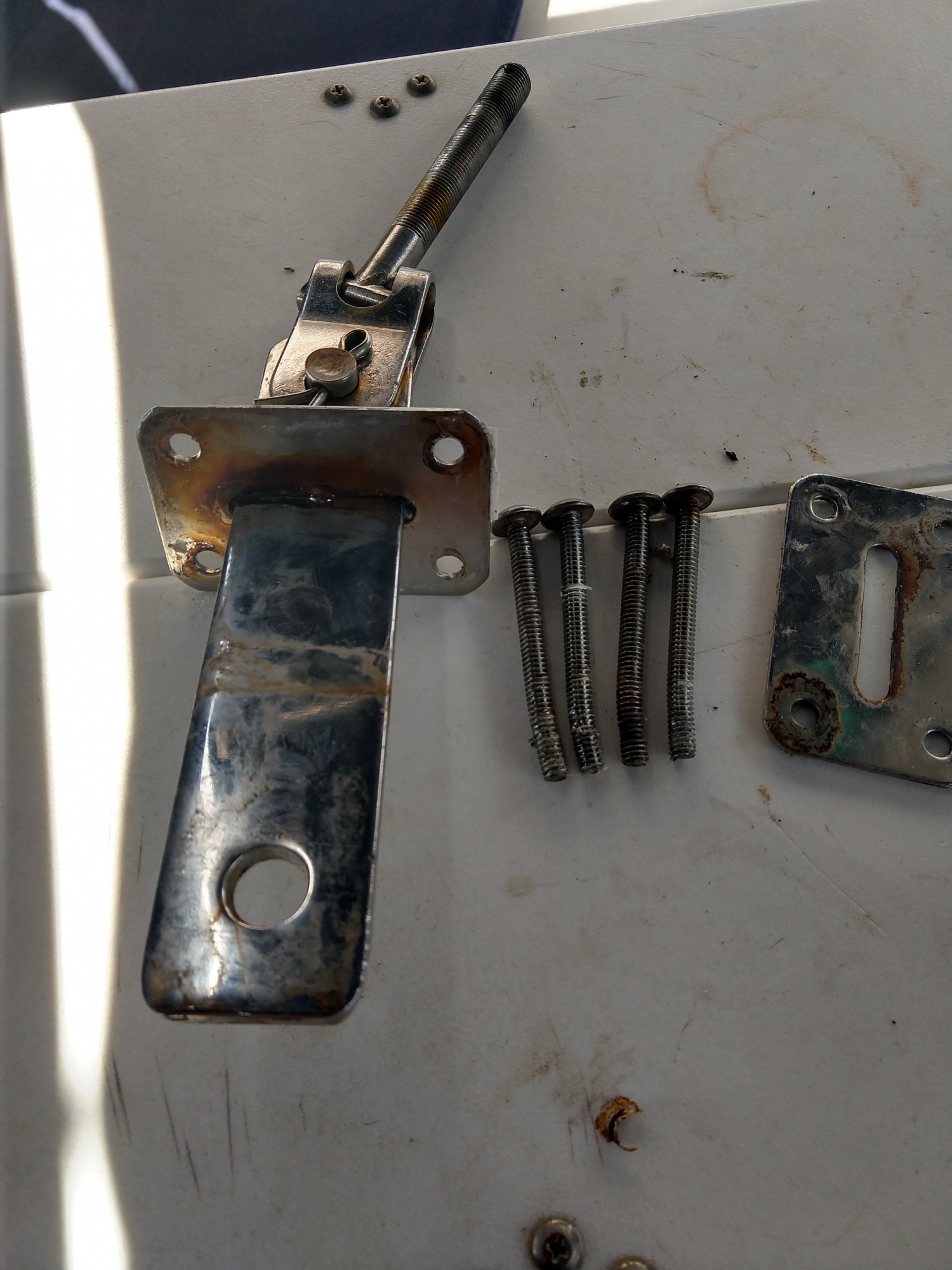

First of the shroud chainplates out. This is the starboard aft lower.

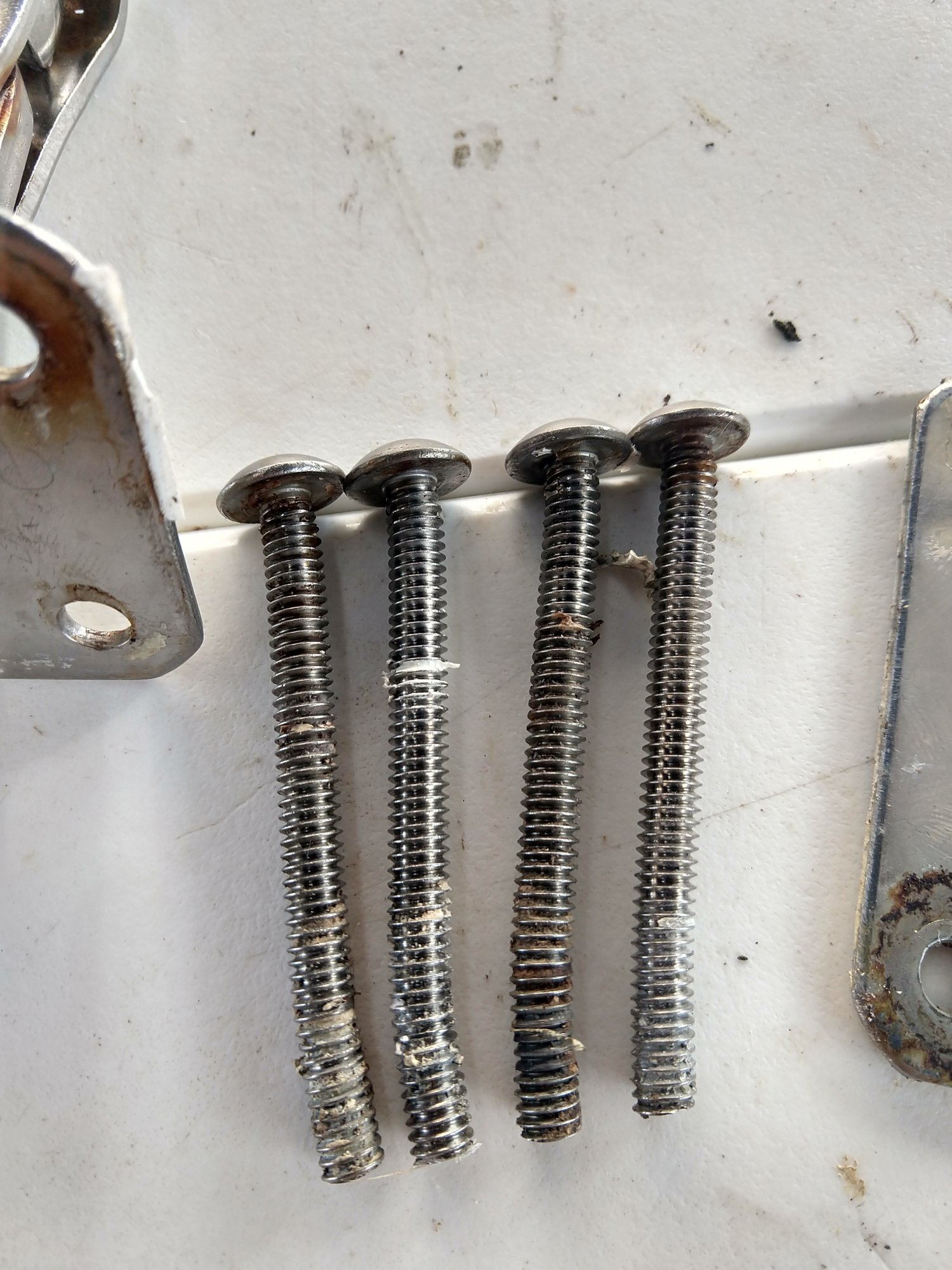

Take a closer look at the bolts.
That is some serious "S" curves. All we can figure is this was caused by Hurricane Maria. The chainplate is perfectly straight.
I will be curious what the rest of you find when you get into your chain plates.
These are 1/4" machine screws 2 3/4" in length. Of course no one makes 2 3/4" screws that are readily available. So you have to get 3" and cut them. I picked up a stock of 2" and 3" in Saint Maarten because I knew resources are limited in Bequia. So far these two sizes have been long enough for everything but the helm station. If you want to change from screws to through bolts at the helm station you need 3 1/2 inch screws.
