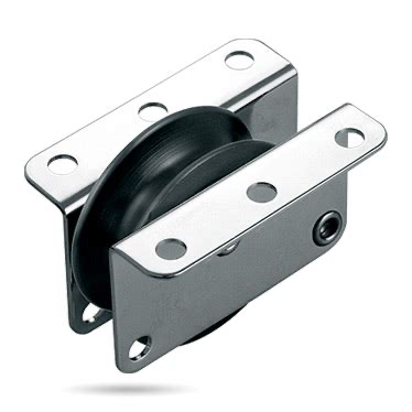

You can remove the lower sheave exit box by drilling out the rivets. Then reach in and grab the line. Once the line is fed through the sheave box, reinstall the box. Usually 2-4 rivets and your done.
Here is an example of a Ronstan Sheave box. This one uses 6 rivets or threaded screws to install.
