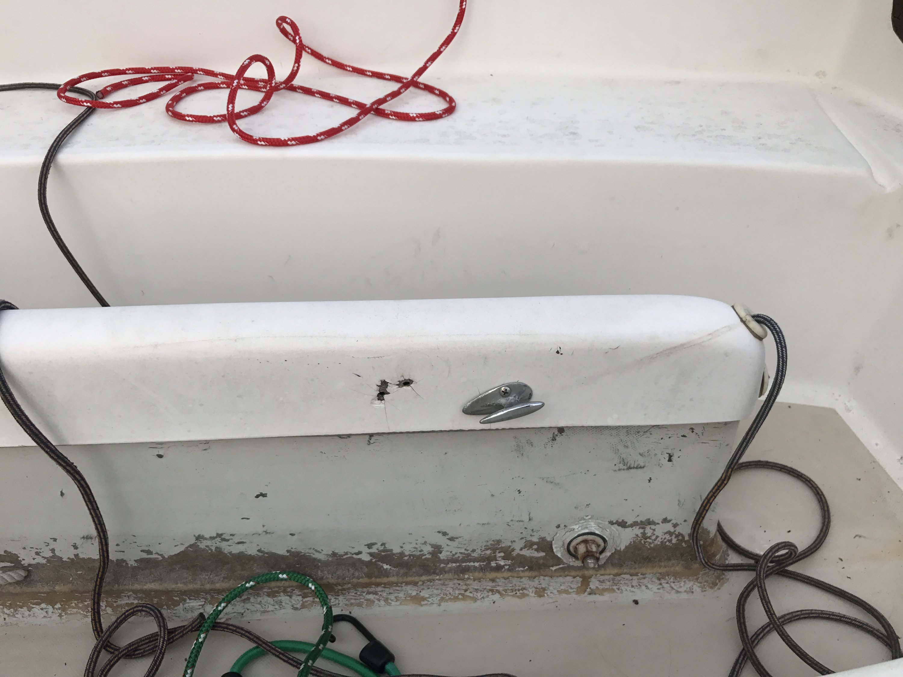

Sunbird, I'm getting ready to re-install the CB line cleat, and eye strap. I am also going to install a fair lead to guide the CB line per the diagram in the owner's manual. Do you know a recommended method for screwing these parts onto the CB chest? There isn't enough room to use nuts on the inside of the CB chest top. Worst case is stainless plate with tapped holes that match the hardware patterns but that seems a lot.
Photos below are (a) the CB trunk repairs needed and (b) our boat and my son before our initial shakedown cruise.

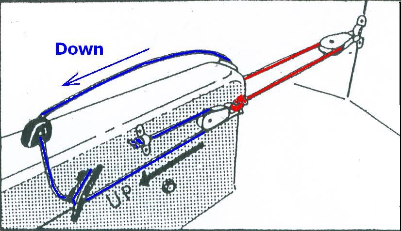

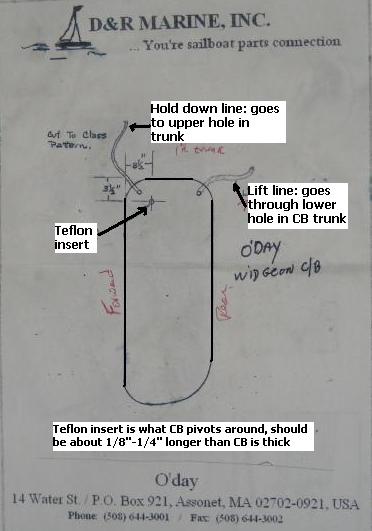

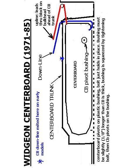

The Centerboard cap is bonded to the top of the Cb trunk/case and is decrative (In a way) if you were to remove it (destroying it and the top of the cb trunk in the process) you will find that it covers the molded top of the trunk, in other words........ won't allow access to the CB anyway. Removing the pivot bolt and then dropping CB out is best and only way to access the CB and control lines. Might need to remove boat from trailer for access, but not a real tough job! I just did this on my 1979 DS II a couple of weeks ago. Here are a couple of drawings/diagrams/pictures from my Expanded Owners Manual that may help. One thing to watch out for, the CB actually pivots on a plastic bushing, not the bolt. That bushing is slightly longer than the CB is thick to allow it to stick out a bit on both sides of the CB so that when you tighten the pivot bolt, you are clamping the sides of the CB trunk against the bushing, not the CB, which allows the CB to freely pivot.
