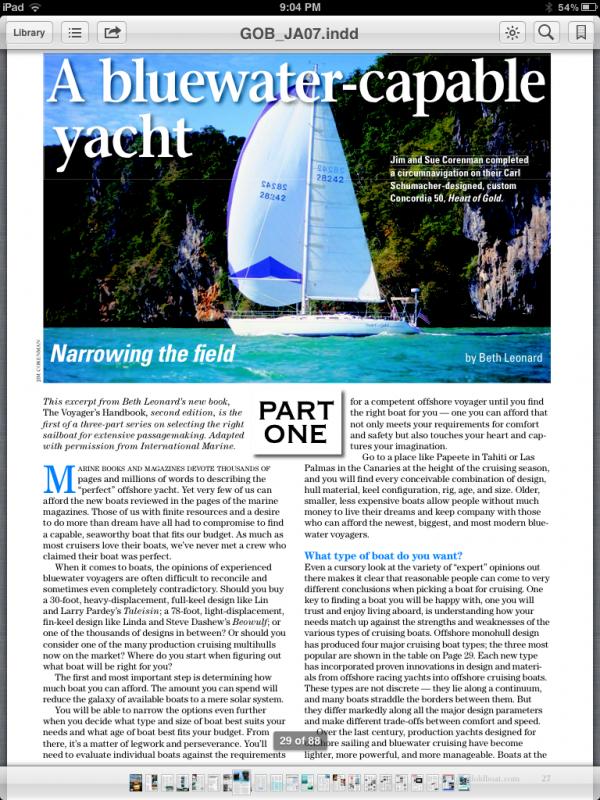

The picture below is the first page of a great three part article from the 2007 issues of "good old boat" magazine. It had a lot of good points. It addressed things I would never have thought of; the difference between anchor lockers for heavy seas vs coastal cruising, cockpit size versus drainage ability, etc. lots of good info there. You can download '"good old boat" past issues, or order them on CD.
