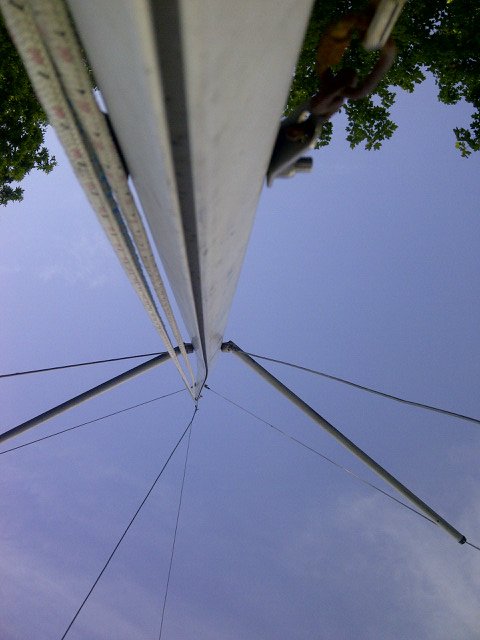

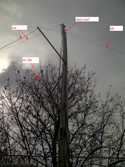

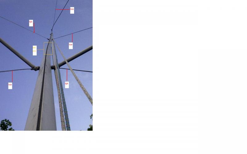

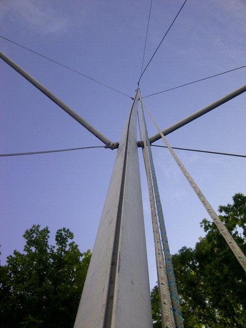

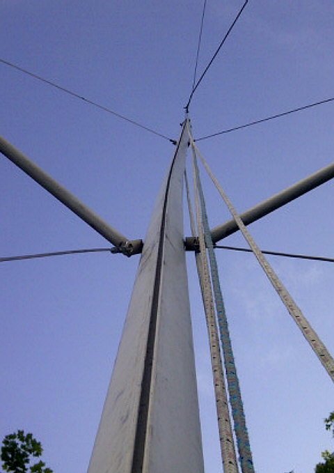

I was out racing tonight and got some pictures of my mast. It is bent toward port and seems to be raked way back above the spreaders. The gent I was sailing with thinks I should shy way from bending it between trees as I was planning. (Using the trees as anchors to gently pull against the bend with a come along.)
He thinks I should just use the shrouds. (I think they will pull through the deck!) Right now the upper on Port is tight. lower Port is loose.
Upper Starboard is loose and lower Starboard is tight.
There are no kinks or noticeable marks in the mast. There is a mark on the mast cap! I think someone backed into something with the mast while it was laying on the boat.
Any help is greatly appreciated.
Edit.. Back stay is very loose.

slacken the upper port and tighten the upper starboard. Read what you wrote and think about it.

He has a lateral bend just as you would get a fore/aft bend on a fractional rig. I bet that the lower portion of the mast is also bowed to the starboard.

I agree and would do this first, but if I'm seeing the photos right it is bent to starboard and that is where the slack lines are. If that is true then the mast is bent and not bent due to the shrouds.
Your boat and mine are a fractional rig and the bottom shrouds will straighten the mast, but....
.... I don't think they will in the area that appears to be bent. They should pull the mast fore/aft and side to side at the spreaders in a much longer more gentle bend between the deck and where the forestay/top shrouds attach. The bend I'm seeing seems to be pretty localized. The top shrouds are the main ones that oppose the forestay and are the main ones that will tension the forestay and will set the rake of the mast fore/aft. Just use the mast raising equipment or whatever you do to pin the forestay and unpin it and the situation will be apparent in a couple minutes of work.

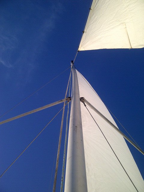

The mast was bent when I got it in November. The PO said he got it that way. (I believe him.) I'm taking the advice of someone that said to go sail it and see if the bend matters to sailing etc. (I'm not sure it does or not. I've had a couple of guys out and sail with me and the most experienced one thinks it is a good idea to straiten it because of stress loads on the shrouds being so different.)
So, I was playing with the rigging just before I launched it and have straitened it to what it is in the pictures. That means it has more of a bend when not under load from the stays.
If I pull on the Starboard lower and the Port upper while in front of the mast it gets allot straighter. I have to really pull.
I'm going to haul it tomorrow and drill some holes to mount a fish finder/water temp thing and may as well drop the mast and try and adjust it again. This time I will tighten everything and the other loose shrouds and for stay. I'll have a guy to help so it won't be a big deal if we raise the mast 3 or 4 times.
