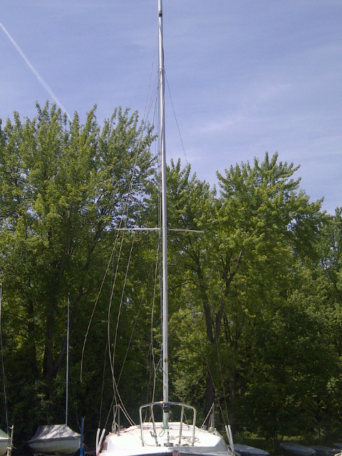

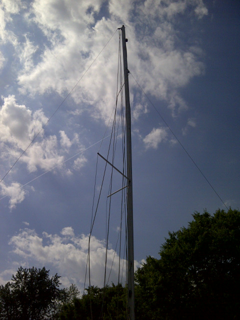

I had a very productive day. I had a hand today and pulled the boat out and dropped the mast and straitened it between 2 wood posts. (Sounds simple...it really was.) Gentle bends and about 30 min and it was ready to put back on.
My first idea of between 2 trees and a come-along wouldn't work with the way it was bent and the shape of the mast. (It would kind of twist around when we put pressure on it.) So we went to 2, 8x8 posts about 7' apart that keep cars off the grass and went really gently and slow.

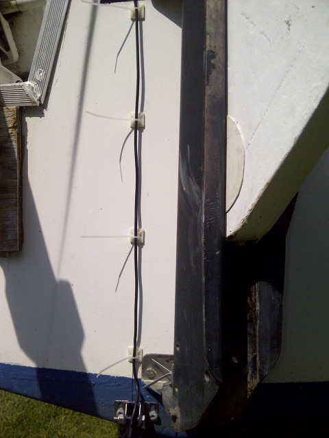

I got the transducer mounted and wire run to the fish finder as well. Built a prototype swing out arm to hold the fish finder in the companionway and fold in to the cabin.

In the pictures the mast is not tuned. All the stays and shrouds are loose. I'm going to ask around the club for a louse gauge. (There's probably one in the sailing school/boat leasing building.)

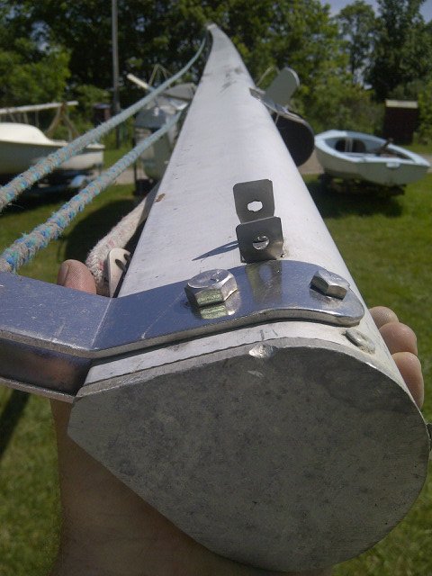

The picture of the mast in my hand shows a mark/dent/scratch on the top of the mast.
Last picture is the wire for the transducer and the handy little sticky things that hold the zip ties. (princessauto.com)
