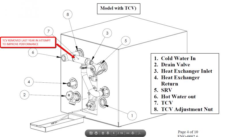

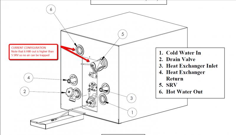

I have attached the FACTORY SCHEMATIC for the force10/Kuuma WH. Please note that the WH IS on a bypass circuit and NOT in the PRIMARY circuit. I confirmed with the Kuuma Tech rep that the bypass loop is how Kuuma prefers it to be plumbed because they do not want a restriction in the WH circuit to affect total engine cooling capacity.

I have no idea what you mean by horizontal and vertical layout but I will try adding some info to see if I can clarify. My WH came with a Temperature Control Valve (CTV) installed and I had always blamed it for the lack of performance. Last year I contacted the Kuuma tech department and they told me that the CTV’s have kind of gone out of fashion and I could remove it without causing any problem other than the potential for the water getting to scalding temperatures. Last year I removed it but got no performance increase. So you are correct, there is no temperature compensation control.
As far as vertical arrangement, as long as there is no air in the system (AIR LOCK), elevation does not mater from a fluid dynamic standpoint. The energy required to pump the water up is provided by the weight of the water coming down (basic siphon theory). http://en.wikipedia.org/wiki/Siphon The pump only provides flow, the lifting is done by siphon. Think of the siphons in the California aqueduct that take entire rivers over the coastal mountains. The fact that the RedDot produces plenty of heat with the coolant that is returning from the WH is proof that there is no air lock and the hot water is available.
Be that as It may, it does not pertain to my system. In my configuration the engine, the WH and the RedDot are all at about the same height. They are mounted under the settee and quarter berth.
