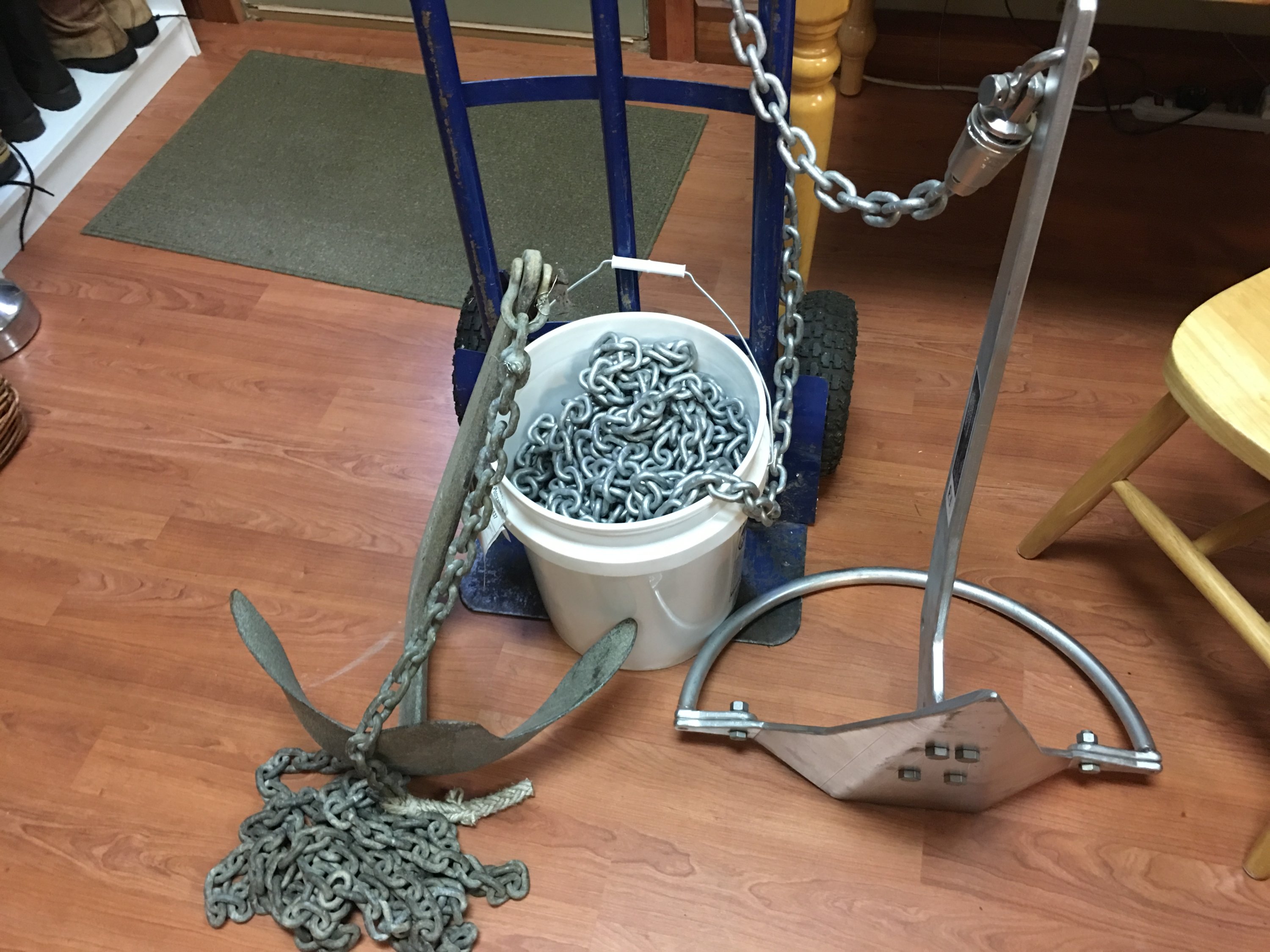

which do you think will let me sleep better 1) 33lb Bruce with 20’ of 5/16 or 2) 35lb Mantus with 120’ of 5/16 chain.

Mantus every time, in my experience. We changed form a Bruce to the Mantus last season and the difference has been remarkable

Either one,, but I'd use more chain on the Bruce. I've done nearly 12,000 cruising miles, and used a 22 pound Bruce clone on my 25 footer the entire time, no problems, even in some 65 MPH winds . I carry 75 feet of chain.

If you believe the published static anchor-holding tests, plus the field-use testimonials from folks on this forum, the hands-down consensus choice for holding power would be for the Mantus.

Based on many tests, the holding capacity (not power--that is for energy) of the Bruce in sand or mud is about 2-5 times less per pound than the Mantus. Hooking is different. The Bruce is probably light for soft mud.
I'd keep both.

Mantus every time, both for holding and quickness to reset if it should let go.

3) the anchor snubber for the all chain rode attached to the mantus.
actually there is 250' of 5/8 8-plait backing up the chain -- and a Mantus bridal + chain hook for when it is all chain. 60' of water at 6:1

Just curious... but did your Bruce fail often? Or did it just seem like the Mantus was more dug-in when your retrieved it?
My previous experience was with a CQR but the quick resets is a company quote, so i am not disparaging the Bruce but would never return to an old style anchor.

Leslie; unless you have a good spot to stow that Bruce I would unshackle it, sell it and get a second anchor you can pack away for that gawd awful day you lose your main anchor and need a plan B. In the mean time you have a kedge option. I like the alloy Fortress/Guardian anchors.
As with any tool, practice using it.
