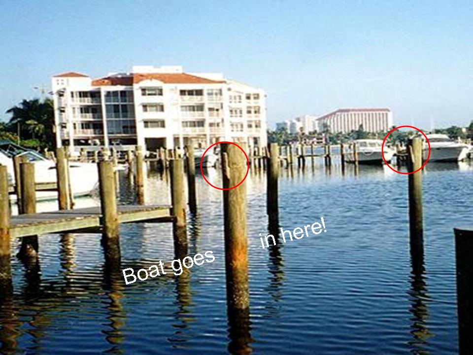

so now that the question has been answered of what a pelican pole is,, why would someone mount a cleat to the outside of one?.... or on a "pelican pole" at at all, unless someone needed cleat down a pelican at one time or another:confused:
the tides may be less in that area so that a cleat could be mounted onto a piling without hindering the movement of the rising dock on the tide, but it would seem that all but the dullest of anyone who even knew how to use a cleat, that they would mount it on the side of the piling so it would be out of the way....
the first thing I would do is move the cleat, and if that isnt enough, either modify the stanchions or find another slip....
its nice to have options;)

Well, the OP is in Lake Michigan, apparently. Nevertheless, I question whether or not we're talking about an actual cleat. The docking poles typically have a short, u-shaped wooden "arm" that juts out, and on to which one secures the outboard dock lines when leaving the "slip" so they do not reside in the water if they remain attached to the pole. Can also use 'em to help secure the boat when in the slip. But they don't usually face toward the boat. If the lake is really high, as she said, then the boat's stanchion might be catching those on its the lee side going out. Raise 'em higher if you can!
