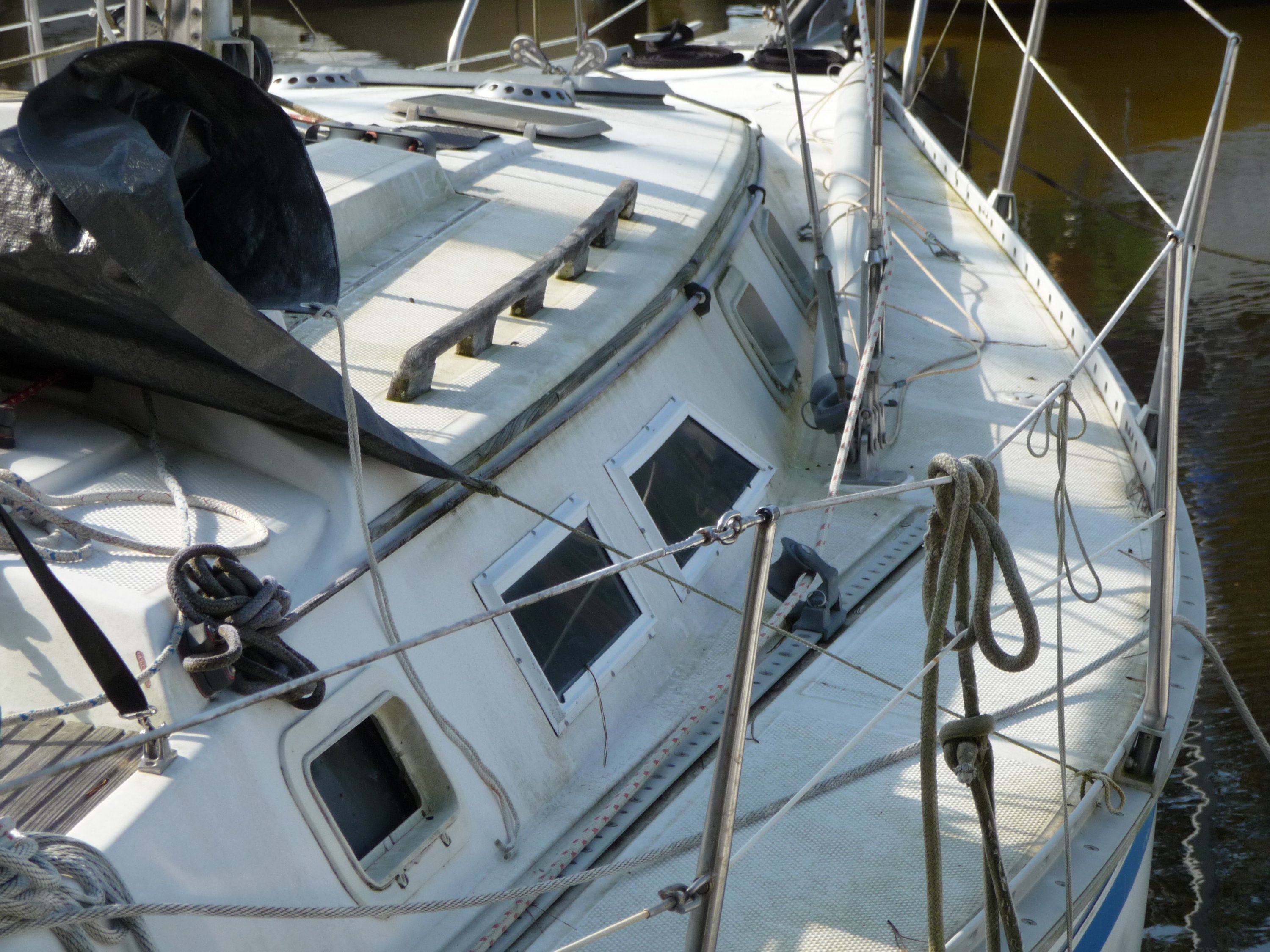

We have a 1986 Hunter 34. The top of the stanchions stick out about 2 1/2 inches wider than the hull. When there is a strong west wind (also compounded by our prop walk), we get blown into the pelican pole when leaving and coming into our slip. In the past, we just kind of rubbed and got past it. but now with Lake Michigan water levels about 2 feet higher, our stanchion at the beam gets caught on the cleat on the pelican pole. It bent it about 5 inches. We purchased a new one but are wondering what we can do to avoid this in the future. We don't want to also bend the new one. The cleat sticks out about 2 1/2 inches. We need something at least 5 inches between the boat hull and the pole to keep from getting caught.

Okaay.. The base of the stanchion is not horizontal. It is sloped with the deck, so the stanchion is not vertical.. it slopes outboard a couple of inches at top and as in this picture, it can easily catch on pilings etc and get bent just as mine is, damnit. You can see the second stanchion is vertical, the base of which shows the bending it got when it caught on a piling. you can see the ones forward of the bent one leaning outward a bit. It would take something about 8-10 inches in diameter, like a big bumper hanging horizontally, to stop them from catching.

I think the layout is understandable. Just not sure why a correctly positioned fender couldn't protect the boat from a cleat?

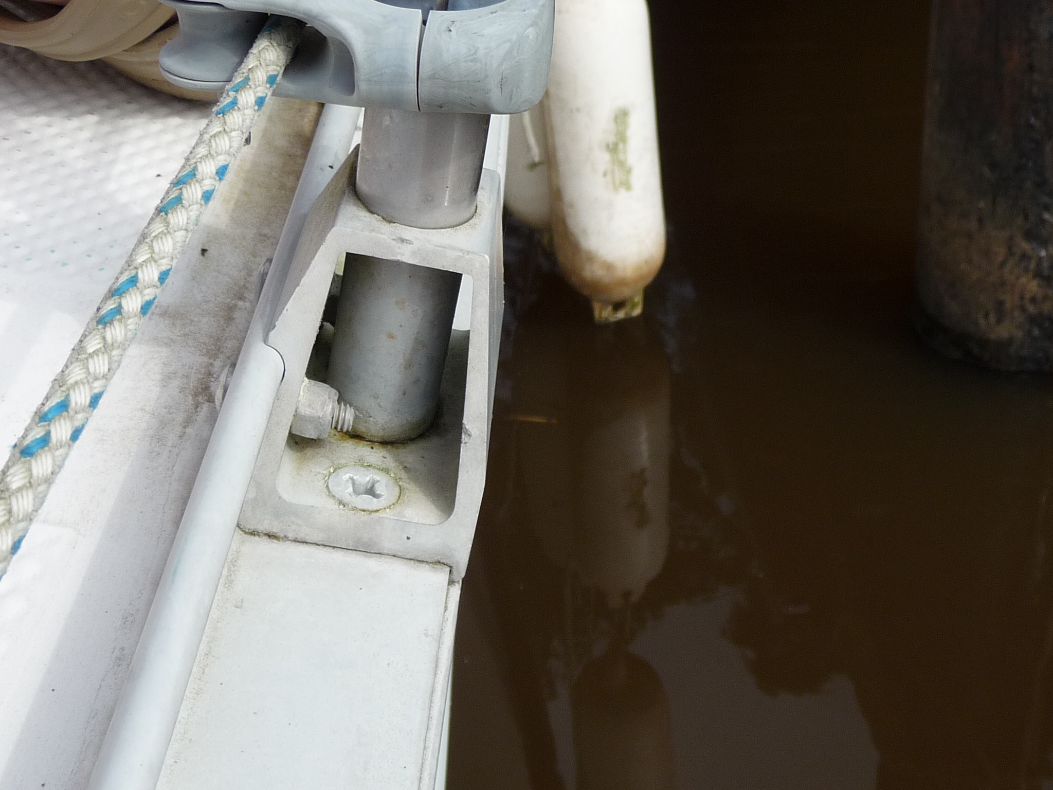

2 1/2" does seem like a lot. Often the stanchion bases are angled slightly so they point straight up or slightly inboard. Flat bases will angle out but usually not that far. Perhaps these are angled bases but some PO has turned them around the other way?
10,257
nope.. that is from Hunter.. It is actually very nice when using the deck when heeled over since the lifelines don't interfere with the limited deck space as much as a vertical one would. This is the base on the down-angled rub rail.
