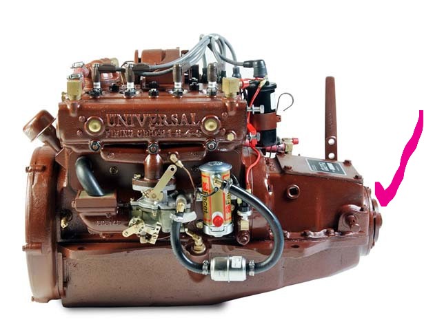

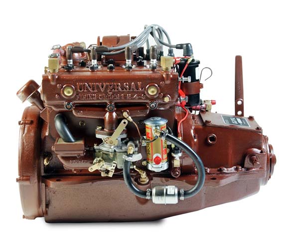

My engine is a direct drive atomic 4. This version does not have a transmission in the normal sense.View attachment 237209
Allegedly some had 1:1, some had 2.04. If you went from 1:1 to 2.04, that would explain it.

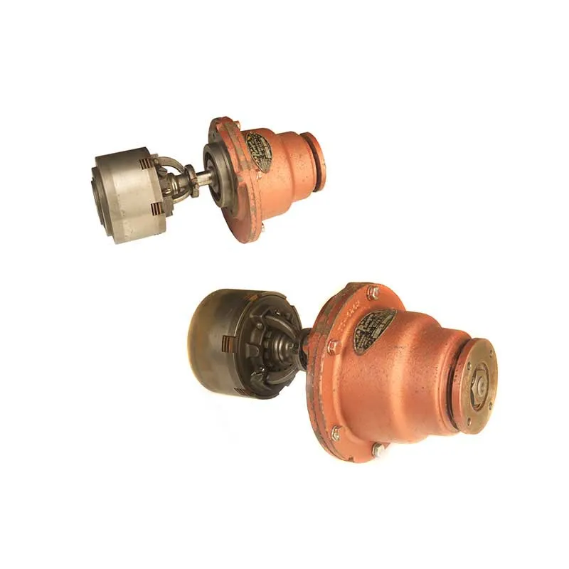

"Some models have 2:1 paragon reducing gear. All are lubricated by the same engine oil. 2:1 reducing gear is easy to spot as its bell shaped round, it sits behind the square reversing gear housing(the one with a shifting lever)"

This is a Paragon 2:1 reduction drive. This is substituted in the direct drive 1:1 engine at the output shaft.
My engine doesn't have a Paragon drive.
An Atomic 4 with a Paragon reduction gear would not fit in a Catalina 30.
