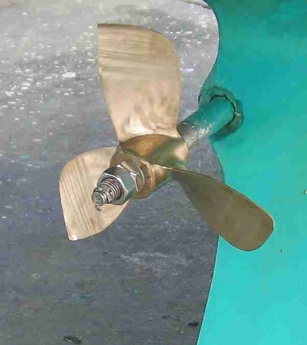

I have a 3-bladed Indigo aftermarket prop (see attached photo). As for your comment on the prop "up against the strut" Last summer's haul out the prop was "up against the strut" I "attempted" to position it where it should have been before the engine replacement. If it isn't, the prop can't be more than 2-3mm from it's intended location.

Where did you get the picture in post #11? Did you post it to just show the prop? It's not a C30.
I'm guessing that you installed a prop from another boat and it's not sized for your boat and engine. I did a little research and found the standard prop for a C30 with atomic 4 was 12" 7 pitch 2 blade that maxes out at 2100 rpm. One poster on the Moyer forum posted he installed an Indigo 10/8 2 blade and his max RPM is now 2600.
Since you're seeing 3000 rpm, most likely the prop size and blade pitch is not sized properly and not biting the water, despite being a 3 blade.
I'd suggest you go over to the Moyer Marine forum and do some searching over there. If you know the specs of your Indigo prop ask them if it is suitable.
Ward: I'm guessing that you installed a prop from another boat and it's not sized for your boat and engine. I did a little research and found the standard prop for a C30 with atomic 4 was 12" 7 pitch 2 blade that maxes out at 2100 rpm. One poster on the Moyer forum posted he installed an Indigo 10/8 2 blade and his max RPM is now 2600.

The picture from post #11 I grabbed from the Indigo website. It's NOT a picture of my boat just a sample picture of the "type" of prop I have.
