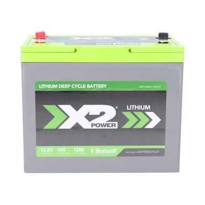

This is my battery of choice:
The great news is that it weighs in at less than 25 pounds. I use a 35 watt Battery Tender solar panel for which I got a LiFePO4 compatible controller on Amazon. My battery is always topped of and I don't point my panel, it just hangs vertically of the stern rail and all is good.
