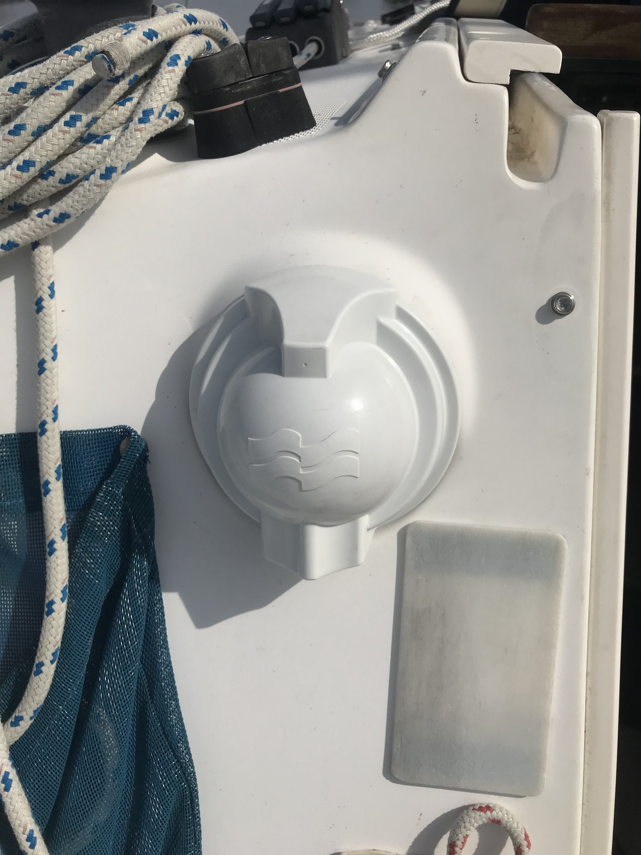

I think it's on backwards.
Shouldn't the side with the beer tap be on the outside? Otherwise, the cabin ceiling interferes with the tap pull.
- Will (Dragonfly)
Oh dang! You’re right!

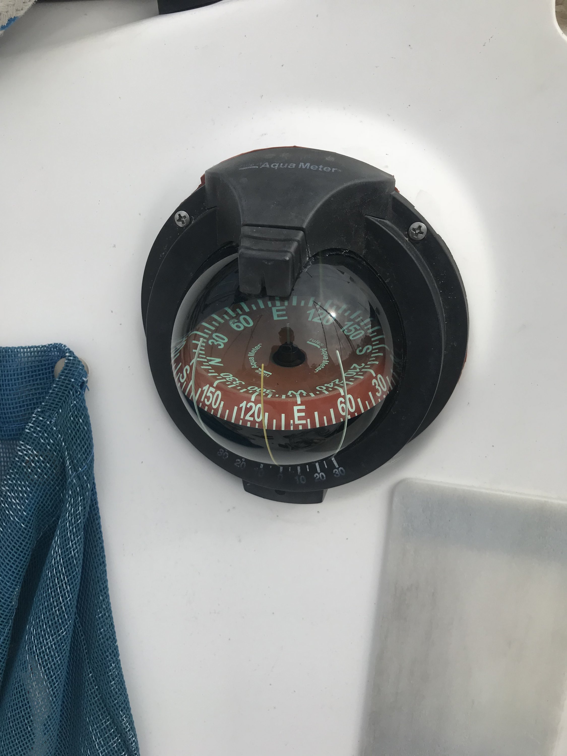

Well the RED kind doesn't exorcize the ghost seen in the center of your installed picture, but it will seal out the water.
Did you use a water hose to test your seal?
Jim...
PS: You can use a hot beer to test also.
Jim...
I didn’t test the seal. Don’t get me all paranoid! And isn’t that ghost handsome!!!
errr uhhhh well I ... errrr...
Dont get paranoid! Since I did verify you your compass works if... that was an ≈3-4pm picture in SC.:waycool:
Jim...
PS: I love being a detective.
Likes: Kermit
Jim...
Nope. 1:34 pm. I want my money back!

I have seen lots of discussion about how to dispose of old boats. The old compass ended up in the trash. Sorta sad really.

Have you swung the new compass? Want to make sure it reads right now that it is in your boat.
Our friend put his Bluetooth speaker real close to the backside of his compass. It read west when it was pointing north.
Nope.:snooty:
I guess you took at picture of the west setting sun's reflection at an angle, but the the body was still warm, your honor.:poke:
OR
You used a metal gasket!
Jim...
Likes: Kermit
Sam
I’ve never swung a compass. It seemed to be pointing the same direction as the old one and where everyone says north is at the club. Honestly, I’d rather have swung a beer tap.

Success!!! I bought a square sheet of rubber from Simpson’s Hardware and cut it to fit. Even the screw holes line up. Even the light works. Thanks for y’all’s help, y’all!
