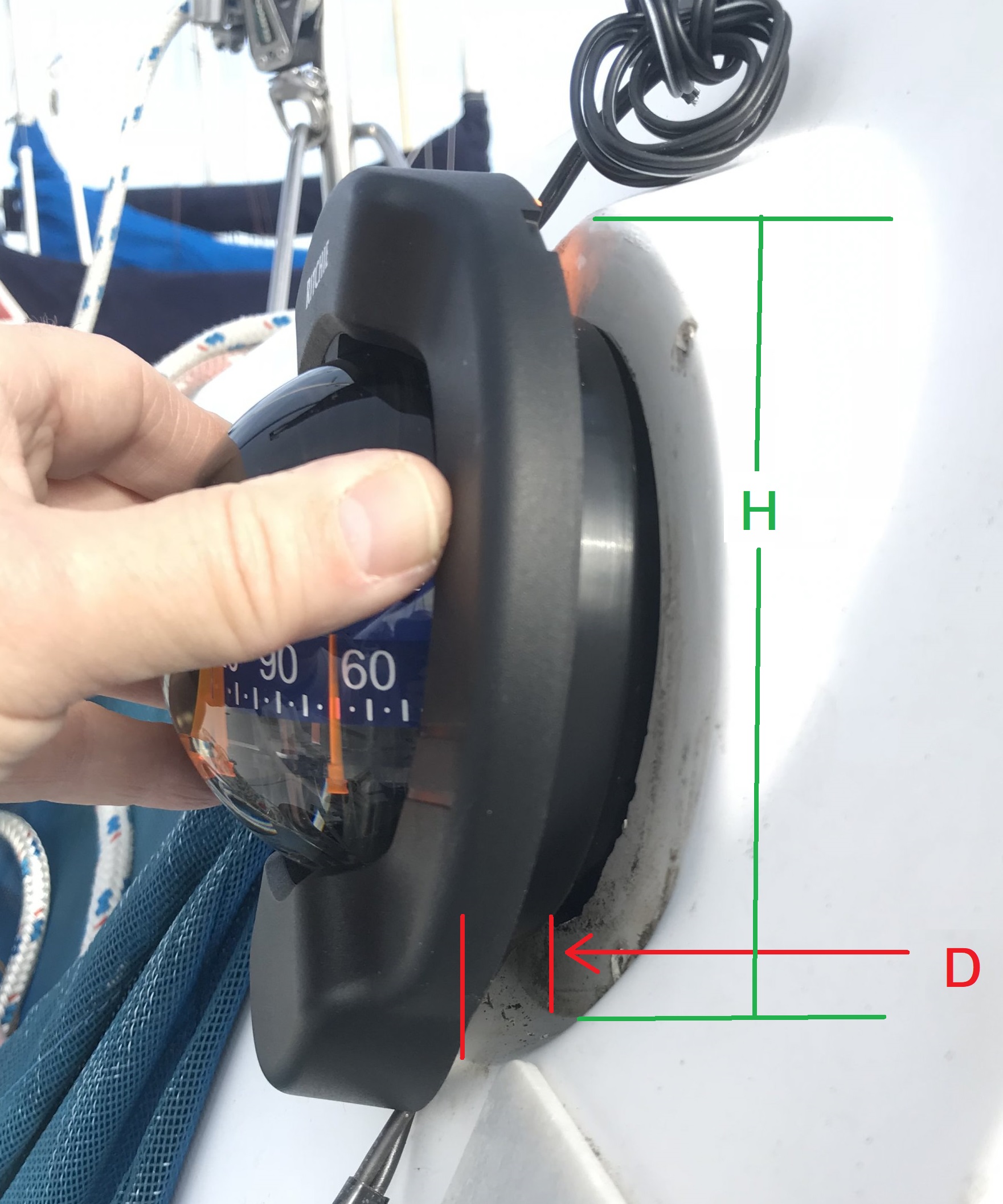

OK, y’all. Santa brought the Ritchie SR-2 but it won’t work. ARRRGGGG! Hunter thoughtfully supplied a circular vertical surface within the angled bulkhead complete with 12v wire for the light. But the Ritchie is too big for the vertical circle. I spoke with both of my favorite Daves today - Dave Groshong and Crazy Dave Condon. Neither has the answer but they both agree I have the wrong compass. I even talked to a lady at Ritchie. They have nothing that will fit. The current hole is too big for a smaller compass. I’m ready to install a beer tap but my wife is, to say the least, a bit skeptical.
Does anyone have any other suggestions?
I'm thinking that a bezel made out of polyethylene or nylon would be the way to go. If you buy the material & supply a sketch with dimensions, I'll machine it down for you.

Dang. Incredibly nice offer! I’ll send you a private message this morning.

I'll need a fairly accurate measurement on the height (Green H in the picture) for the flat part of the glass before the radial chamfers start & the depth (red D) from the flat glass to the outside of the radial chamfer on the sloped surface below it. It would be nice to also have a fairly close measurement on the diameter of the existing hole. I found the dimensions for the compass on the Ritchie website.

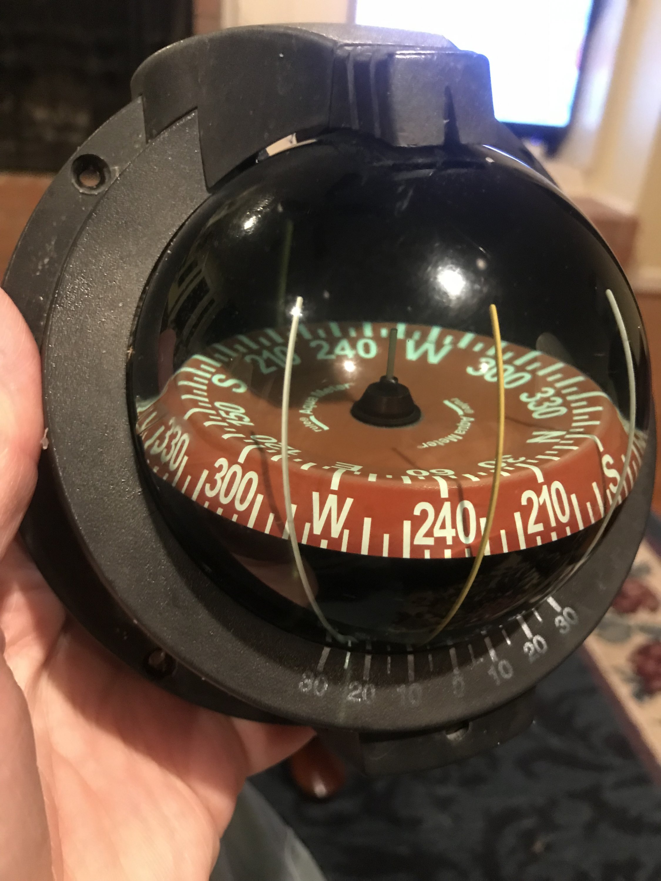

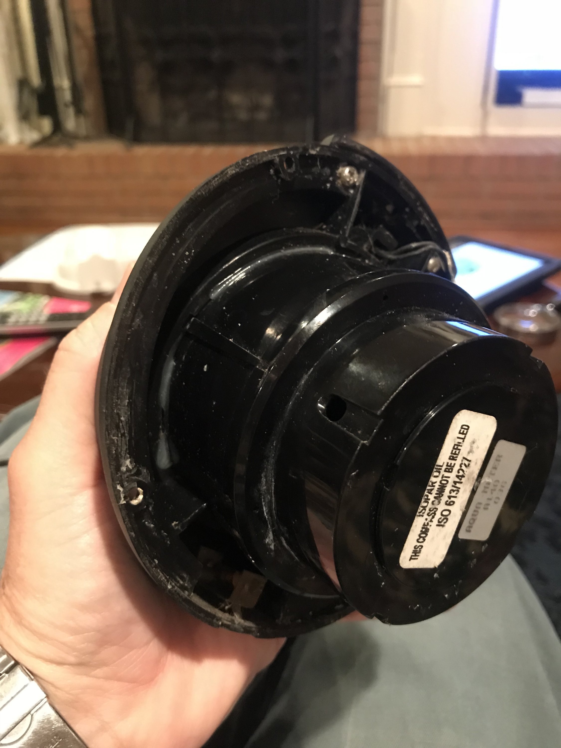

I just received my replacement compass today. (Beer tap not included.) I scraped a fair amount of silicon from the back of the collar. The Ritchie included a rubber gasket but this one’s obviously is not included. What do I use to seal it to the bulkhead that will be water tight but removeable? Thanks!

Do you know what kind of rubber? EDPM, Neoprene...?
Jim...

I may have misread your post. If you have no new gasket, then you probably need one from your picture. Raymarine Techs use a special bedding caulk to seal my MFD.
Jim...

PS: Auto Zone has a gasket kit and you can cut your own.

Not sure exactly what has to be done but if you need some sticky material behind the bezel where it sits against the cabin bulkhead, try butyl rubber - MaineSail sells it and the 2 rolls you have to buy will last forever. It doesn't glue, it just seals.

I was kinda wondering about butyl rubber. I’ll check into it. Basically I just need to keep water from seeping behind the hole. Thanks!

It is grey sticky stuff that comes on a roll, a band about 1/8 in thick and about an inch wide. It is sort of like a somewhat stickier version of silly putty. You can pull it off surfaces, and because it is not a liquid you can apply it to the back of your bezel, or the surface on which it'll go, and when you screw it in it compresses a bit to fill the gap. I use it a lot to seal chain plate covers, etc. If you countersink a screw hole slightly (try running the countersink bit in reverse so it doesn't bite too aggressively) to make sort of a channel around the screw entrance the rubber squeezes into that gap, making a pretty watertight seal. It isn't really great for an application where bolts or screws can't be used to mechanically attach the objects together - you need some "oomph" in the fastener to squeeze it down a bit.

Butyl Tape. Good stuff. Just used it to caulk an above the waterline thru-hull. Was used on my '77 Hunter to seal the hull to deck. Still pliable. You do need some
