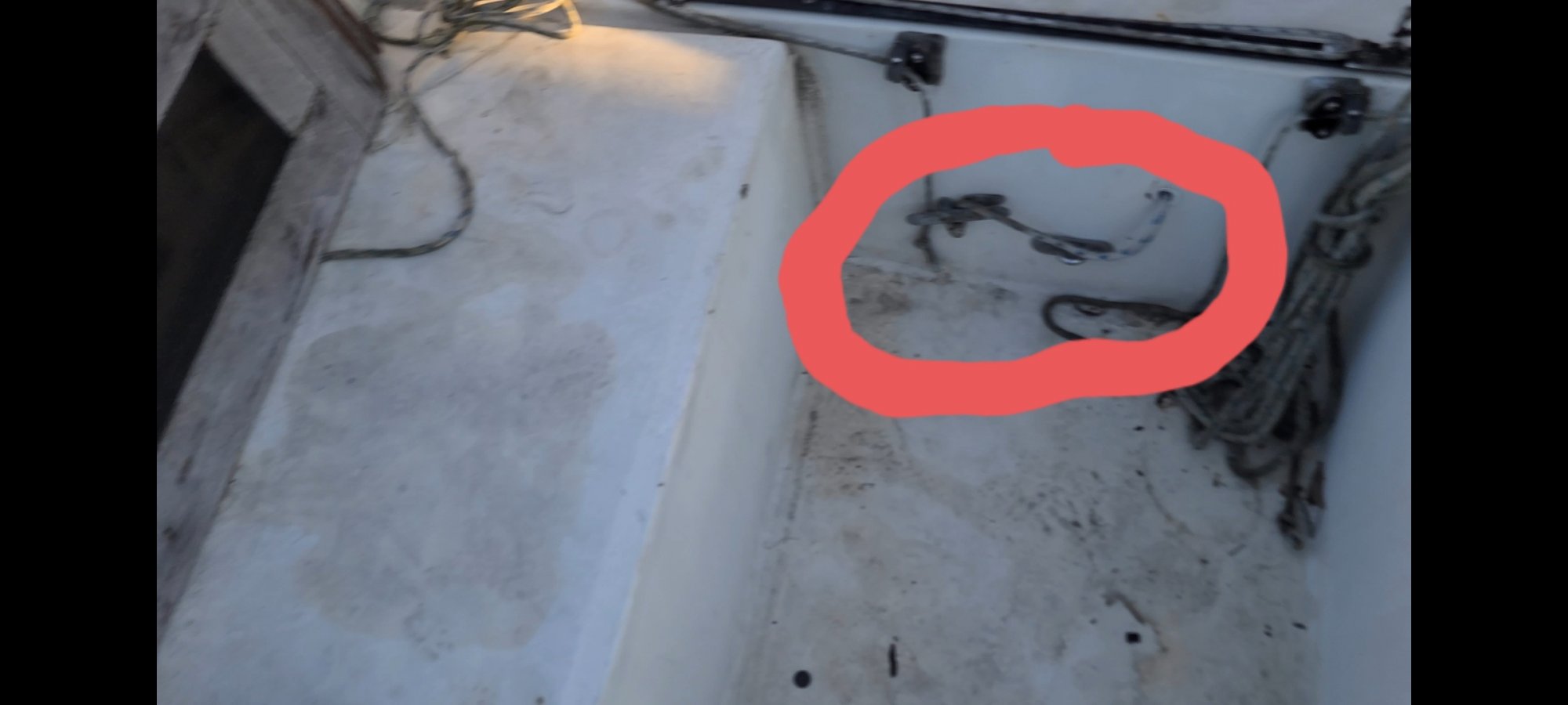

- how can you tell if your O'Day has the adjustable centerboard? Where is the line for this located? I searched all through the cabin and could not find one.

Good morning . The pendant for the centerboard will be in the front of the cockpit . There should be a small cleat for tying it off on the bridgedeck . It may be missing . Another way to tell is to step inside the cabin and open the door under the sink . Is there a thick black tube clamped to the inside bottom of the hull ? Remove (with a screwdriver ) the access panel just forward of that door look for the tube .
If you see the tube you have a shoal draft with centerboard configuration . Depending on how well the exterior hull was maintained the centerboard may not drop down easily . It fits fairly snuggly into the slot . It doesn't take much marine growth to prevent it from dropping .
Occasionally I dive under the boat and need to gently pry it loose ,from the back ..

>>You should see a line and a cleat in the front of the cockpit on verticle fiberglass by your shin. As Timm mentioned, sometimes it gets stuck. Last season it took a couple of weeks for mine to drop. I left it down the rest of the season. This year it dropped when it was lifted with the crane

Thank you for all of that information! I took a video of the boat for my wife since she could not be up there with me and managed to see in one of the quick videos this little guy so here is a screen shot. I take it I do in fact have the CB model if this is the line and cleat you are referring to? Excuse the dirty boat....like I said it was free and I just picked it up yesterday, spent maybe an entire hour on it before I had to drive back home!

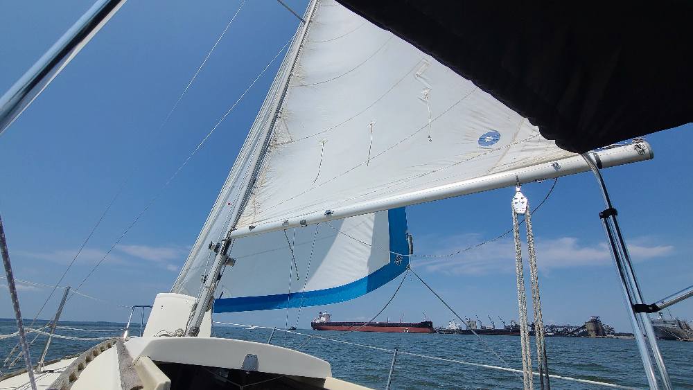

Yep, that's the centerboard pendant. I like the setup you have for your traveler sheets. It looks like it'd be easier to release in an emergency than what I have

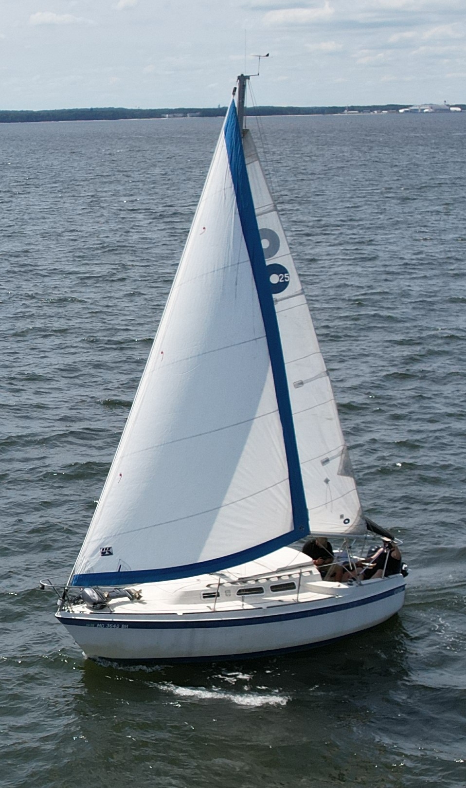

Just posting an update, we successfully sailed her home over the course of 3 days from Baltimore to Norfolk. I did not end up having an experienced sailor with me so a buddy of mine and I just did some learning on the fly. I started cleaning up the boat and my family and I are loving every minute of it!

Bravo! Looks like you got a rare nice boat for free. The main even looks to have a nice shape. Can't see the jib to tell about its shape. Enjoy.
24,938
Congrats. New boat with an adventure already under her sail. Enjoy the season and the blue fin crabs.

What a great adventure to begin your sailing life! Boat looks great! Enjoy!

Wow she looks great! That's awesome to hear you had a trouble free adventure on your first sail! If you really want to spruce her up checkout MaineSail's guide on wet sanding. We only loosely followed it and got some really impressive results

I have a 77 25 with a centerboard...am assuming you didn't have it out of the water yet. Looking at the picture of the CB pendent, the line going into the bulkhead is loose - this generally means that the board is stuck up in the trunk. The CB weighs about 65 pounds, and will fall down if not stuck. When it IS stuck, the line stays loose. I would check that if you haven't yet.
