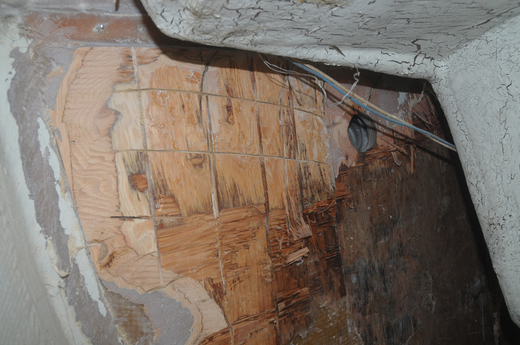

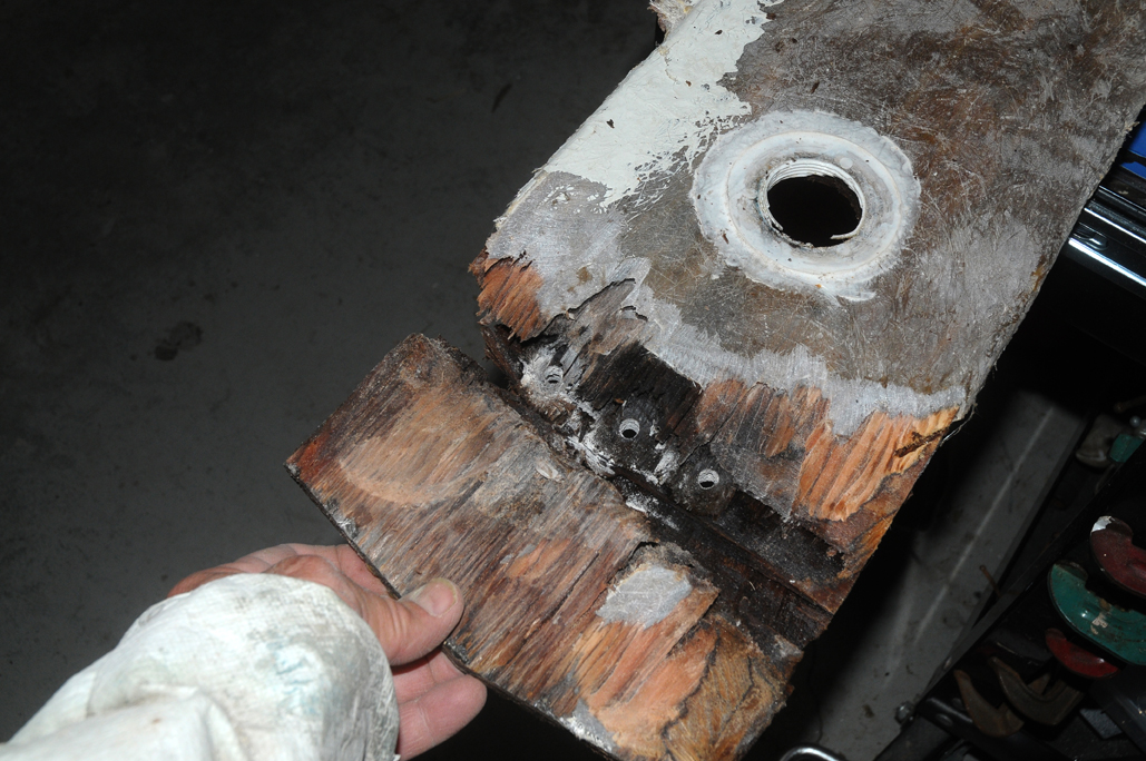

I love it. It's easy to control, not a racer, and is roomy. 5'6" headroom. The first one was in good shape deck-wise, but I did need to replace the bulkheads and the transom and king plates. The latter job was a bitch and I swore I'd never do it again, but the transom was SOLID when I got done. Glad I did it.

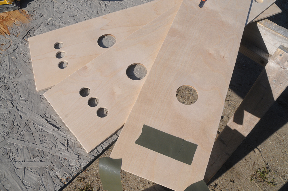

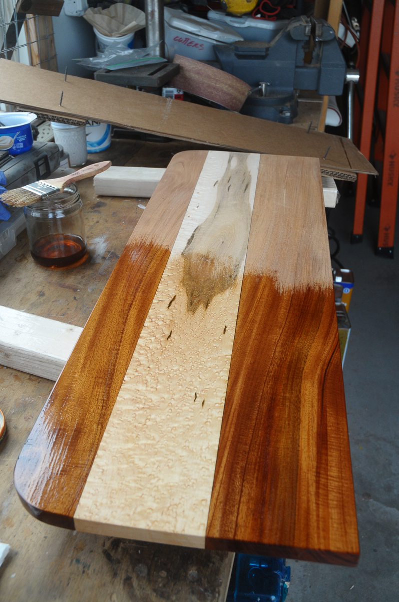

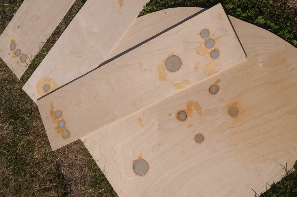

#2 was on the hard for some years, and had about a foot of water in it for a while, so ALL the wood came out- I gutted the interior. It's great now. I went to 3.4 ply vs 1/2 inch, and that necessitated remeasuring everything, but it's solid. Ditto the transom plates - they were gone too. Again, a nasty job..takes about 10-14 hours; very tiring. Took me two summers, but it was "fun". Somewhere in here is the whole process, which I posted about 3 years ago. Made a new table to replace the day-glo orange one- mahogany and birds eye maple. People think the whole thing is brand new.
