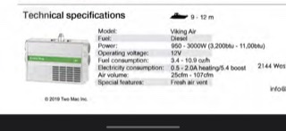

24,797
The 40DT shows these specs
Voltage: 12v
Fuel: Diesel
Heat Output: 1000w - 4000w
Power Consumption: 0.8 - 1.8 amps
Fuel Consumption: 0.1 - 0.3 l/h
The Viking or 30GB UNIT shows these specs.
Having a bit more than just needed is good when your talking about heat in winter.
