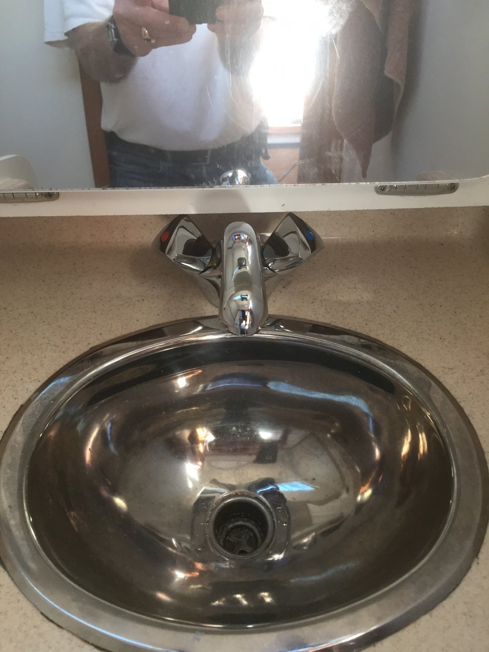

IMG_0485.JPG Any thoughts on where to get a replacement mirror for the head? Ours is starting to corrode and I've been asked to get a new one. It's the older version, that drops down, not the newer two piece slider. Catalina Direct doesn't seem to carry them. Haven't called Catalina Yachts yet.
Here's a partial picture of it (I was interested in the sink then).

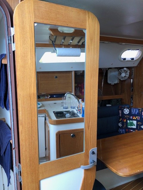

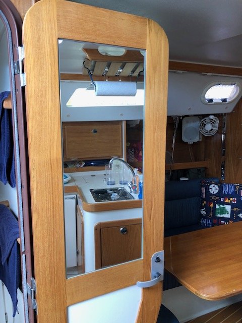

I took it one step further as my wife does not like the confines of the small head. I purchased an additional mirror that was cut to fit in the panel on the head door. This really opens things up.

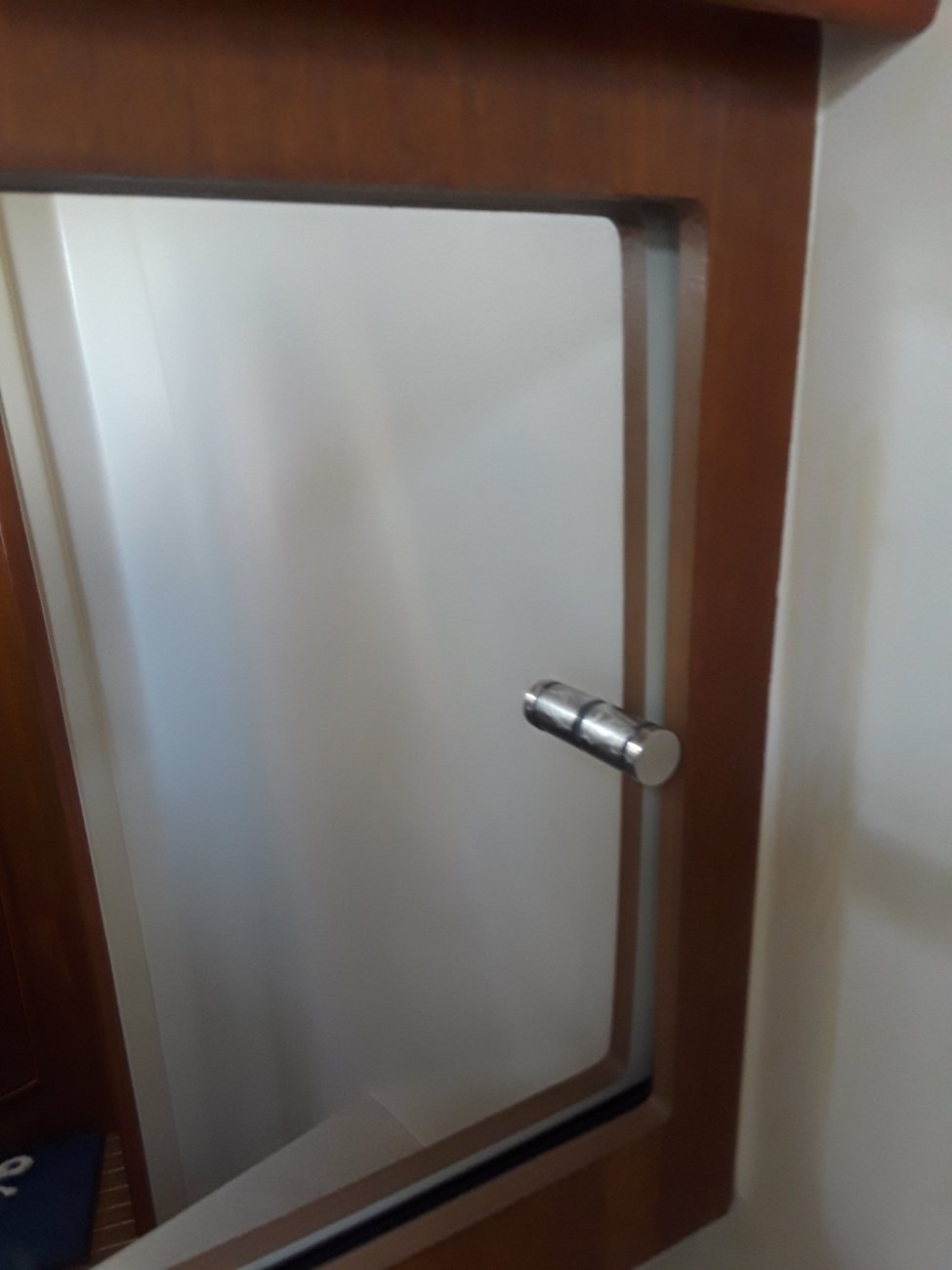

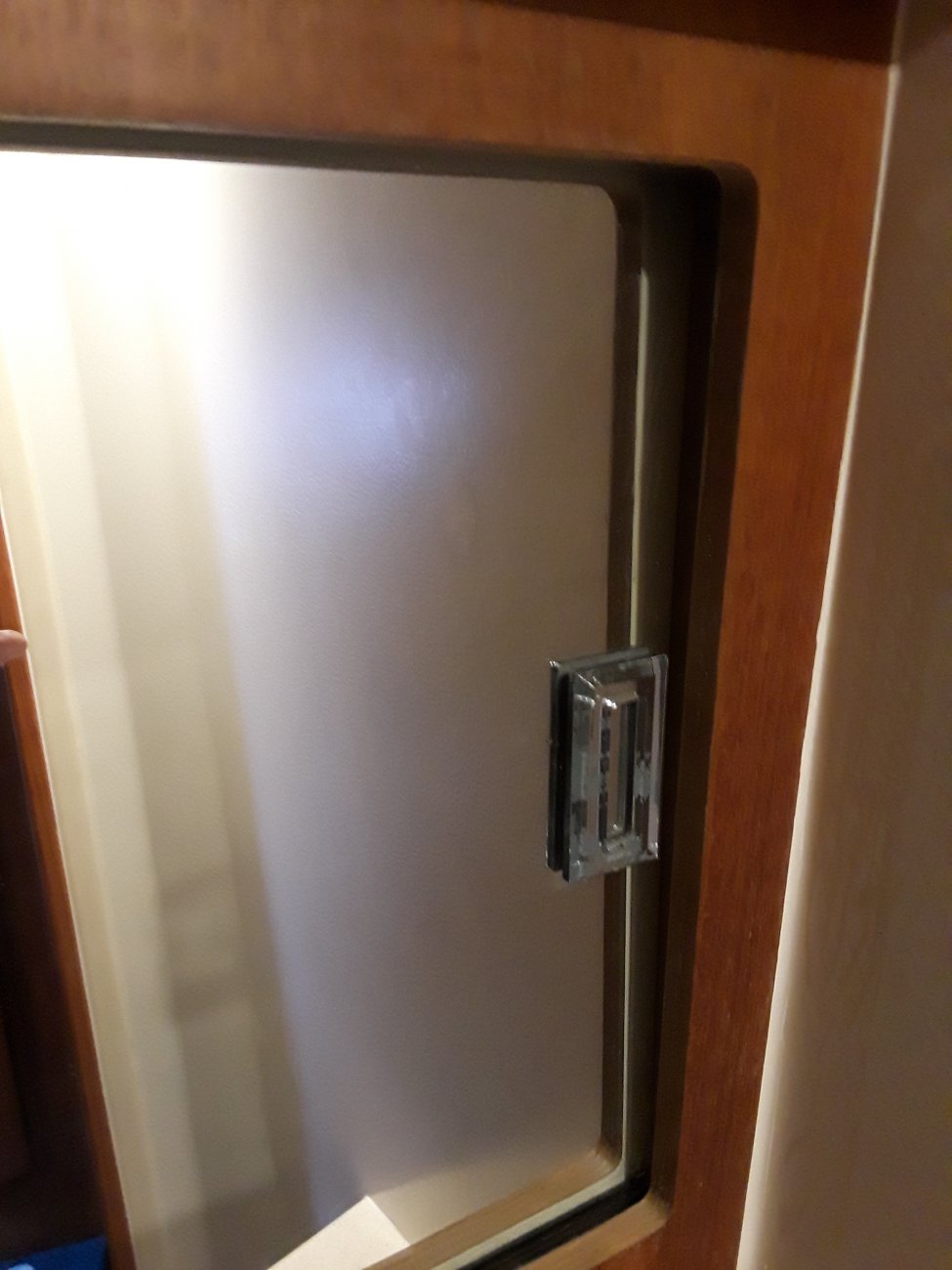

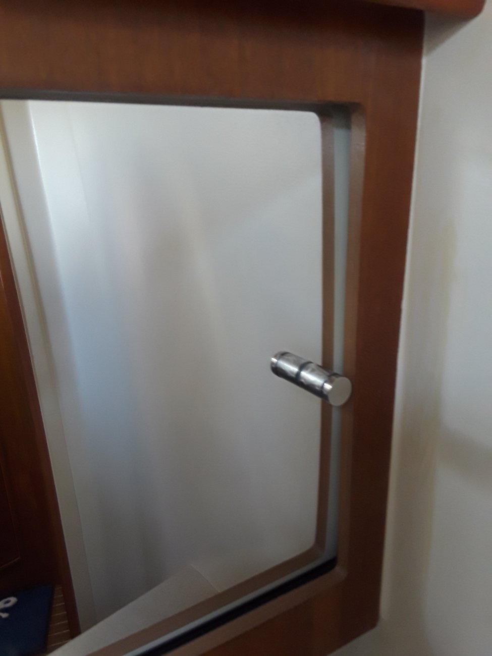

This thread got me interested in replacing my 2 head sliding cabinet mirrors, which were showing signs of corrosion on the handle and ends So today I replaced them with stainless steel knobs from Taps Plastic in El Cerrito, California.
