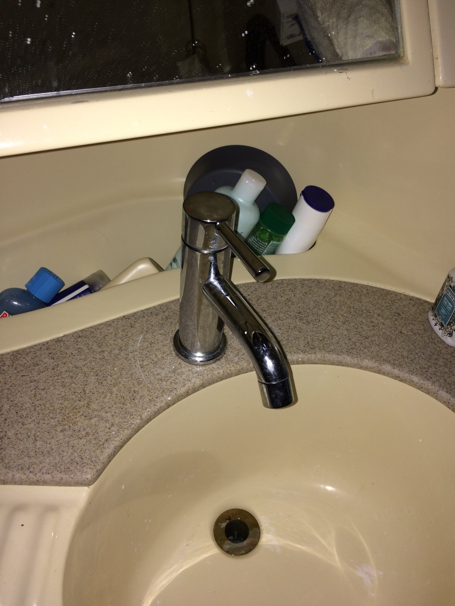

I replaced both my head faucets last year with SS Moen single lever units from Home Depot. Not cheap but very nice. Yes the old ones are hard to access - I just cut them out - knew I wasn't going to reuse any part of them. The Moen units were a nice fit for the holes in the counter tops and they look really good.

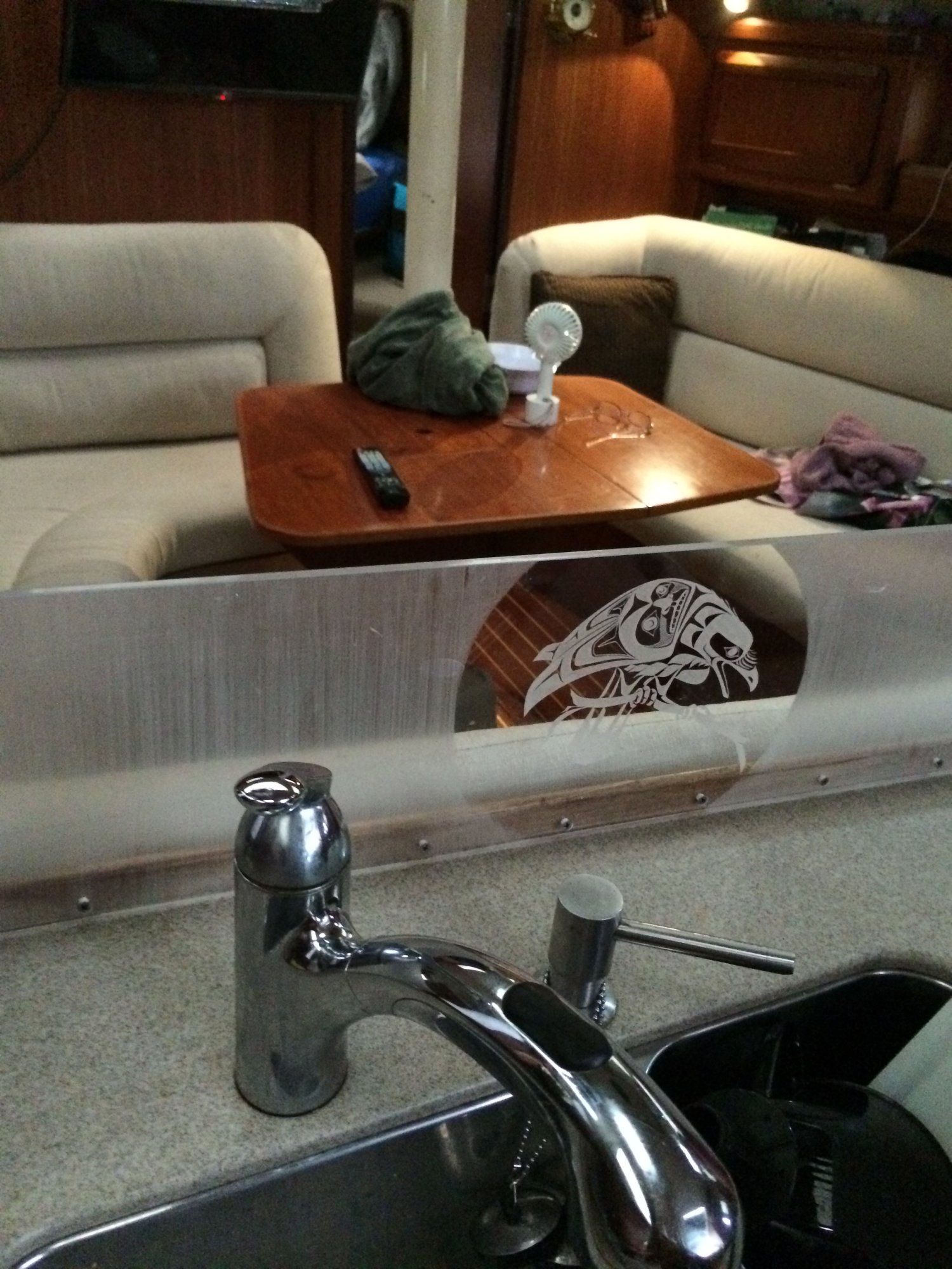

Hi Rich - the head faucets were model 84121. I also replaced the galley with a nice Moen unit model 87017. No pictures but waiting out a wind event tomorrow so may get around to it and post them here. These units were purchased at Home Depot here in Mexico - not sure if the model numbers carry over to the USA - but I just Google them and they came up on Mx sites, at least you should get pictures of what they look like.

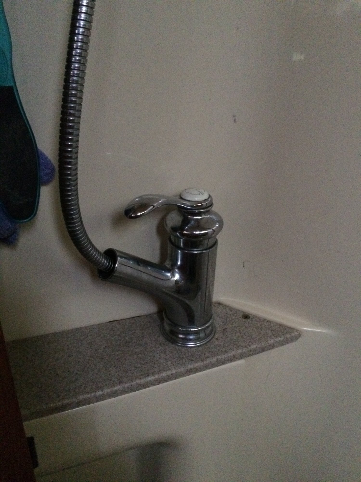

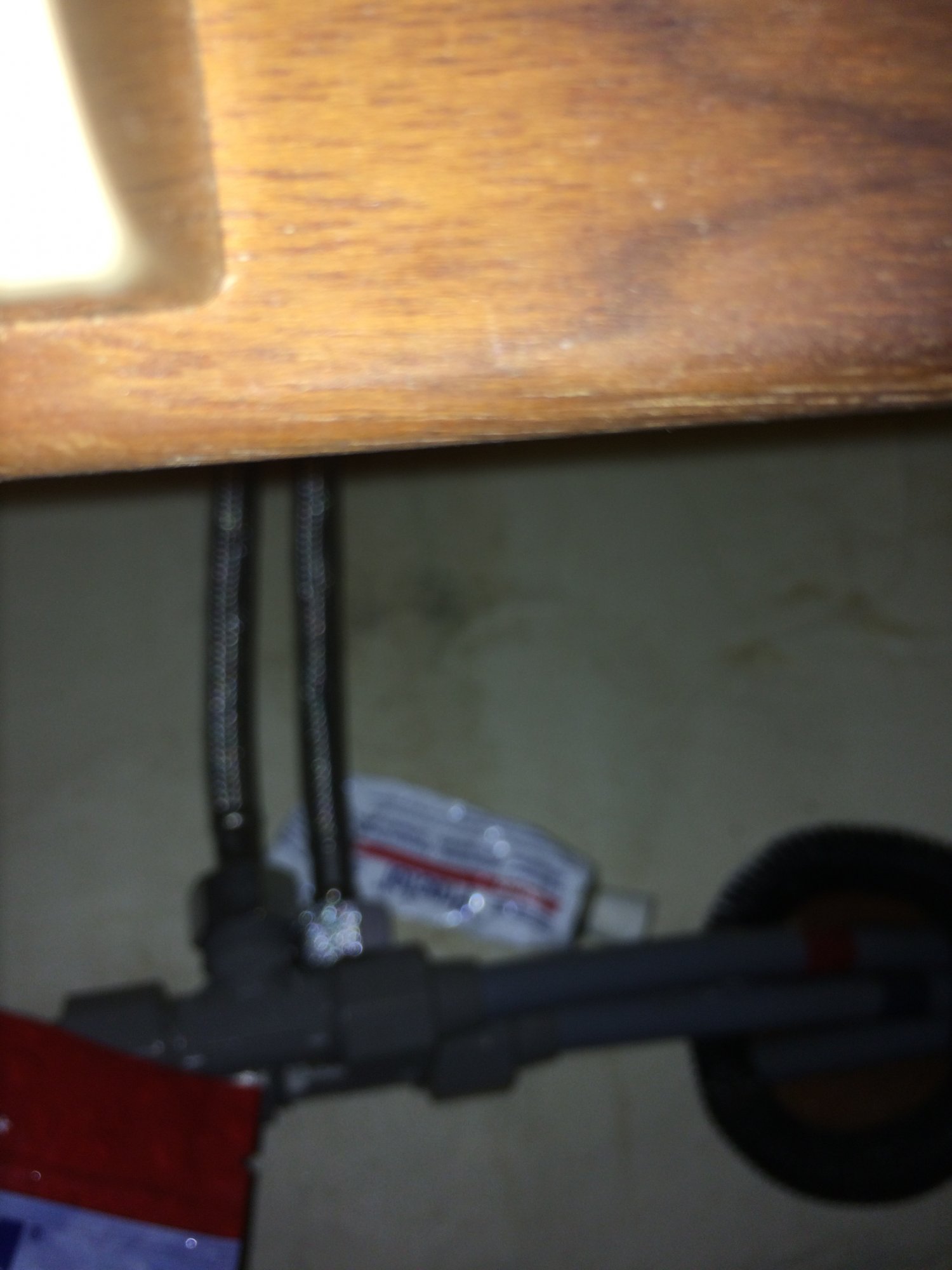

Hello Rich. Here are some photos. I've included a photo of the aft shower control. Not sure what you mean with "connect only to a hose". Our potable water lines are all gray plastic with Qest fittings. This includes the manifold under the stbd berth. I always thought this was the OEM config. So our aft shower control just has the two lines going down through the hole to the plastic lines with Qest adapters to join them into the water supply. Let me know if you want anything more

Thanks for the pictures. The aft shower control looks like a Kolher unit. Do you have a model number and a picture of the nozzle? Did you need to buy anything else for the aft shower, like maybe a longer hose or spray head?
