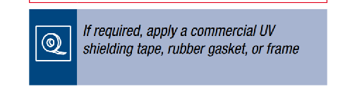

I shopped around a bit and got the cost for the Sika system down to $85 exclusive of the tape. Are there any alternatives to the tape? The only supply I could find on the web was in Latvia on Ebay and it wouldn't arrive until APRIL 23rd at the earliest, which won't work
If I can solve the tape issue and if anyone needs some soonish let me know and I will be happy to share the 205 and 209. You'll need to use it in a few weeks. Hazmat shipping I expect. You'll need your own tube(s) of 295-UV. I'll probably order around the 17th.
Tape? I used the prep, primer for acrylic to aluminum contact and the adhesive. I did two large 2x2 and a smaller hatch. Adhered the panels then filled in after.

The system requires a tape to protect the primer and adhesive from UV.
I didn’t run across that in my research. I made hatch covers that are on 99% of the time so no issue for me.
I wouldn't worry too much about this, but, you can get this tape - this one would probably be fine. Haven't used it, can't vouch for it...
If you are using UV filtering cast acrylic you don't need the tape. That's only for lenses that allow greater UV transmission. UV filtering polycarbonate also the same...
