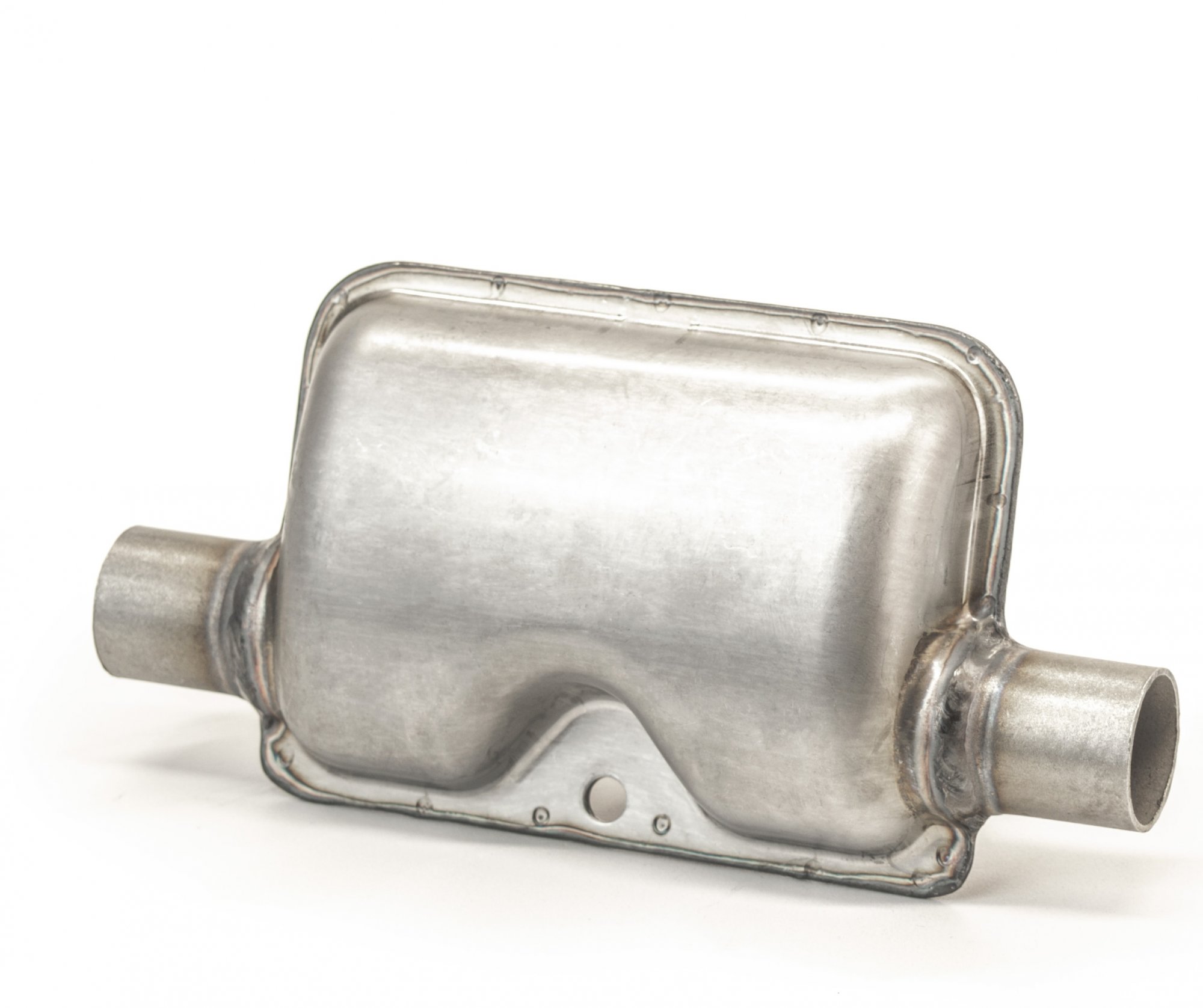

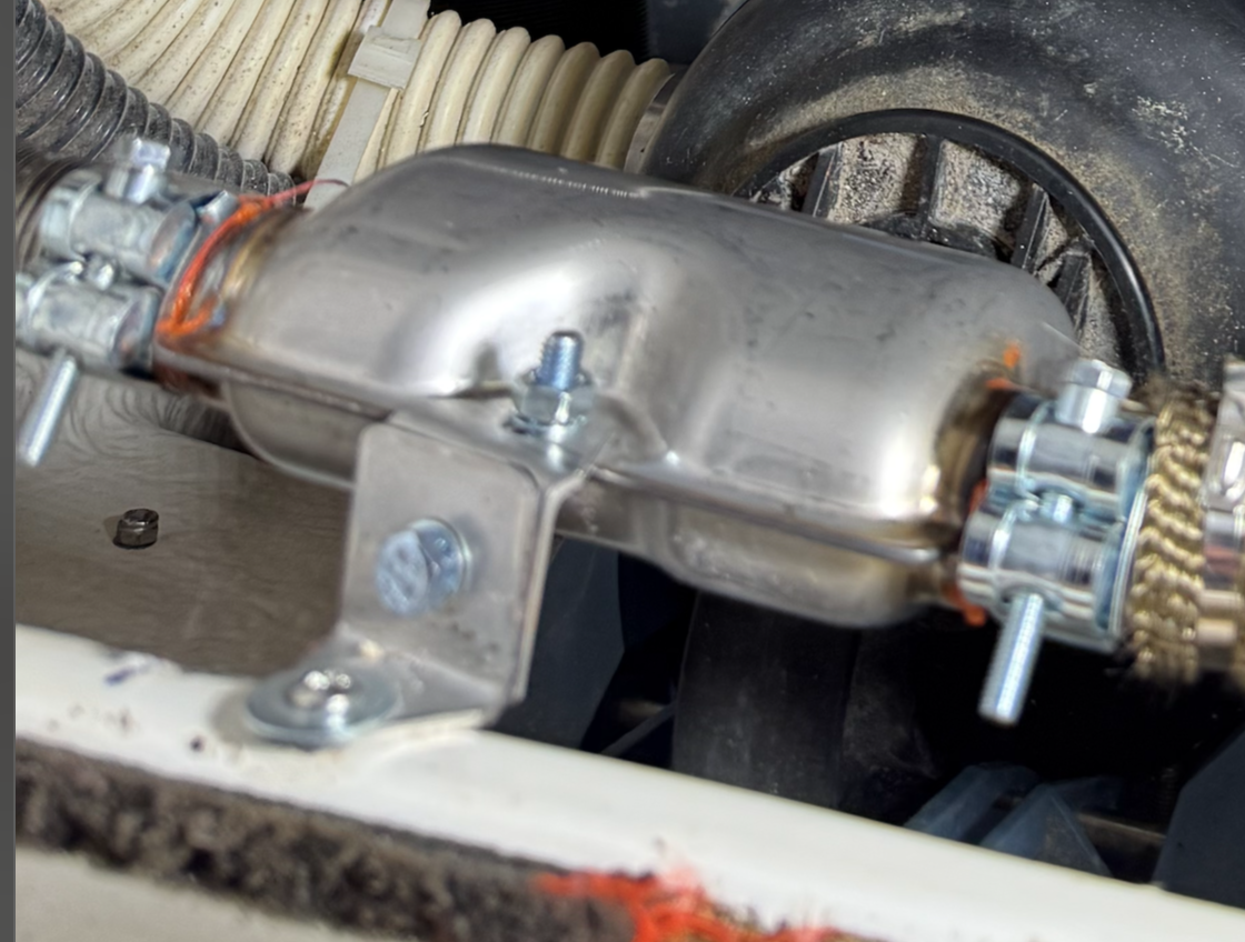

The crimped silencer in that video is indeed scary! Here's a picture of the Autoterm one, it is welded all around:

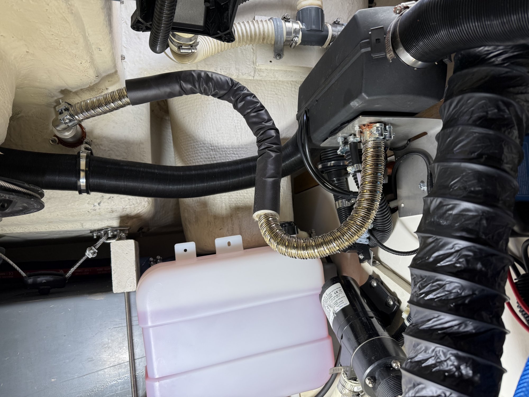

Here's a close up of the one in my boat, before I removed it due to the back-pressure issue:

The automotive flex pipe is attached edge to edge, so it is one layer thick. The marine flex pipe is attached edge to center so that it has 100% overlap for two layers full length.

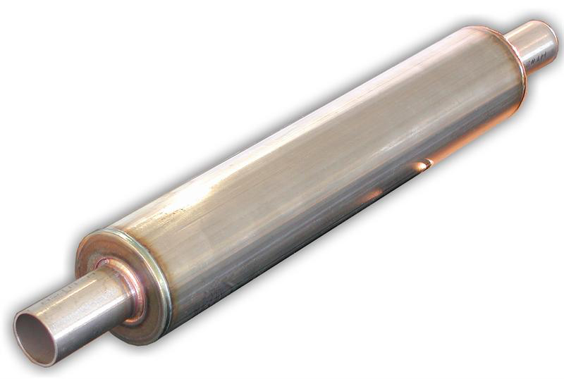

You could test your silencer to see if it has any leaks. The simple test is to put your palm on one end and blow into the other to see if it leaks. The crimped ones have massive leads and a drain hole that is just wide open.
My Espar was extremely loud when I first installed it so I got one of the welded marine mufflers and the difference was amazing. It went from sounding like a 707 doing a runup to a bare whisper.

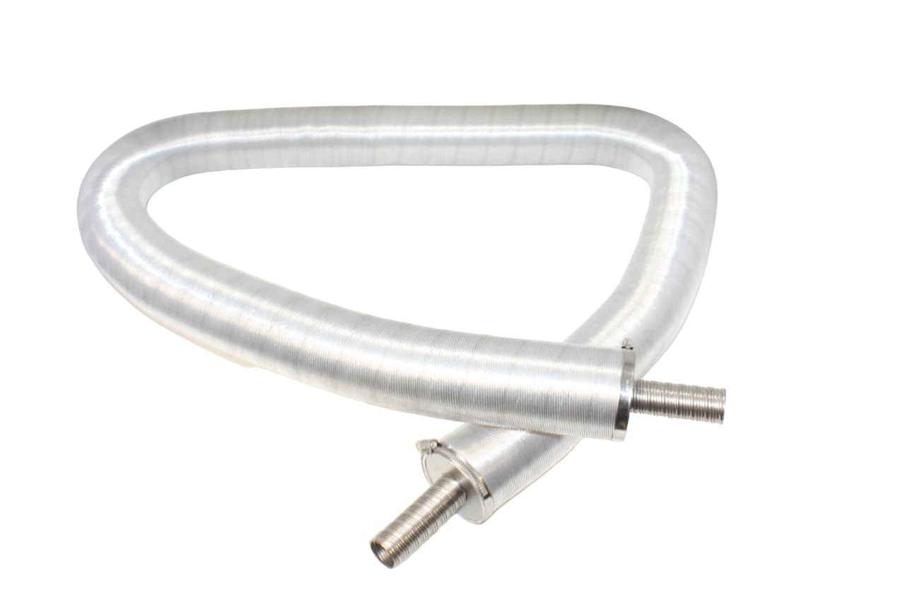

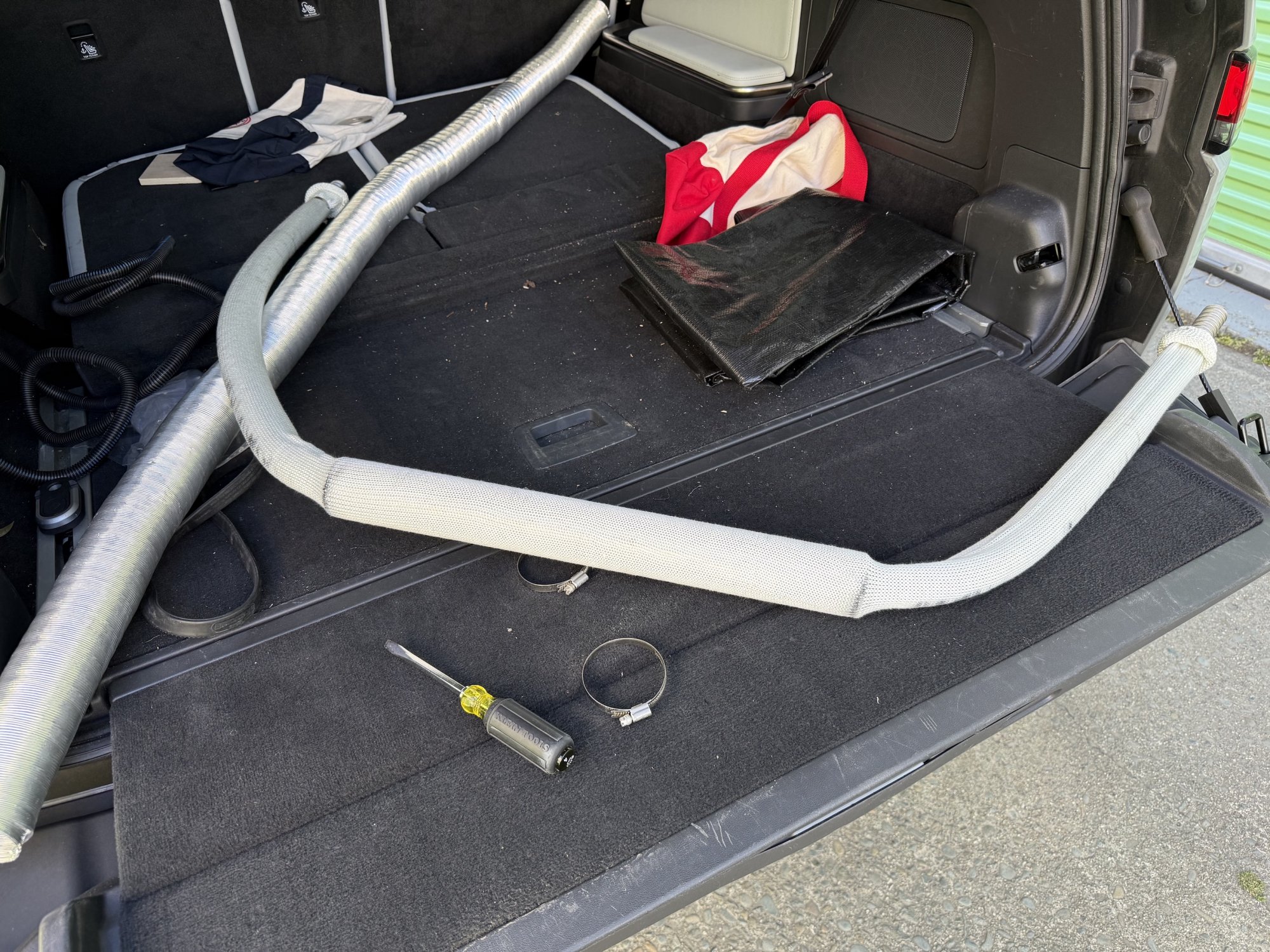

When I work on it again, I plan to install this Espar 24mm Marine Exhaust line that I got from HEATSO. It has the cylindrical silencer in the middle and the rest of the line wrapped in insulation inside an outer jacket. It wasn't cheap, but using that dusty exhaust wrap line is something I want to never do again.
By the way the 24mm line in the middle of this assembly is exactly what the one that came in my kit looked like.

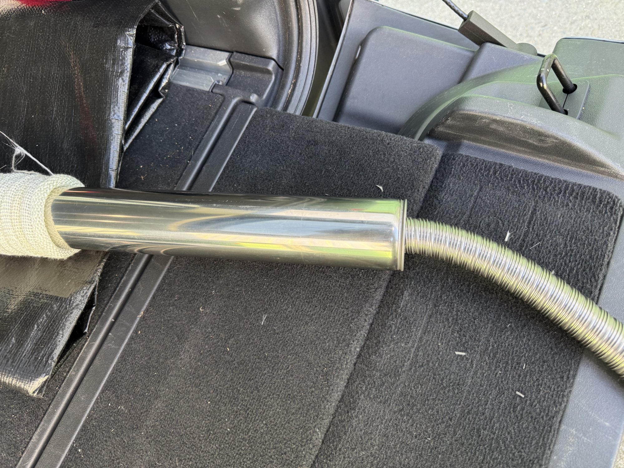

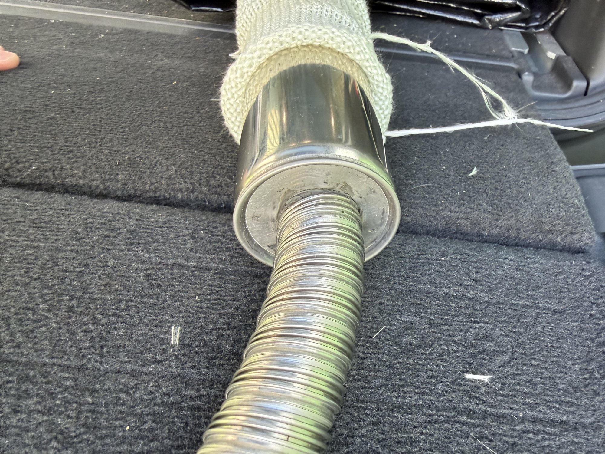

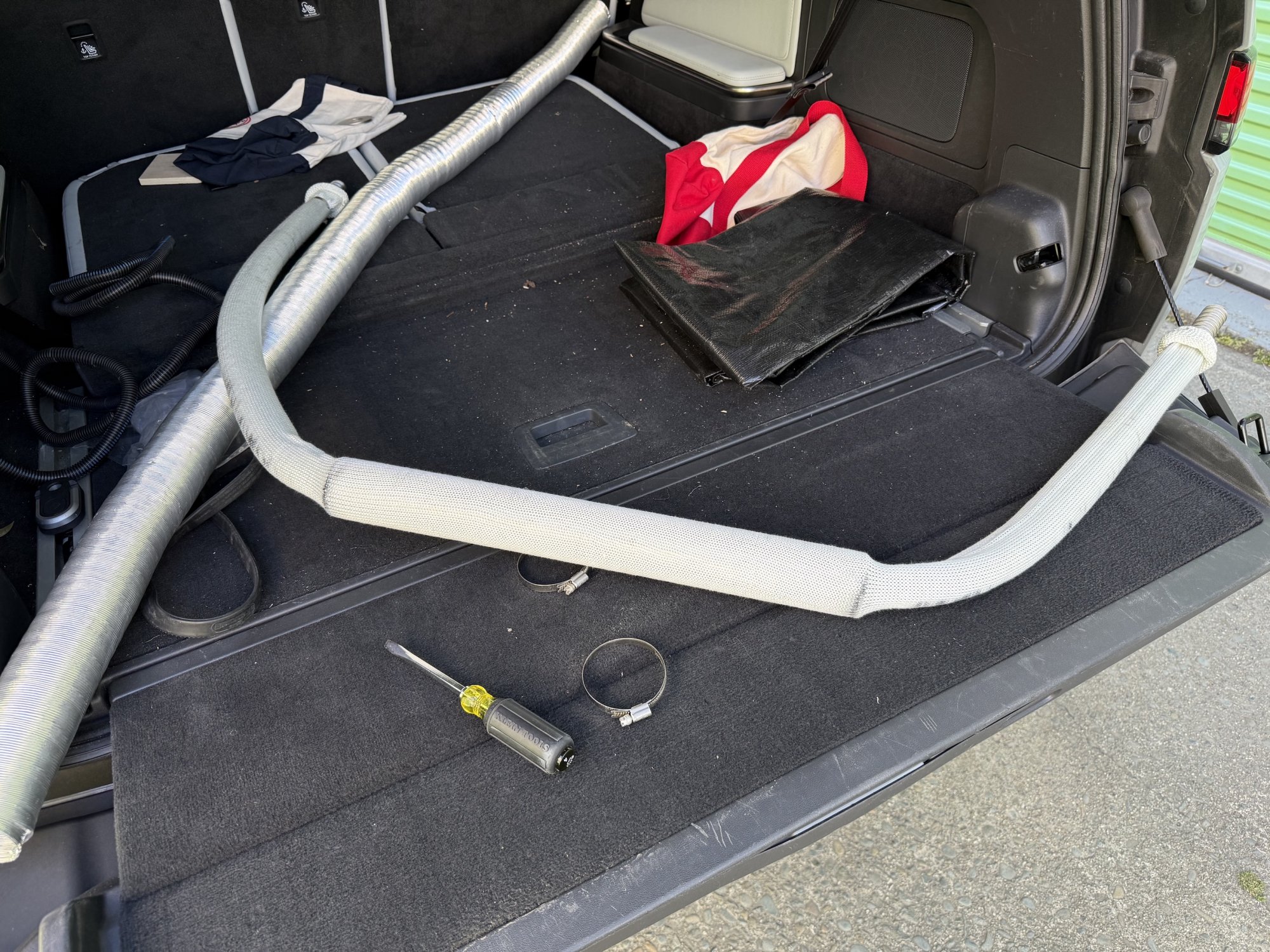

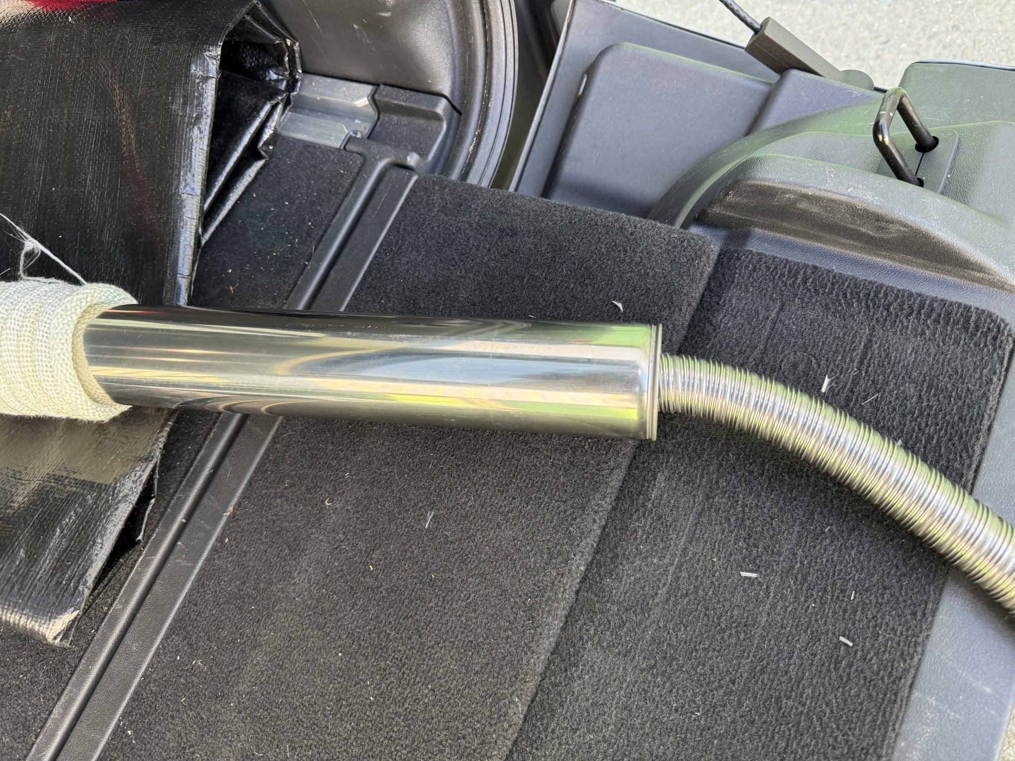

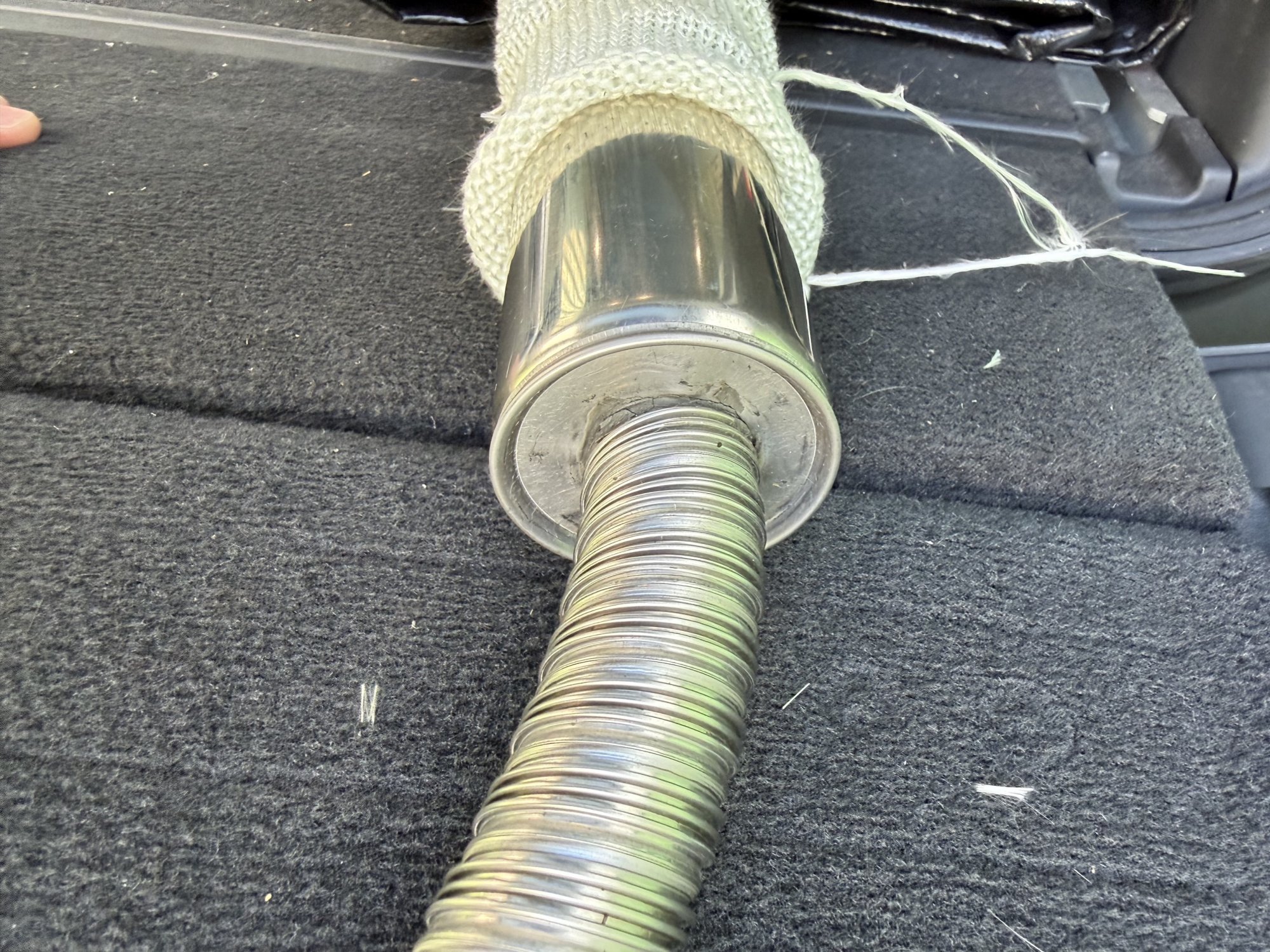

Now that I'm back to thinking about this, I took apart that Espar insulated assembly to see what things look line inside:
Seems like 24mm marine exhaust hose, a nice looking but very long (maybe 18" silencer), all wrapped in a sock and then the thin outside tube. It's not exactly "one piece," there is clearly some sealant where the exhaust hose enters and leaves the silencer, but it does seem well built and well sealed.
I'm not sure I'll get this to fit into my compartment, but going to try.

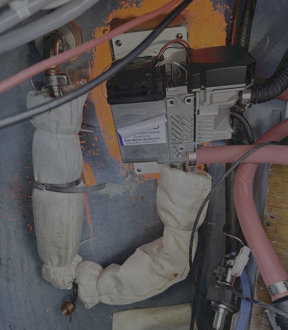

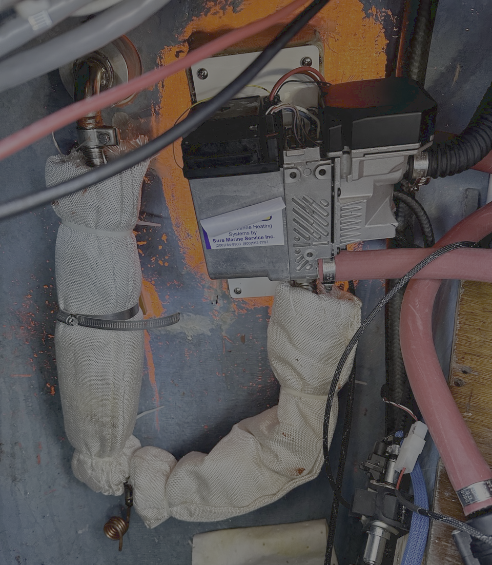

The exhaust silencer for our heating system is all welded and insulated with a fiberglass sock filled with insulation. These came from Sure Marine.
This is the same setup I have except that I got the welded muffler from ebay for well less than Sure Marine charges. Their boat tax is pretty high.
That is a nice looking exhaust and about what Sure marine charges for just the muffler.
