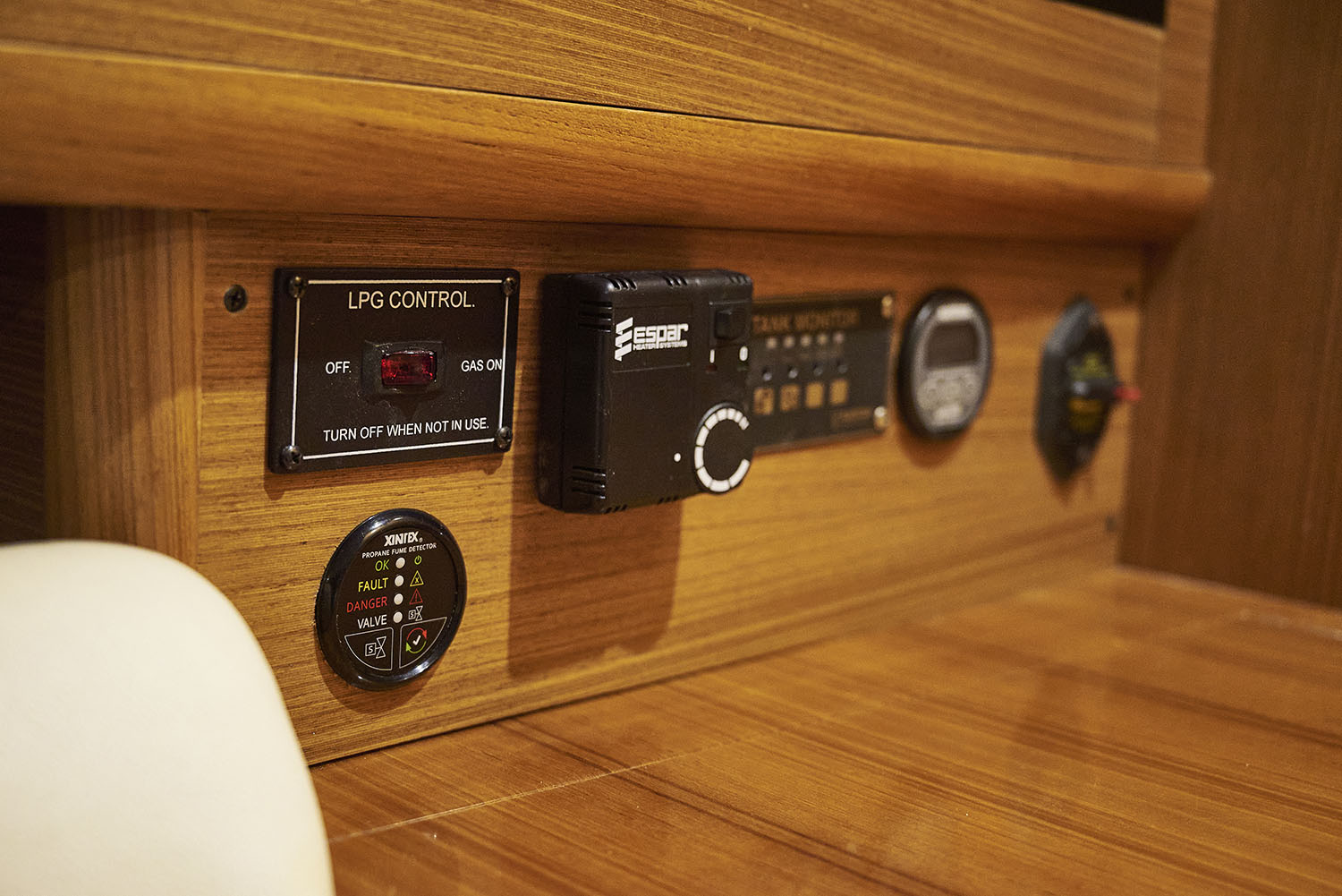

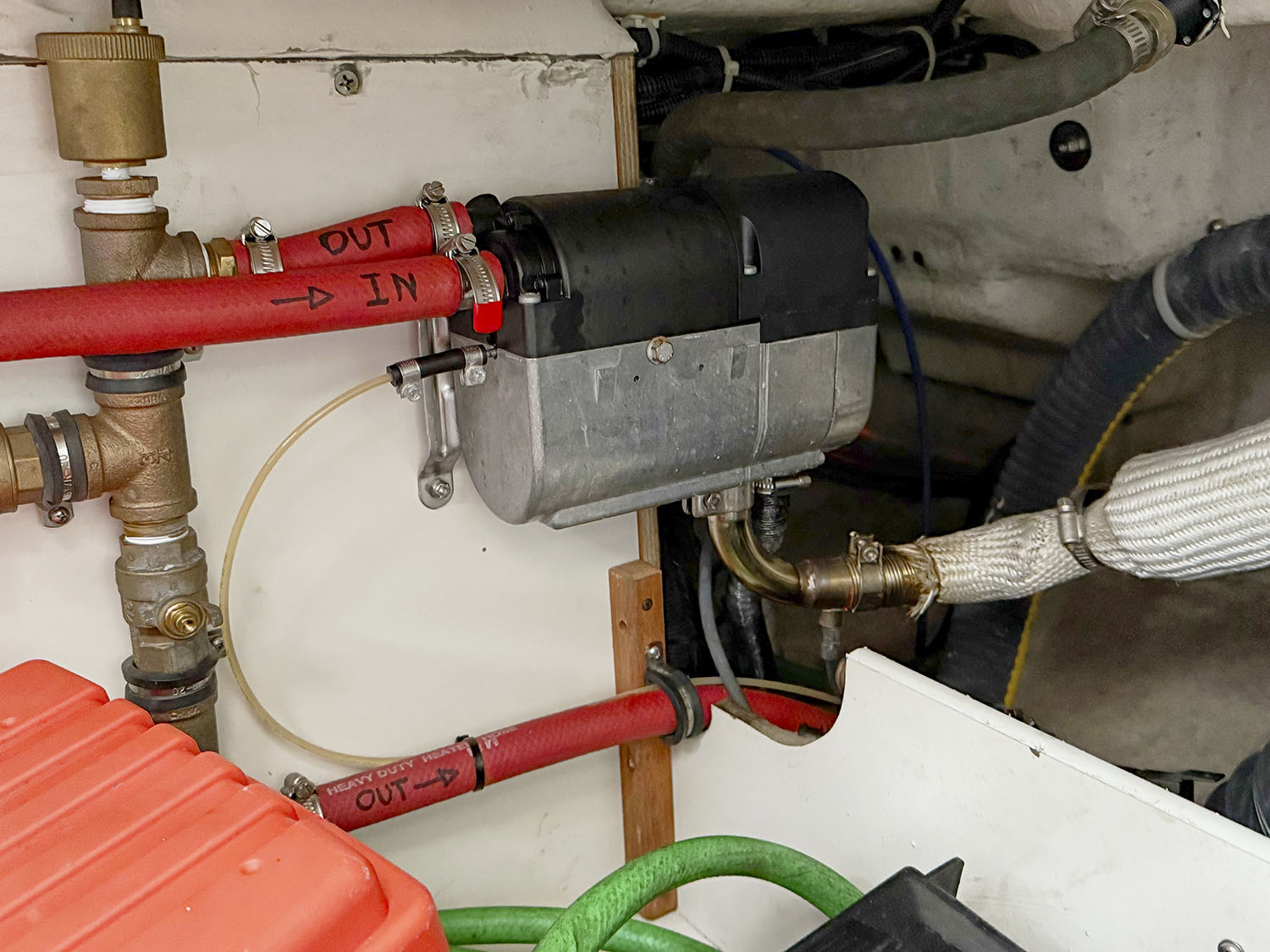

We have an 2018 315 that came with the Espar furnace when we purchased it. Our boat is in Vancouver. We spent a couple of weeks living on it in January and February and it is very comfortable to live on in the winter. You will notice in the photo of the cabin that the heat vents are near the floor in the main cabin and forward berth. There are several vents, one in the aft berth and one in the forward berth, and I believe there are four in the main cabin. I highly recommend having a furnace if you are in a cooler climate.

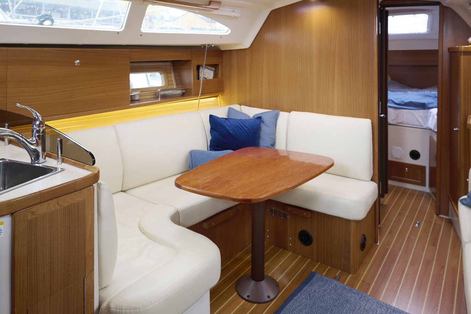

Is this a hot water system? The first picture looks like water plumbing.

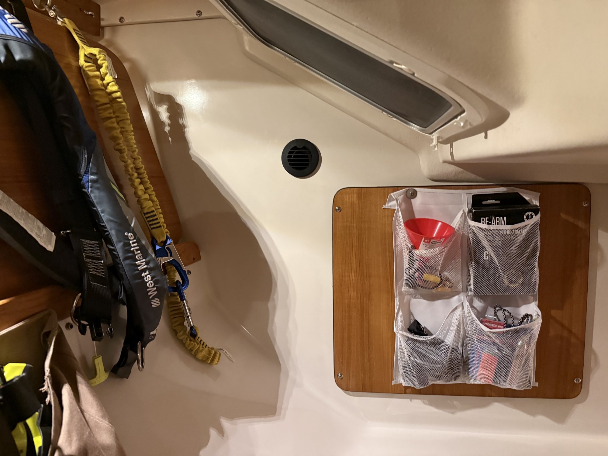

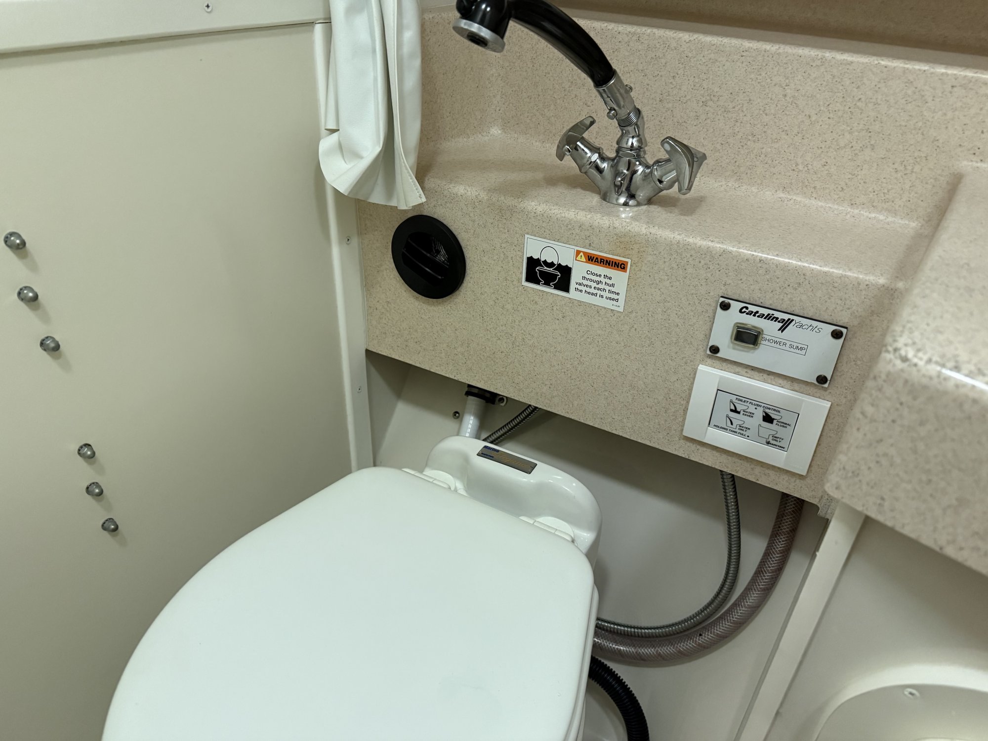

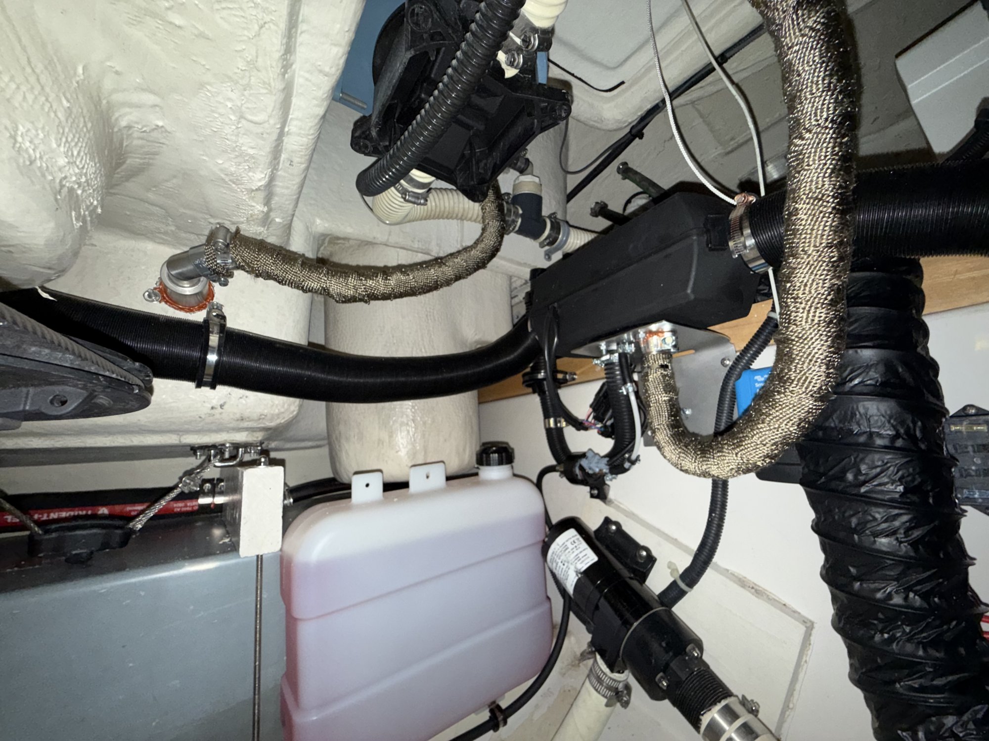

I installed an Autoterm 2D diesel heater. The intent was not to heat the whole boat, but to get heat into the head to act as a drying locker for wet gear and into the aft berth to warm up cold crew. I'm excited to see how it works on my upcoming coastal trip from Portland, OR to my new home in Berkeley, CA.
Here are some pics of my install:
The unit is installed in the steering/fuel-tank/water-heater room on the port side.
Note that this picture is with my original exhaust design that mounted the silencer way up high to provide lots of protection should the output port get flooded. This did not work as it created too much back-pressure and resulted in the heater shutting down after a few minutes of running and outputting lots of smoke. I later reverted to a simple pipe from the heater to the output, with a best-effort little hump in it for fooding protection. At the moment, I'm running without a silencer and it's still very quiet in the cockpit. I plan to upgrade the exhaust with better flooding protection, a condensation drain, and a silencer in the future.
I also used a dedicated 7 liter fuel tank, which will run the unit on high for around 30 hours. The bottom of the tank is bolted to the fiberglass rib of the liner and conveniently tucked tightly behind the macerator for upper support. I didn't want to mess with installing a new suction tube into my main tank, but may do this if I ever have to pull the tank again.
For the combustion air intake, the included silencer is mounted just behind the unit and draws air from this compartment directly below the open vent in the transom.

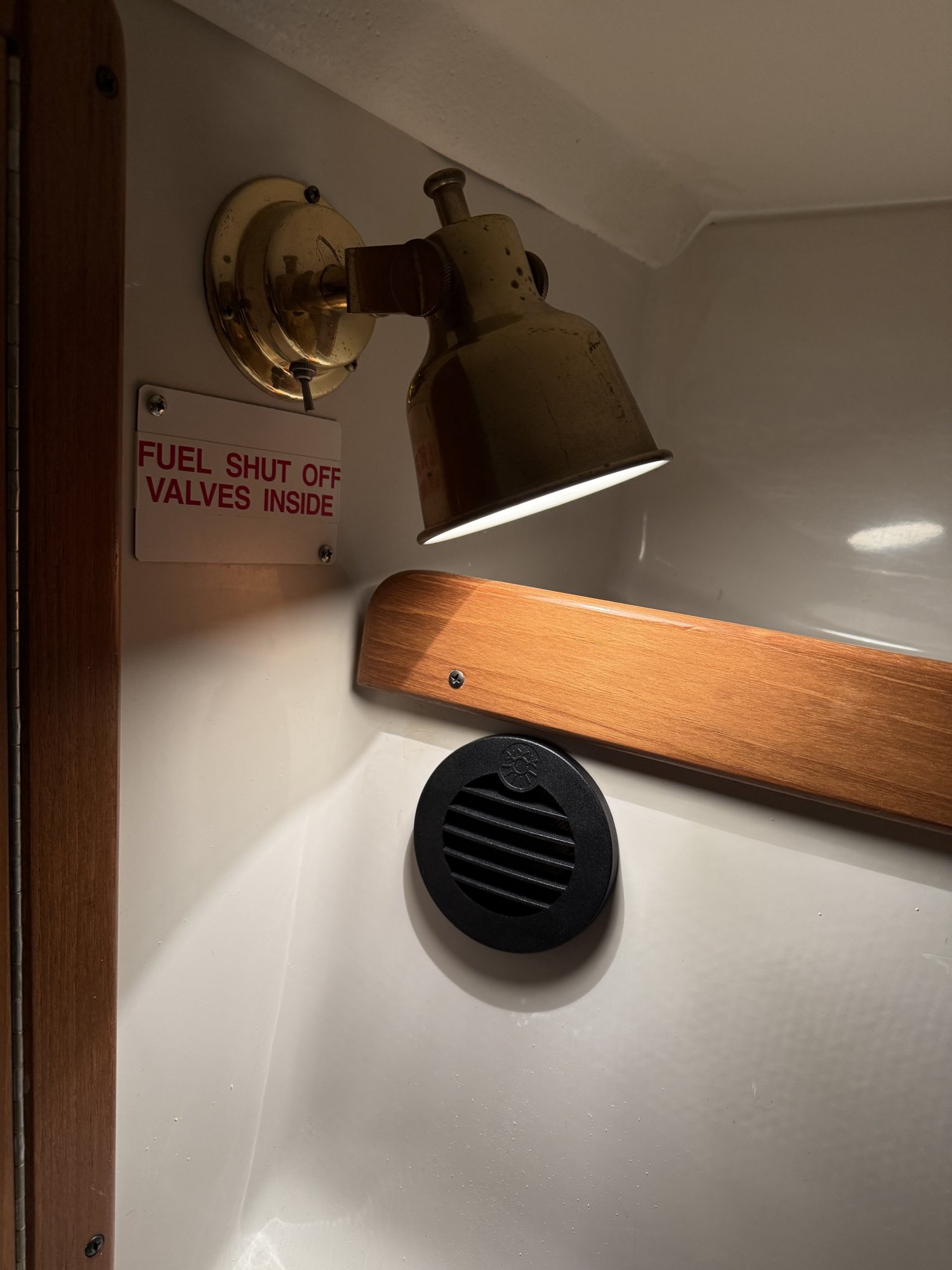

The 60mm intake duct runs across the steering room to the starboard side, and the intake vent is in the cabin here:
For the hot air output, I ran the 60mm intake duct around the corner of the waste tank and into the void behind the aft berth cabinets. I tucked a Y-fitting right back in there and connected one vent back in the corner of the aft berth and the other in the head:
I figured I would need to install a vent in the door to the head to allow the return air to escape back to the intake in the aft berth, but without it the head still gets nice and toasty. There must be enough air the leaks out of the head back to the cabin through other spots.
The wiring was straightforward, I connected it to a spare 20a breaker in the main panel and installed the Autoterm "Simple" mini control panel and temp sensor next to my VHF.
It is very bad for the heaters to cut power while they are running, as it prevents the "purge" cycle from clearing the chamber. I'll use one of these BlueSea toggle guards to protect against accidentally breaker flip, like I do on my macerator pump: https://www.bluesea.com/products/4100/A-Series_Circuit_Breaker_Toggle_Guard
Once I sorted the exhaust issue noted above, the unit runs well and made plenty of heat in my Portland December test. I will report back how it works after our 700NM trip down the Oregon / Northern California coast.
Nice install. Is that really on a C25? If so, it should provide all the heat you need. I have a 5kw heater on my C30 and it has no problems keeping the whole boat warn even in the low 20's.
What did you do for exhaust? Most of the non-marine kits come with a single spiral exhaust pipe which is fine for a truck install but is not safe for a boat. Marine installations need to have double spiral fume-tight exhaust. It should also have a condensation drain. If you put a silencer on it, it must be a fully welded airtight marine muffler. The silencers that come with the kit leak air and can kill you.

I need to figure out how to update my profile. My boat is a Catalina 310.
Autoterm claims in the manual that the exhaust line shipped with their kit is suitable for marine installs including their silencer. I will be carefully monitoring CO in the installation compartment with my low-level CO meter (measures down to 10ppm).
I do plan to do the condensation drain next. I've read varying/conflicting feedback if they're needed in the moderate ~50 degree F environments I'm running in. It will add a handy 90 degree bend which will allow me to get more "hump" in my exhaust for back-flood presentation.
