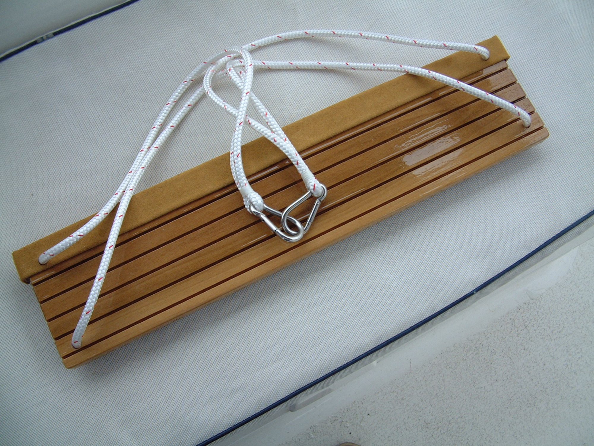

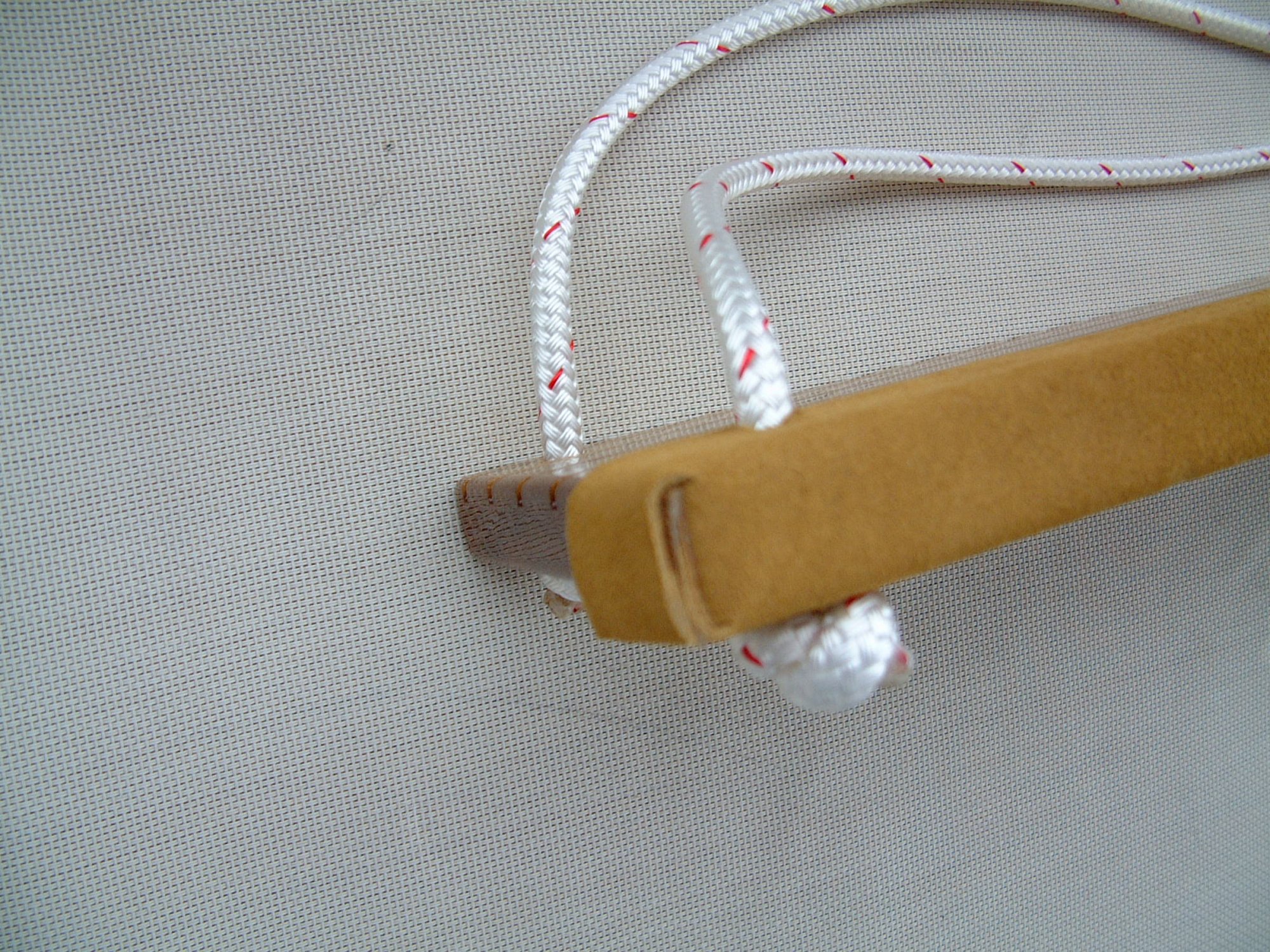

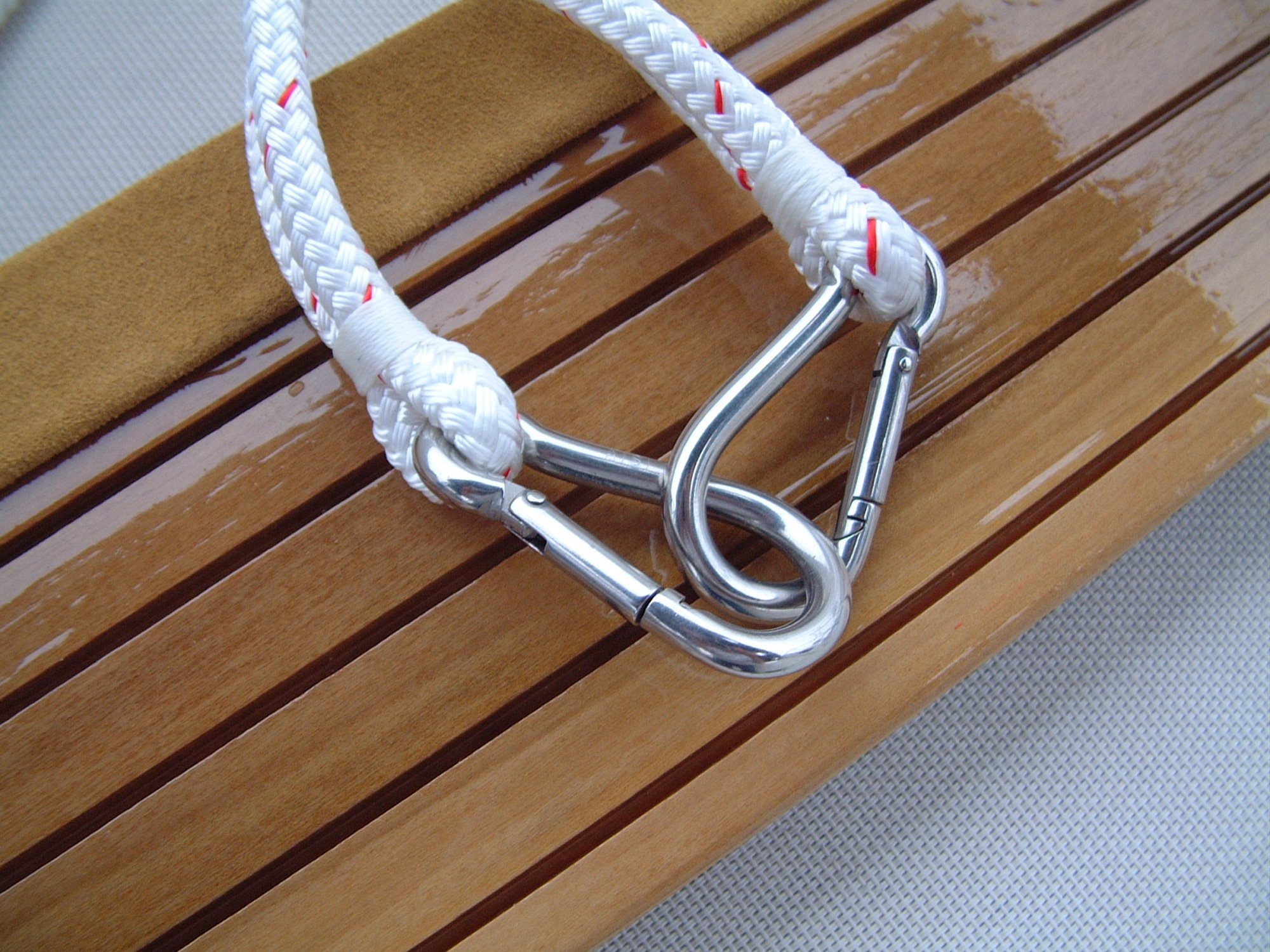

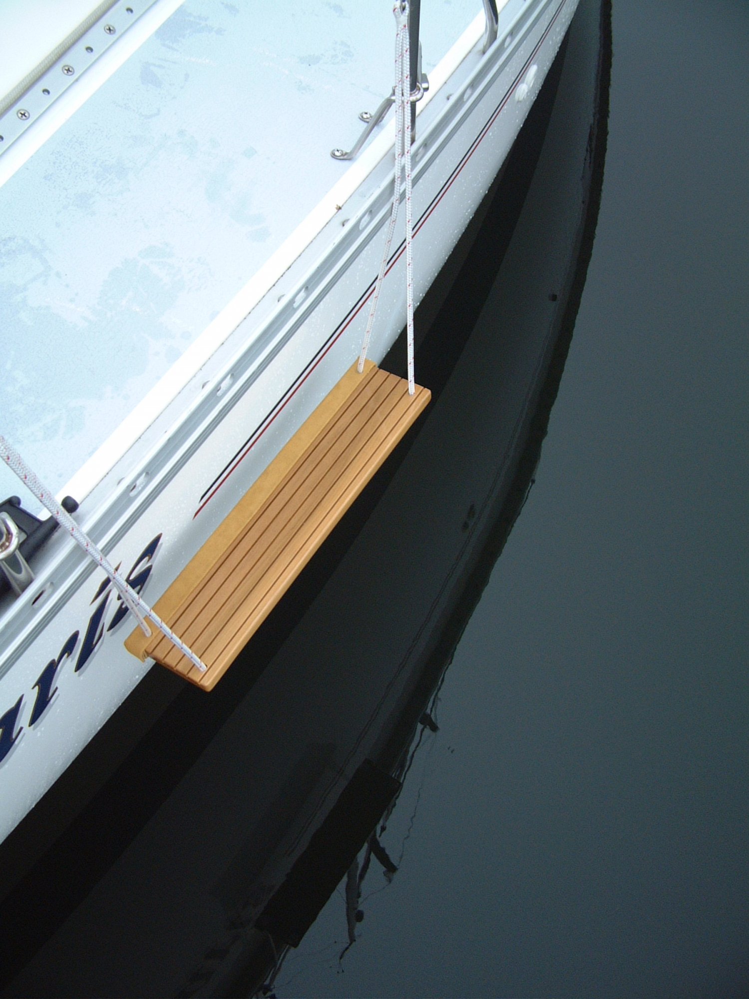

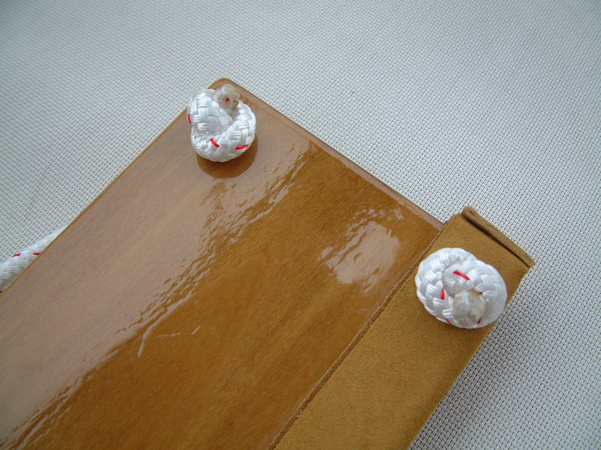

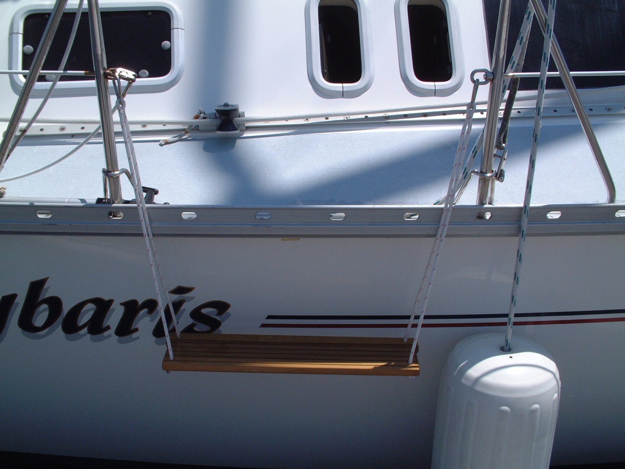

I saw a beautiful wooden step at a boat show but choked at the $175 price. So with $10-12 of materials (each) and a couple hours of effort, I made my own step and two more for friends. I covered the edge that faces the hull with leather for protection.

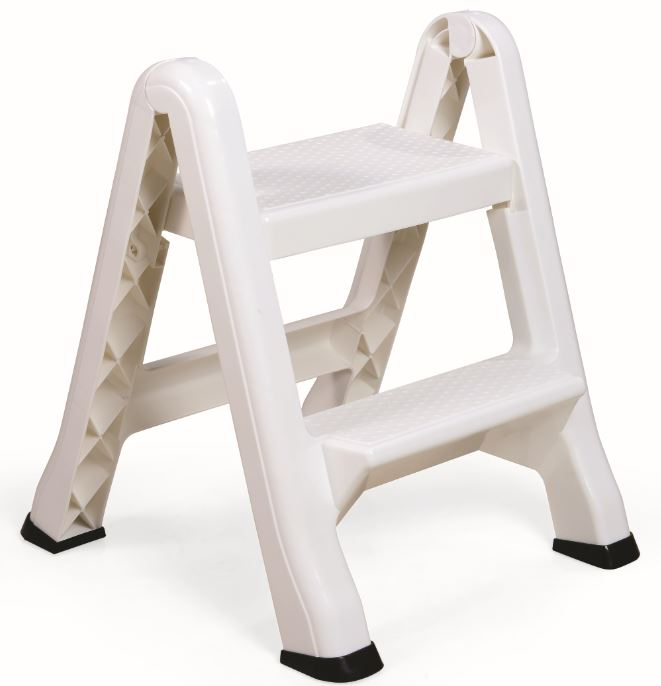

I use this for stepping off at a dock for fuel or pump-out. At my slip I have a commercially manufactured large molded two-step platform.
2008_0603_070959AA.JPG2008_0603_071008AA.JPG2008_0603_071020AA.JPG2008_0603_071042AA.JPG2008_0603_071301AA.JPG2008_0608_003156AA.JPG

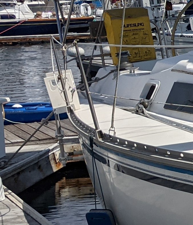

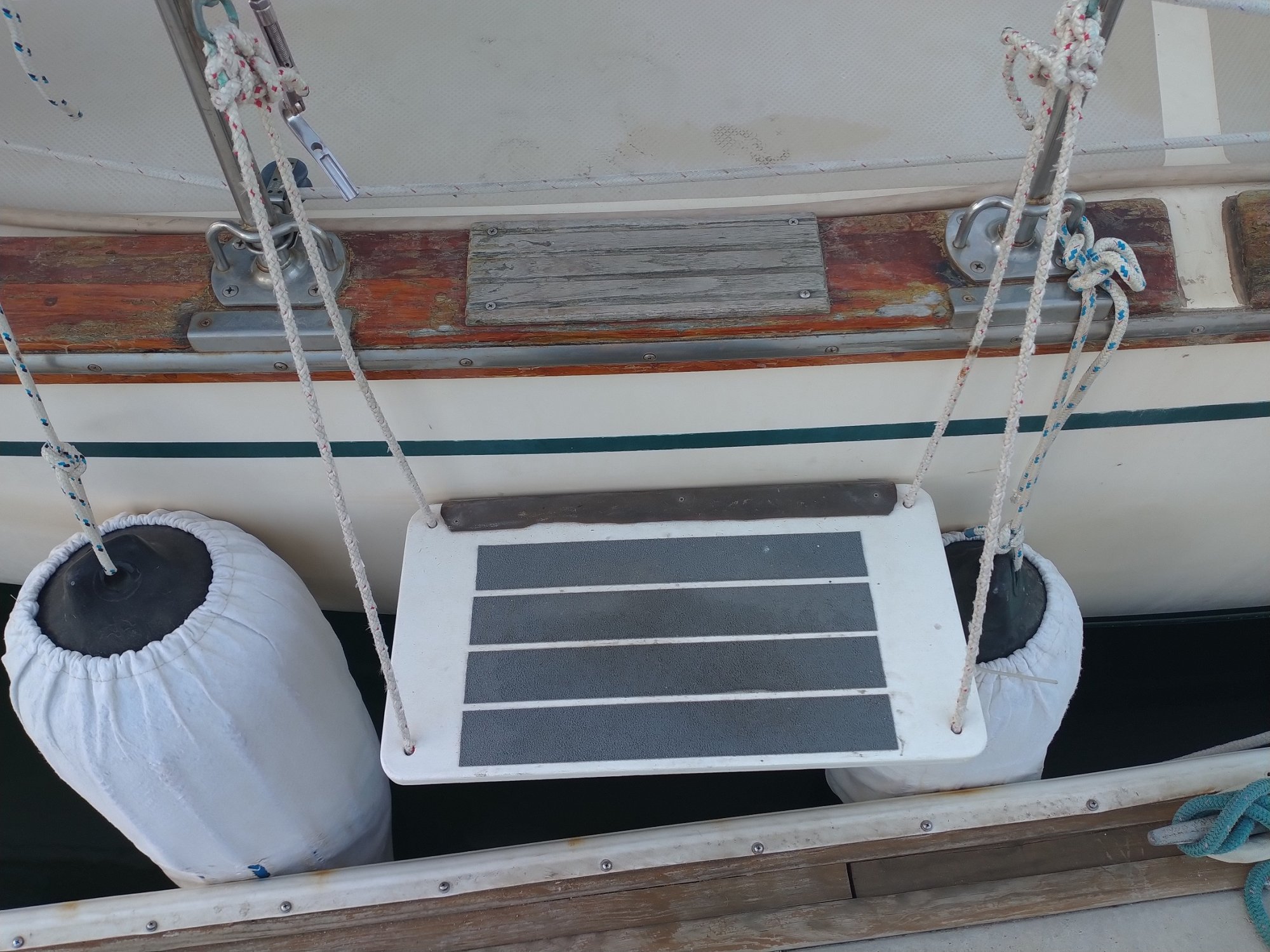

I've built a couple of them over the years starting with plywood and carpet covered steps. My last step started life in the Bargain Bin at West Marine for $20.00. It was a three step gunwale boarding ladder. A bit of surgery with a tubing cutter to make it only two steps, some Starboard side pieces and a couple of bits of aluminum bar slotted for the toe rail made a versatile ladder. I extended the standoffs with a bit of PVC pipe and crutch tips so it hangs vertical. The good thing about the 1985 H34 is the extruded aluminum toe rail. I can put the step anywhere. It folds flat for easy storage in the dock box or down below.
