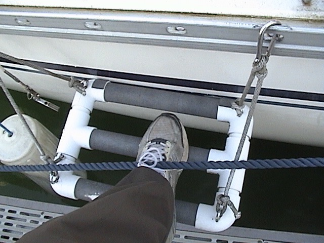

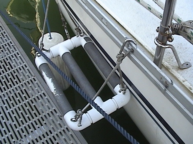

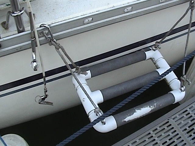

I made a boarding step for our boat out of inch and a half white PVC several years ago so that the admiral had a way to easily get aboard. It is about 18 inches long and 12 inches deep with 90 degree elbows at each corner. In the center of the deep side are tees with a piece of PVC connecting them. Around each of the three pipes I installed 3M self-adhering non-skid from Home Depot.
At each corner I drilled a hole for a 5/16th inch SS eyelet bolt that is secured with a backing washer and self-locking nut. I used 3/8th inch double braid line between each eyelet on both sides with a carabiner that clips onto the toe rail. There is enough line so that the step is mid way between the dock and deck.
The two carabiners allow me to unclip from one side and move it to the other depending on side tie. While underway I clip the step onto the outside of the life lines next to a gate where it rides safely out of the way until needed. It is very strong and will hold well over two hundred and fifty pounds (test weight).
As you can tell the 3M non-skid tape has worn through in places and needs to be replaced. After all this step is about 15 years old and has several thousand miles of use.

Hi Brian. The nylon 3/8" double braid should hold more weight than the PVC pipe. I know the step will hold at least 250 pounds, which is what our slip neighbor at the time weighed when I tested it. No break test was performed. I could say 1,000 pounds, but that might be an over statement.:liar:

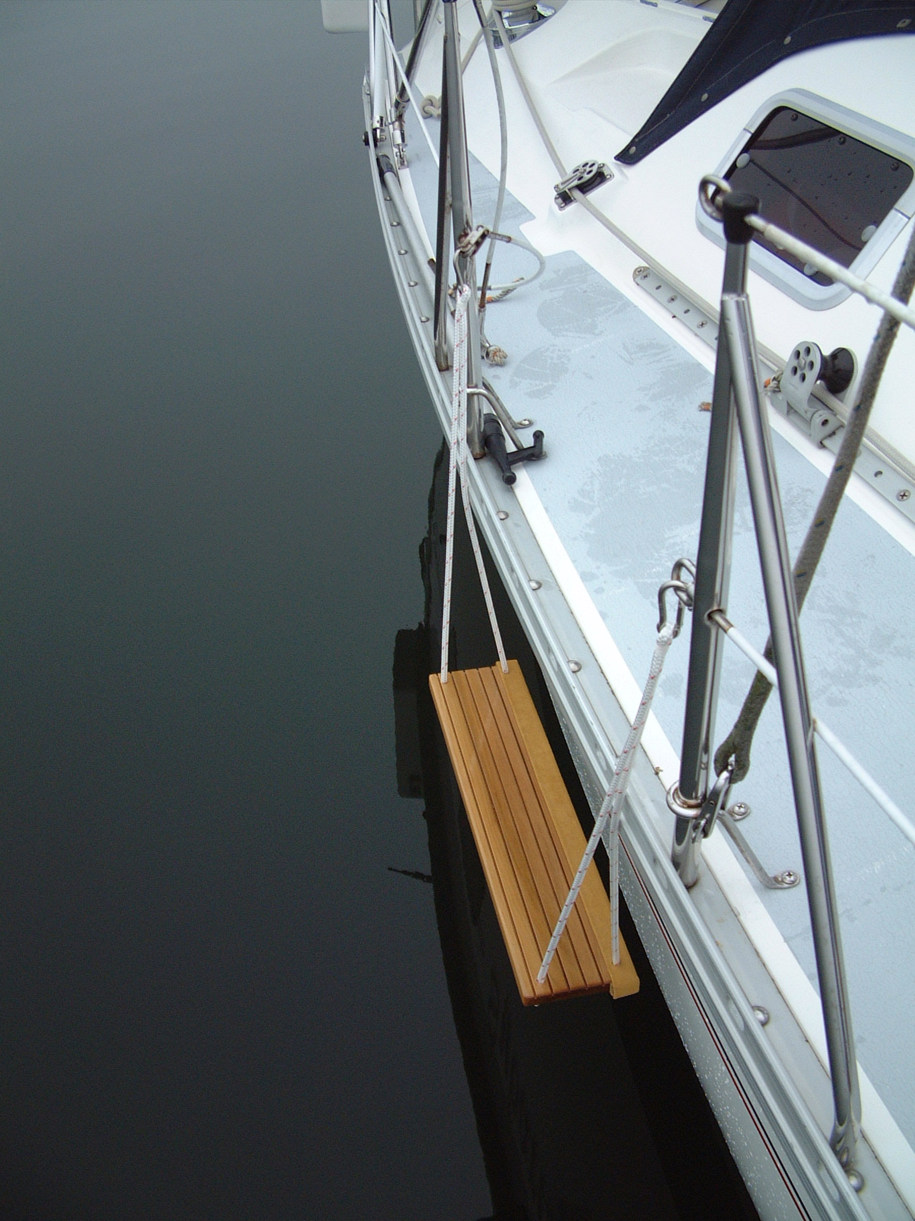

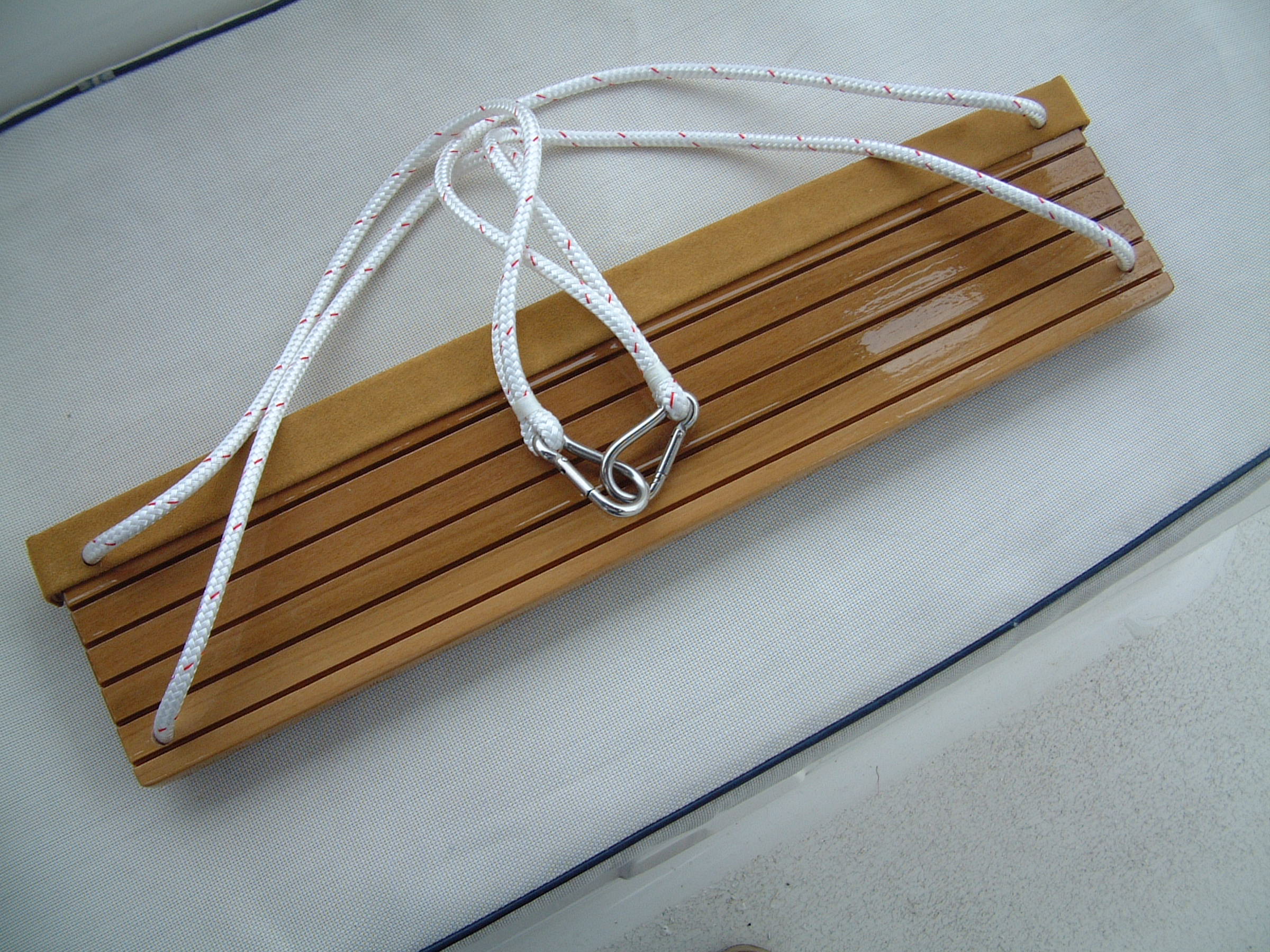

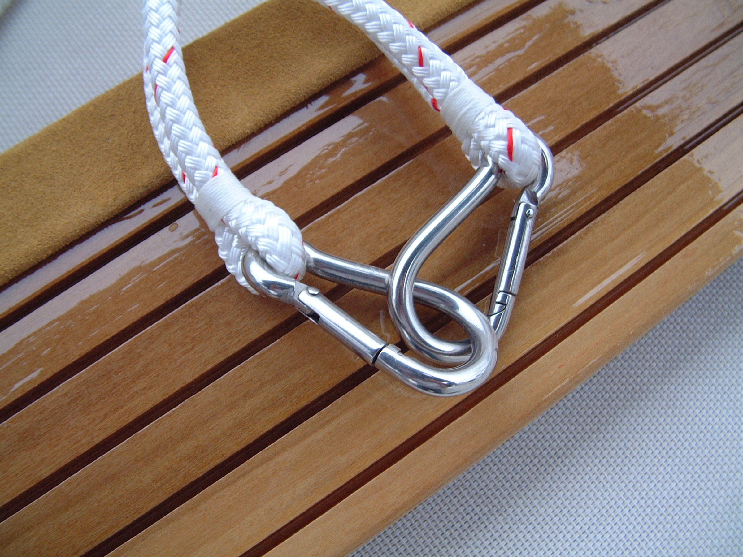

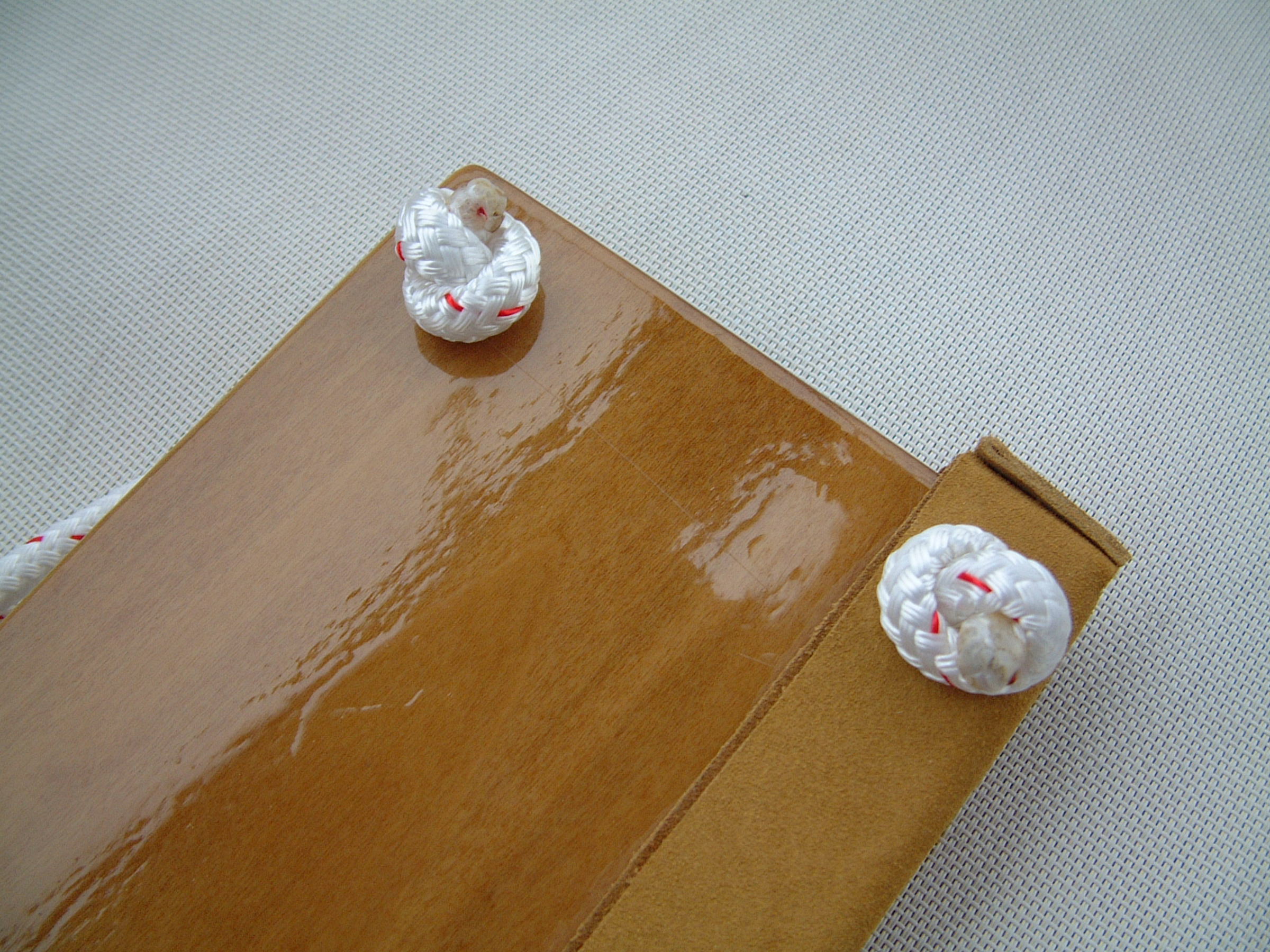

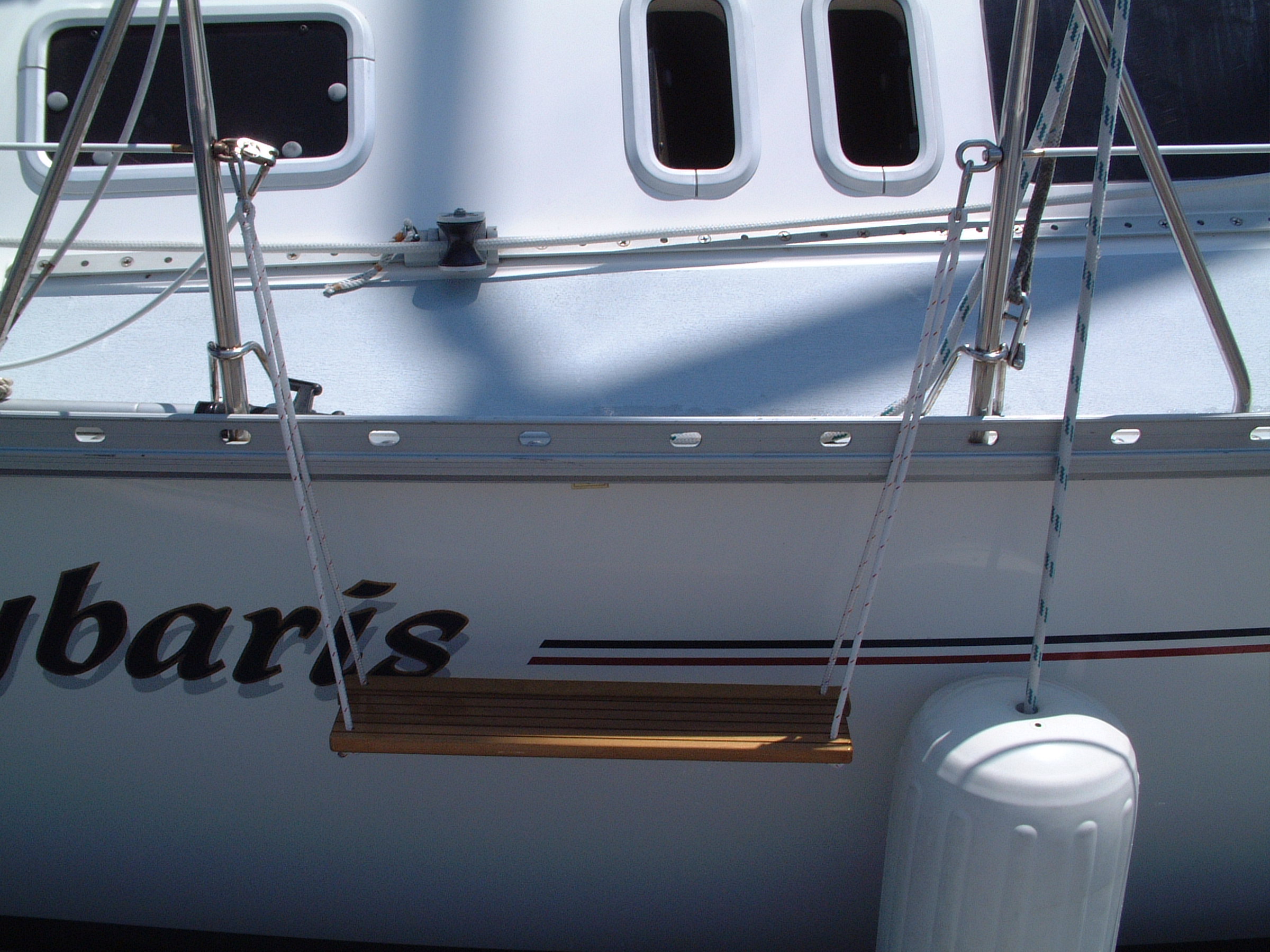

I saw a similar step at a boat show. The vendor wanted about $150 for it. So I went into production and made three for myself and two other sailors - total cost for all three was about $30. I used red oak that I had, bought the line and clips. I covered the front edge of the board that goes against the hull with leather so it won't scratch, and used external polyurethane for the finish.
24,772
Great looking steps. Is it better to hang the steps from the stanchion or from the base/gunnel.

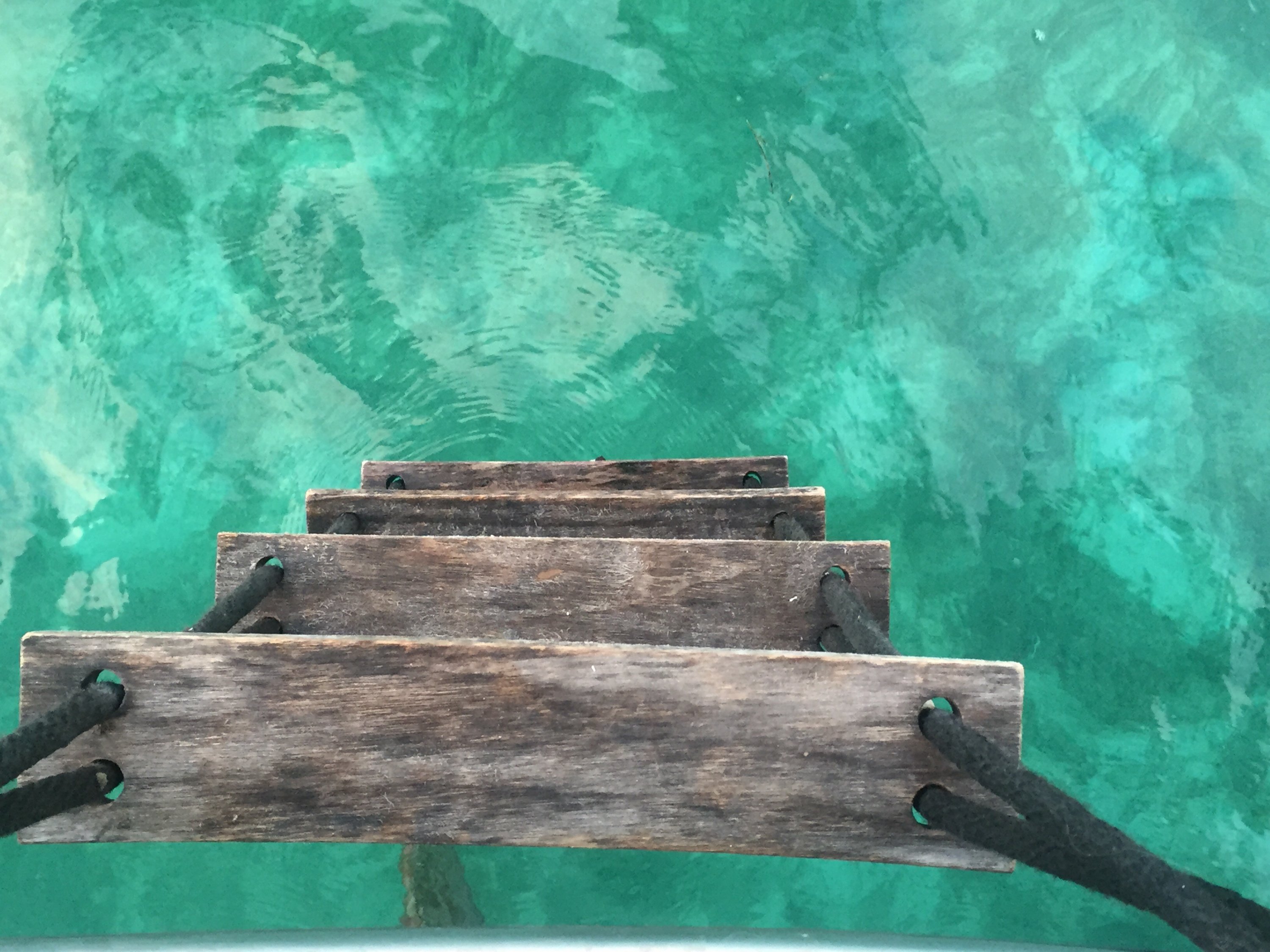

I made this tops ladder after seeing one in the window of a chandler. We use it for boarding from the dinghy at the transom. Maybe I should have put polyurethane on them, too, but they've lasted about 8 years so far without it. I do like the leather idea. How did you attach it?
Yeah, that's what the water looks like here in St. Croix!

Lovely water! I attached the leather with contact cement. It has held up fine with no attempt to detach. If I was going to build another step, I have thought I would add a 2" vertical wood piece to the edge that goes against the hull. This would serve as a toe guard so the tip of your shoes would not hit the hull. The leather would still go on the board facing the hull.
