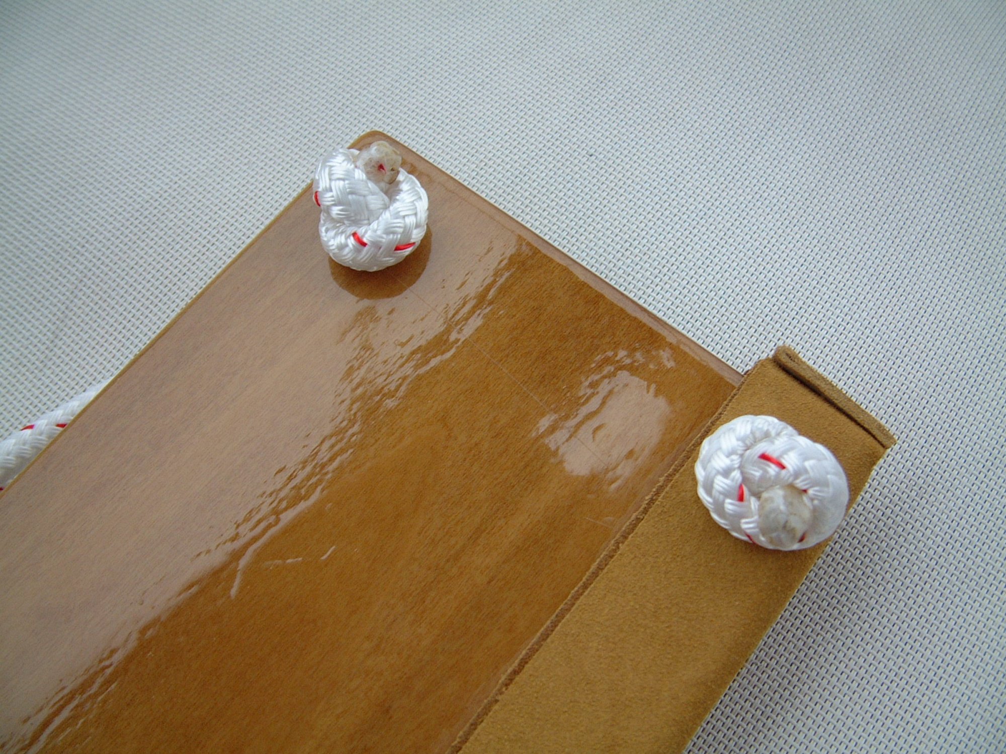

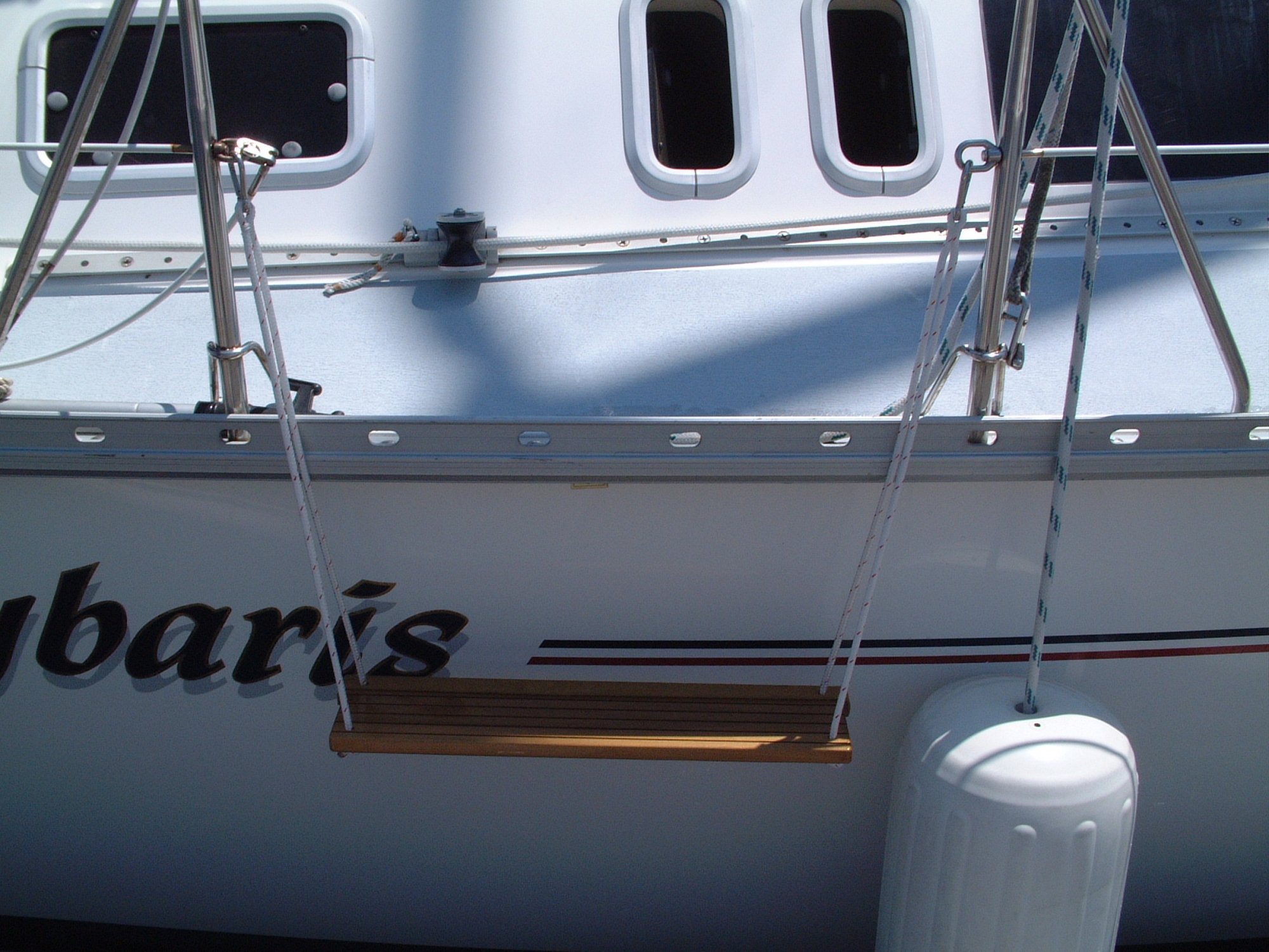

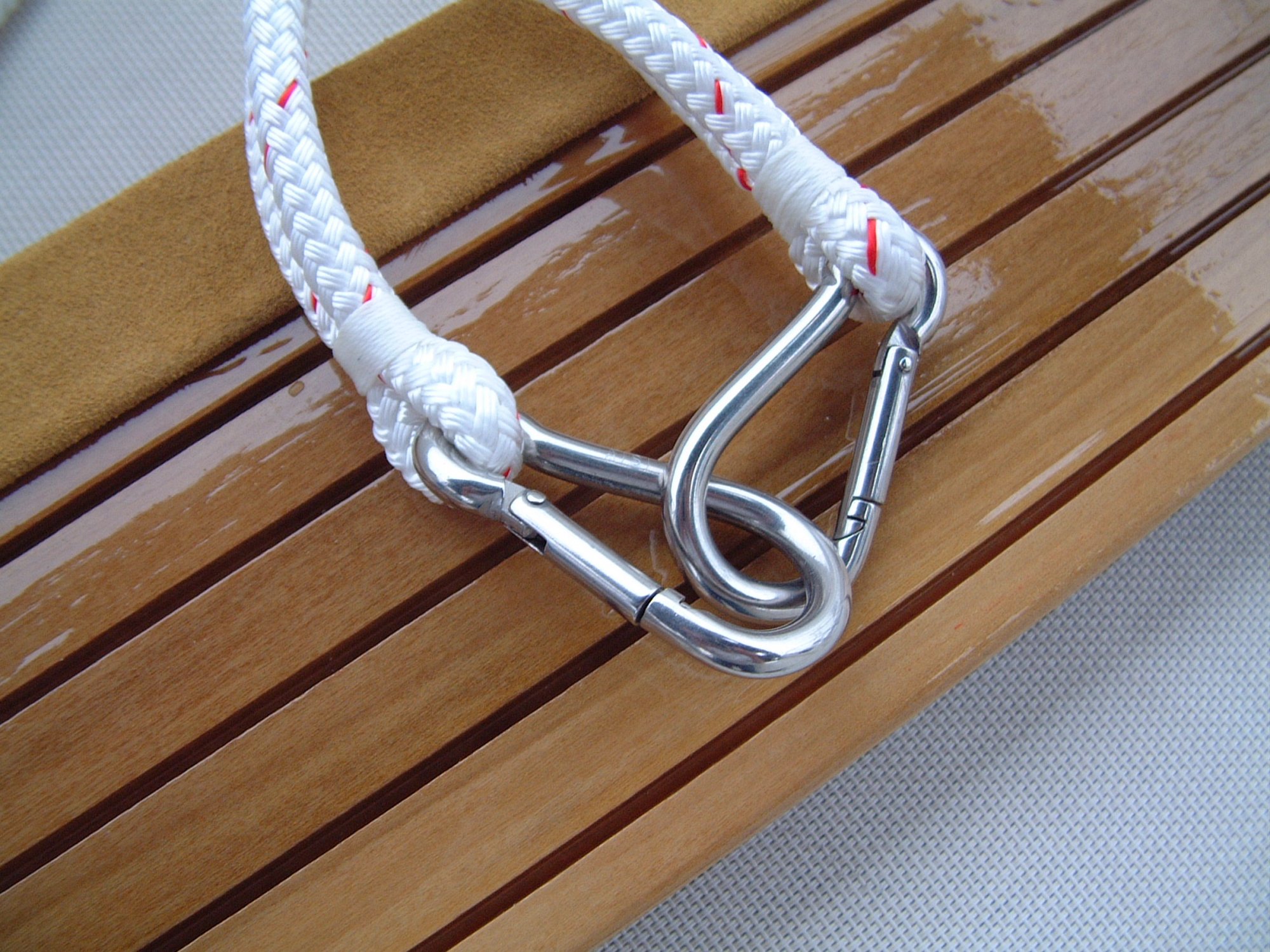

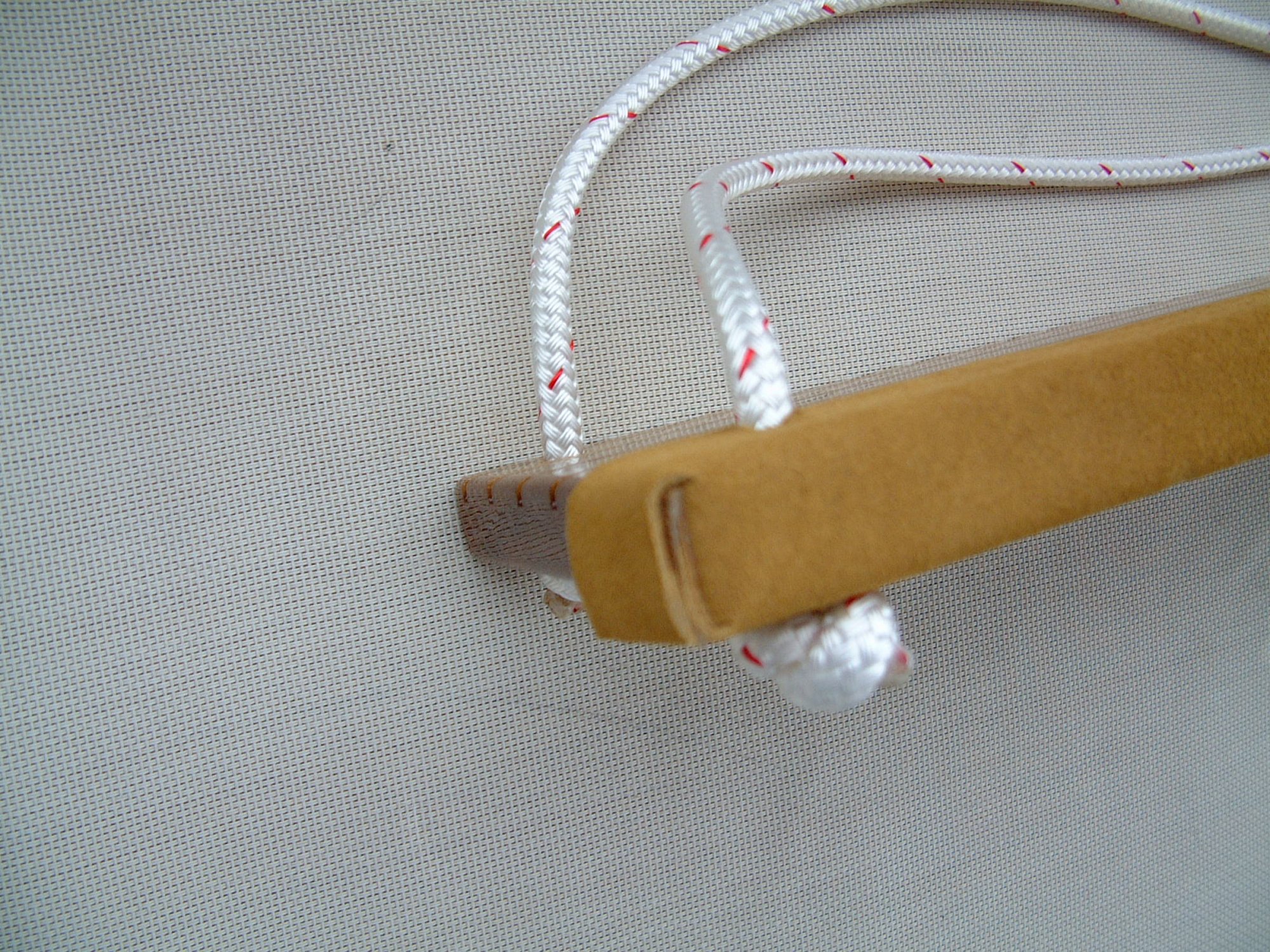

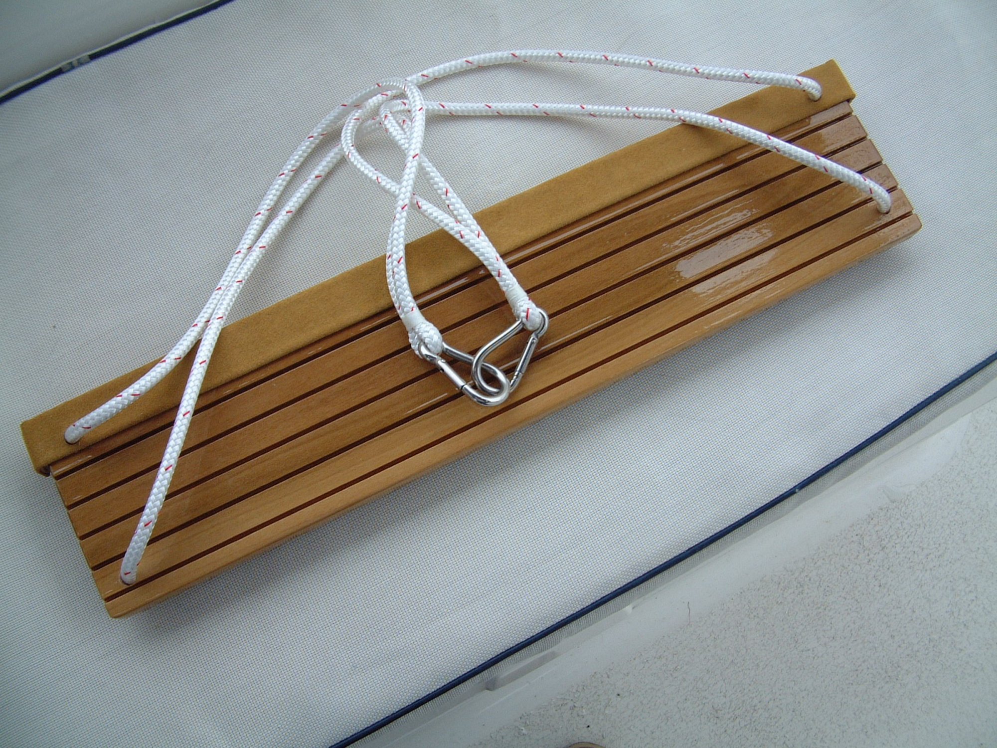

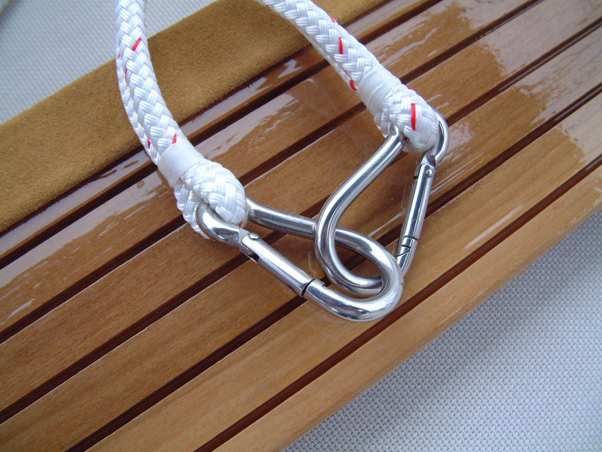

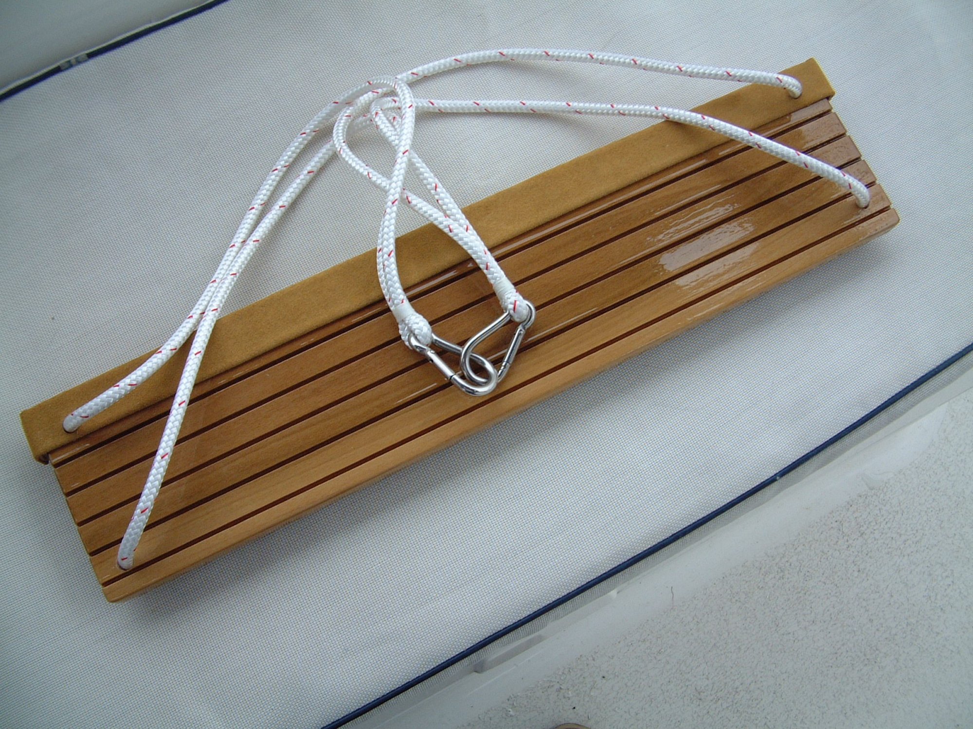

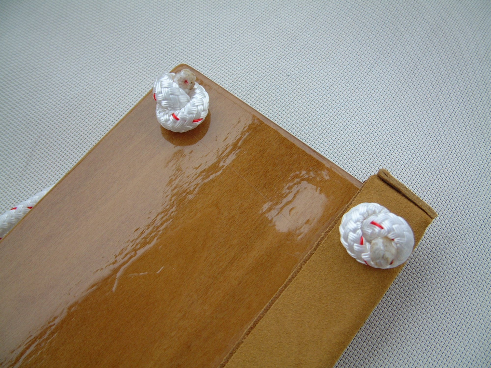

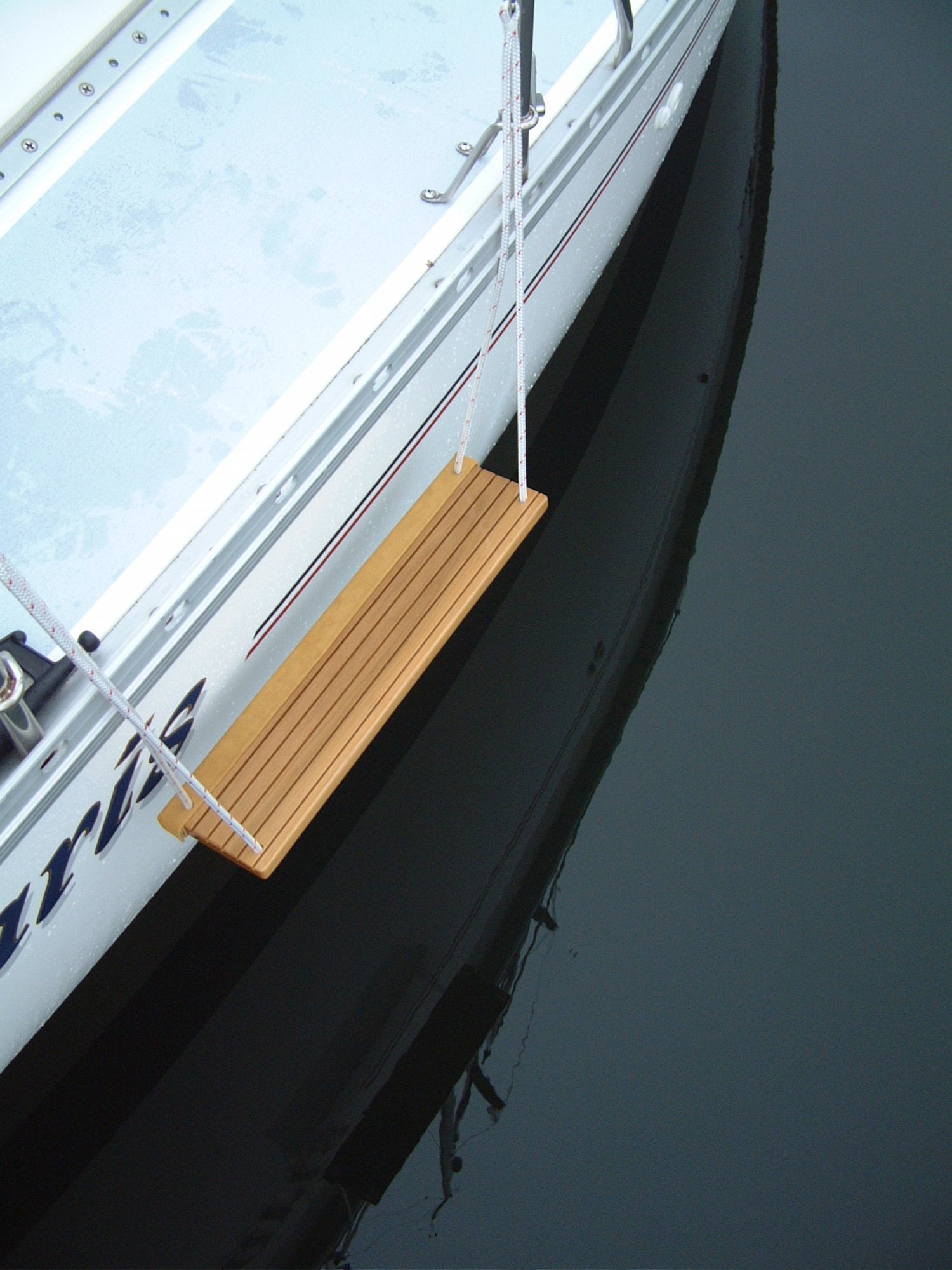

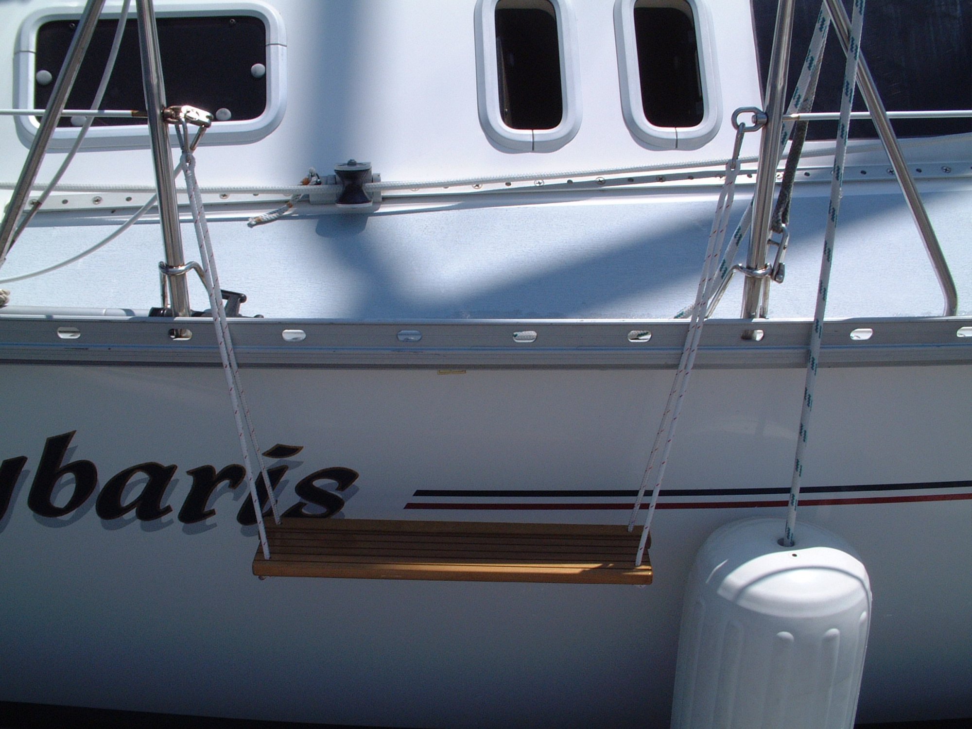

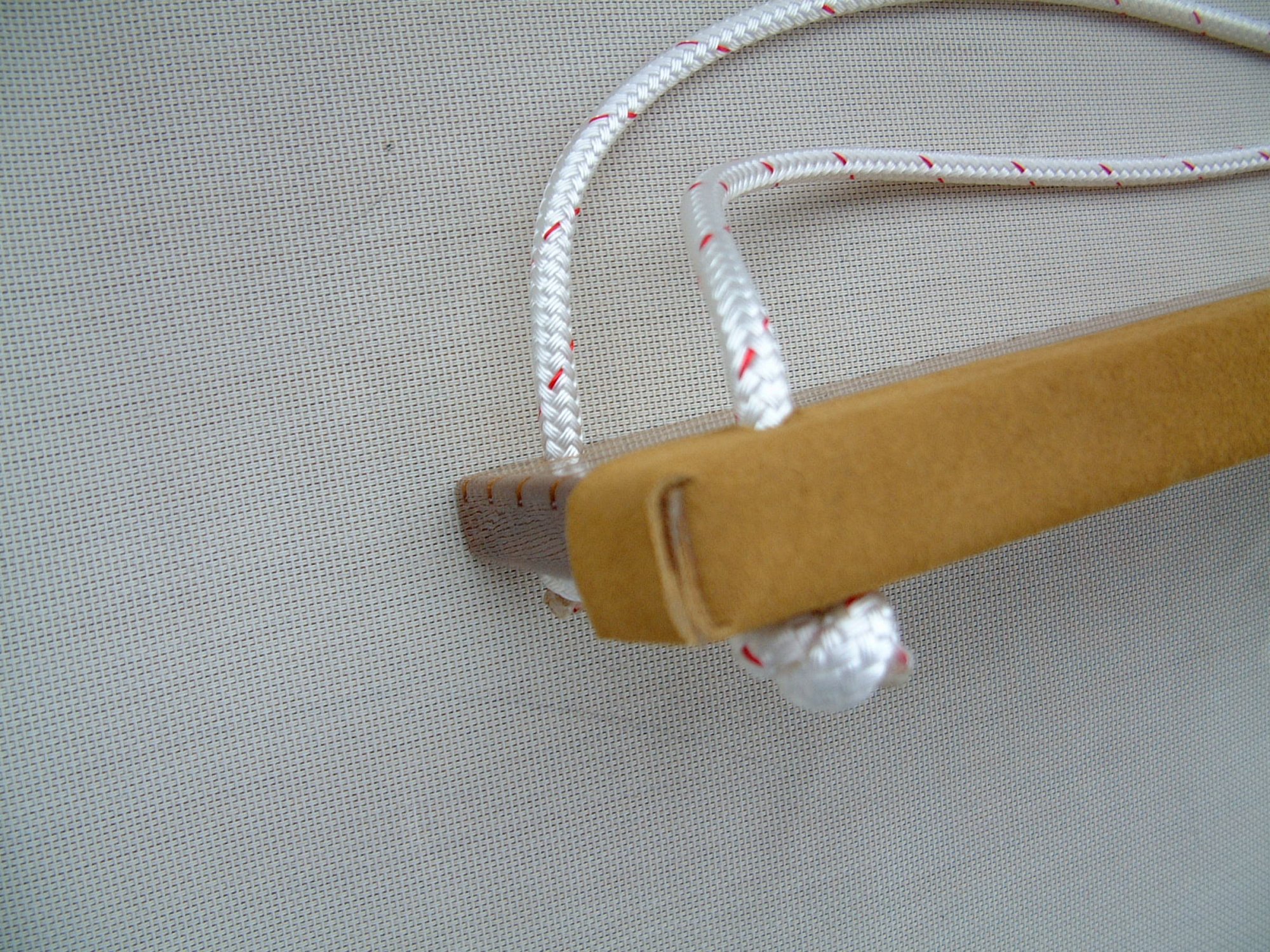

I saw a beautiful wooden step at a boat show but choked at the $175 price. So with $10-12 of materials (each) and a couple hours of effort, I made my own step and two more for friends. I covered the edge that faces the hull with leather for protection.
I use this for stepping off at a dock for fuel or pump-out. At my slip I have a commercially manufactured large molded two-step platform.
View attachment 199867View attachment 199868View attachment 199869View attachment 199870View attachment 199871View attachment 199872
To bridge the gap between ship and shore I use a line tied directly to the dock at the step. Pull in and get off quickly before the wind pushes you out again.
I built ours like Rich, except I used a long (6 inch) stainless eyebolt centered on the board and only connected one line to each end. It worked perfectly. I did add a pad of weather stripping on the boat side to cushion the bumps as we were climbing in. On our boat, there is a perforated toerail (like Rich's picture) so we can attach it anywhere.

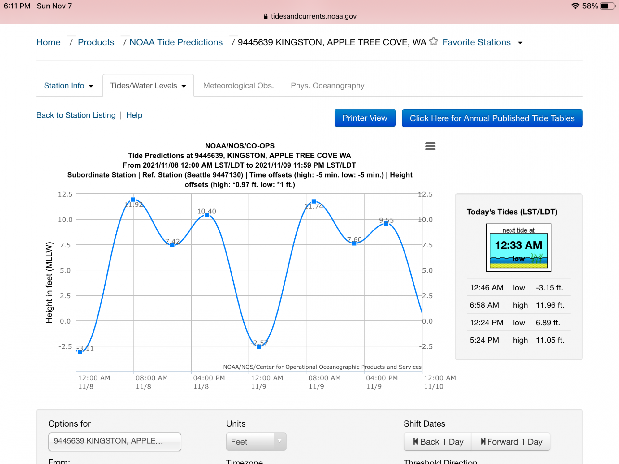

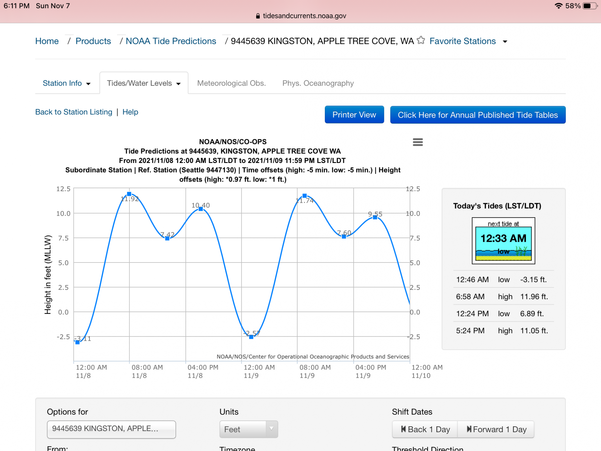

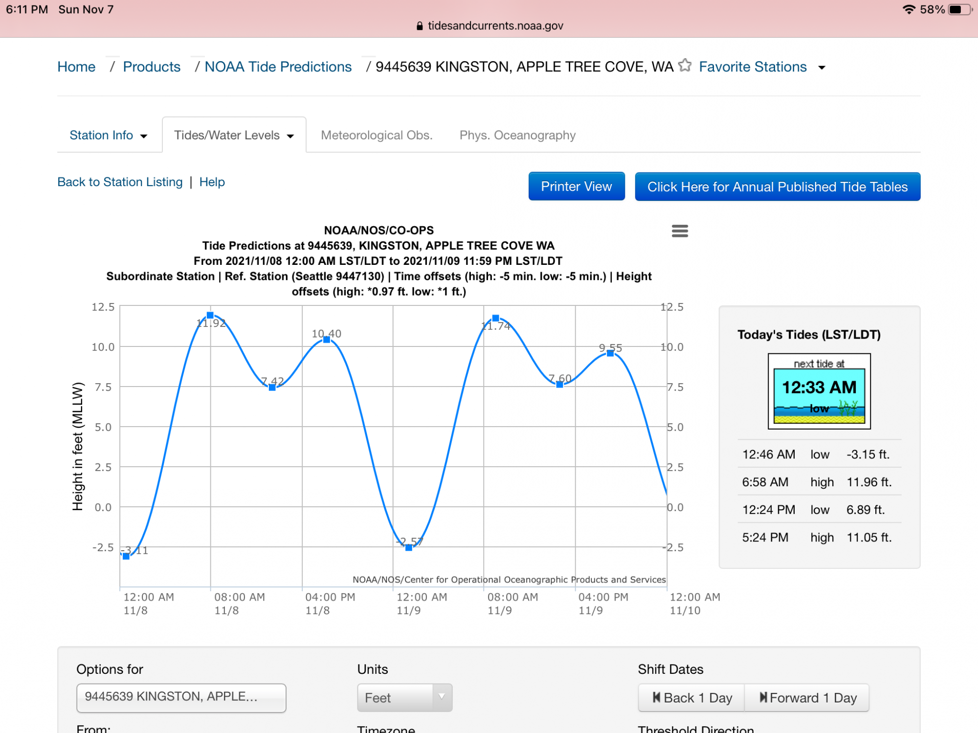

Today I noticed quite a few milk crates and 8 x 10's attached to the finger piers. I guess we're lucky to have little tidal range on the BB.
Ah, yes… those low tidal ranges…
