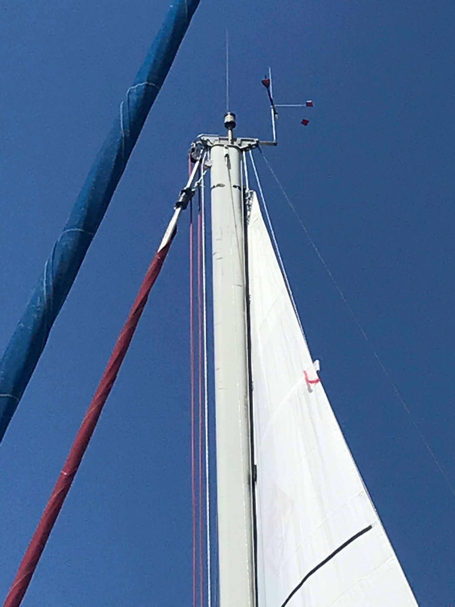

Do you have this part installed below the masthead?
“Harken halyard restrainer with sheave at the masthead prevents halyard wraps”
If you look at the large image, you will see the part, which is included in the harken kit, just below the masthead. If you didn’t install the furler, this may be missing. It will prevent your problem in the future.
