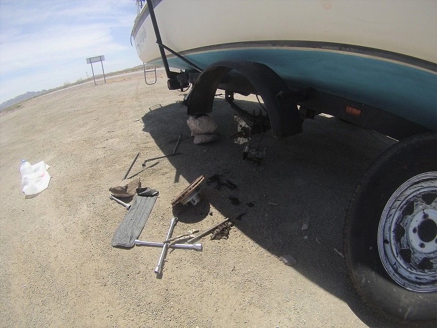

Shit.. I saw this thread come again about the truck jack not being high enough for the trailer.. But of course was in too big of a hurry for the road trip. Spent five nights in Chula Vista marina and drove back today. About 2/3 of the way home, the trailer bearings on one side just seemed to vaporize.. I pulled over to a spot off the road a little with the one tire sitting at a nasty angle. The bearings were just gone and whatever happened seemed to be a failure that happened quickly. I had been checking the axle temps every time we got gas. Anyhow.. we drove just under 100 miles to find all the parts for the fix. I replaced the bearings and races in the spot in the picture.. which is really out in the middle of nowwhere (about 30 south of Quarztsite Arizona). The bearings were new three years ago and had maybe 2500 miles on them.
I had to find some fricken rocks that would stack just right for the jack fit on.. Just a memory now that I can find at least a little bit funny but what a hassle during the moment.. Picture from today.

The very act of blowing your first tire could cause a bad alignment problem that may have had an effect on the other tire. Bearings, etc. all get a workout when pulled just for a moment at highway speeds.
So glad it was just the tires you lost.

Since having my problem yesterday, Im thinking about dual axles. I have the 15 inch tires rated at 2500 each and an axle / bearings rated at 3500 pounds. I dont load the boat at all for trailering and think total weight is likely near 3000. I had greased the hubs before the trip with blue or green (water proof) grease.
So everything should have had some margin for my use. What I dont think I will find out and have some concern about and assuming things are used within rated specs, if you double the number of tires, axles and bearings, do you also double your chance of something going wrong? Or do you reduce the risk. Keep in mind this is for every part used with margin compared to its weight specs. Ive also seen someone with a dual axle travel trailer driving with a blowout and the blown tire was getting warn down to nothing - big trail of sparks. That may have been due so some sort of load leveling suspension. I dont think you can tow very far with either a single or dual axle trailer.. Is this not right? For the same cost in tires, I can also simply replace the tire set twice as often.
So.. I could be wrong but dont think the dual axle for a lighter boat is a slam dunk argument. Dual axle for when you have to to be within operating specs for a heavier load is a no brainer..

Thanks for the opinion, as I said I dont think I will ever find any real data on this. I think with most two axles setups, you are not going anywhere with one tire not working. My experience also is that if the trailer is pulling stable when the tires are good, the trailer will also pull stable with either a blowout, bad bearings, even a tire completely coming off. The other time I have had a problem was because I had snuged up the tire bolts myself and didnt check like at the first gas stop. Nuts worked loose and the tire came off. The boat pulled stable both before and after the incident.
One question.. If you have a grease fitting, how do you grease the axle adequatly for the bearings but not so much that you blow the seal on back side?
walt
Jun 1, 2007
3,556
Walt if you decide to go with tandem axles, I've got extra spring hangers and equalizers (2 sets) that SWW didn't want back. Take the boat to the gravel yard across from College Street and get a real weight on the trailering package. You may be heavier than you think if any water remains in the tanks.
I think I will change something next winter and I should weigh the boat.. but not happening yet as I just tucked it away for the summer. I think part of the problem I had was this complete POS castle nut setup that Macgreggor used on the axle. It was the kind where a flimsy sheet metal part with the teeth for cotter pin slips over a regular nut. The POS castle nut was demolished when I took the hub apart. I also did not find the keyed washer that is supposed to go between the castle nut and the bearing and think that may have been part of my problem. Im the one who put that together a few years ago so cant blame anyone.
