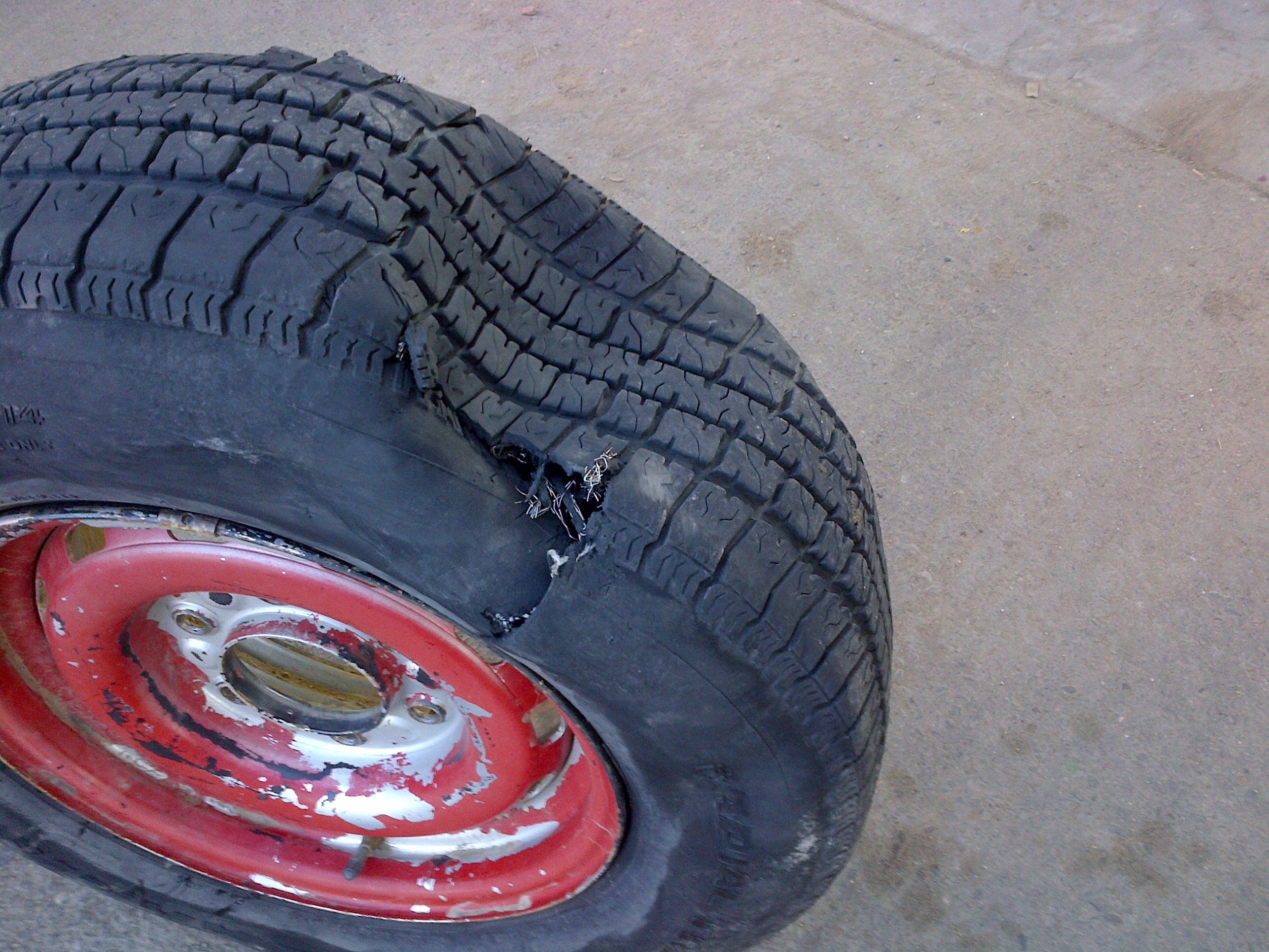

The tire was a 15" Karrier LoadStar, load range D. They are rated at 2,540lb capacity each; the boat and trailer combined weigh about 4100, so I was under the max rating by about 500 lbs per tire. The tire was exactly two years old, with maybe a thousand miles on it. The boat stays parked under a canopy in the shade, so no direct sunlight ever hits the tires when they are not rolling.
Temperature was about 80 degrees. I had the cruise control set at 60 mph. I had only been on the road for 45 minutes. Next thing I knew, that tire completely disintegrated.
Lessons learned! I had been very complacent, AKA "stupid", having too much faith that "good" tires wouldn't blow. I was totally unprepared. (Granted, I do have BoatUS roadside insurance, but still). I soon learned that my truck jack was NOT going to get the job done like I always assumed it would, and I didn't even have the right size lug wrench on hand. Fortunately, I was only 25 minutes from home, and my wife was following me in her Jeep. So I soon had a four-way lug wrench and a floor jack, and all was well.
But from now on, the 4-way and the floor jack go wherever the boat goes (on land, at least!). And I may invest in a second spare tire. If this had happened early on a long trip, I would have been spare-less for a long time.
Just thought I'd share, maybe someone will take it to heart and not make my mistake. :)

Thanks for sharing Gene.... I wonder if you hit something sharp in the road? Glad you didn't suffer any additional damage.

Gene,
Here's a stupid question, did you check the pressure before going? A tire may look just fine sitting in the yard and be down 10 lbs. It'll get really hot, really fast on the road. This happened about 5 miles from the yard. It may not have been inflated enough, and that is now part of the pre-move checklist.

Like Meriachee indicates, check tire pressure. A tired rated at 2,540 lbs. only provides for its rated capacity when inflated cold to the maximum load pressure indicated on the sidewall. It also allows for best heat dissipation; an underinflated tire can build up heat rather quickly. Also check the hubs running temperature as excessive heat build up can transfer to rims and tires. Check the code for the tire's date of manufacture to determine its actual age. Also check suspension travel as bolts protruding from the underside of a fender could come into contact with a tire. Keeping two spare tires might be a waste of money as really spare tires seldom see the road. I usually keep a good but somewhat used tire as a spare. Something to get me back on the road to look for a brand new replacement for the blown tire. Stopping periodically to check tires and hubs temperature is essential.

@Gene Neill now you have the opportunity to upgrade to load range E tires. You wanted new tires this year anyway didn't you? Glad the boat and the driver are all ok. Losing a tire like that is a good warning to us all to never become complacent with our trailers.

@Meriachee ... that's a big 10-4, I never leave the driveway without doing a pressure check. And I stop often to check hub temperatures.
@walt: I'm happy to say the trailer didn't squirrel around at all. It just felt like all of a sudden I was running over something really rough. And of course pieces of rubber were flying all over the place. The trailing edge of the aluminum fender was bent double, but it straightened out easy enough and well enough to not replace it. Also the side marker light was torn off, and I had some skid marks on the hull to buff out.
@LakeShark ... yup, definitely load range 'E' this time around. :thumbup:
