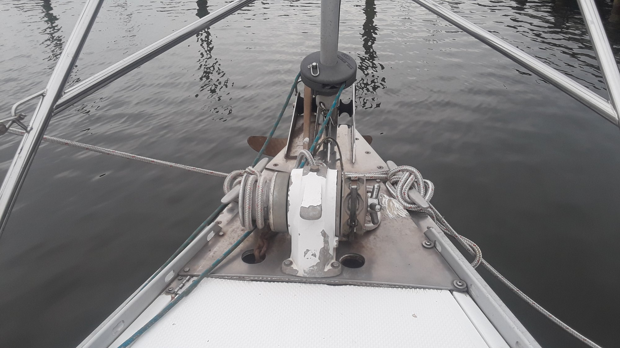

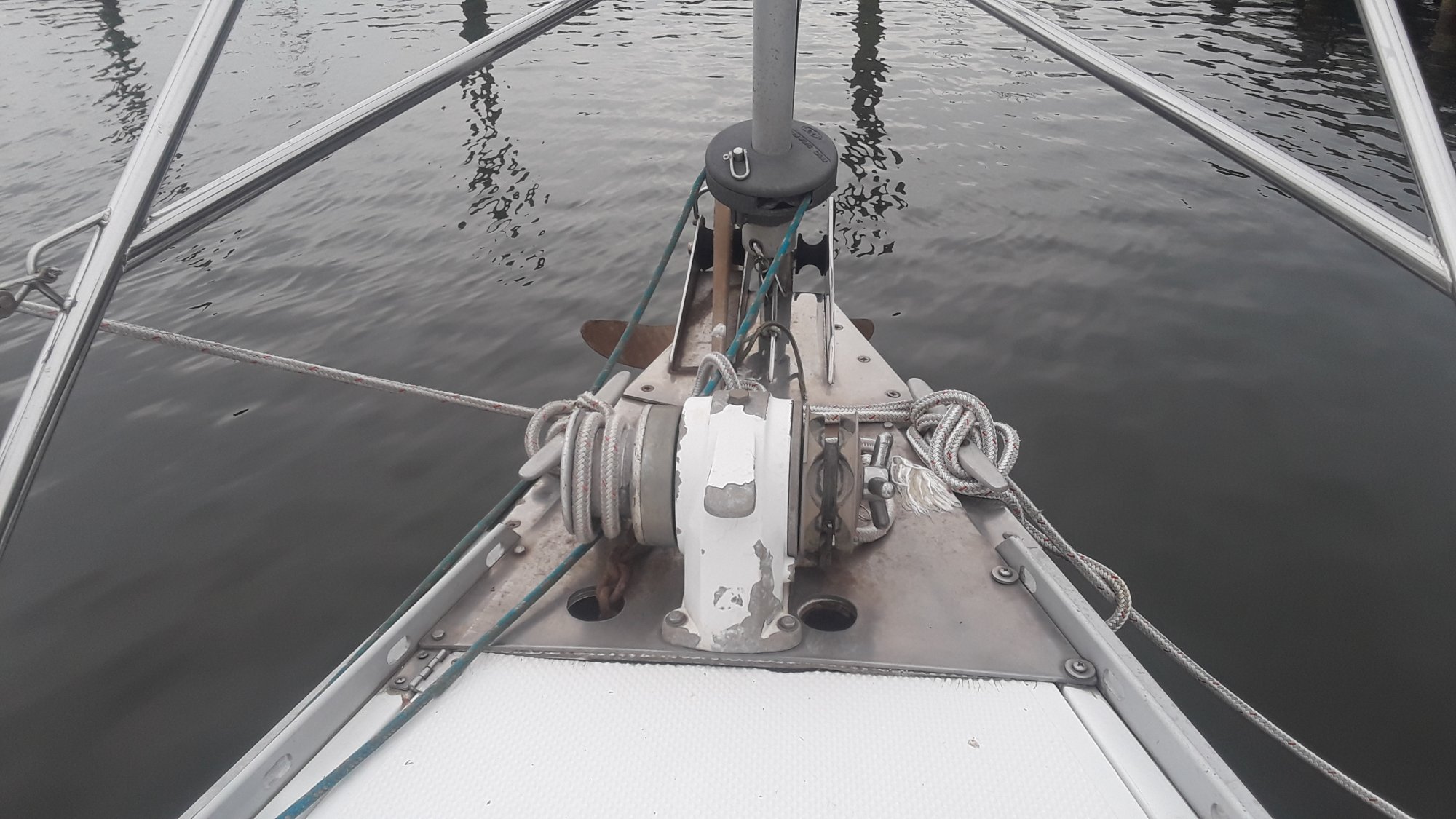

I have a 1987 hunter 34 the previous owner installed a manual horizonal windlass and did a poor job. (the picture is before repair) The steel plate that the windlass was screwed into the fiberglass which cause water to leak in below the V-berth. Also the locker door was not sealed and water destroyed it. This was all removed, and holes were filled and sealed, and the plate was installed to the tow rail with two stainless steels plates; the door was repaired and sealed. I have 50FT of Chain and 200 ft of rode.
If you are interested, I can get pictures of completed job.

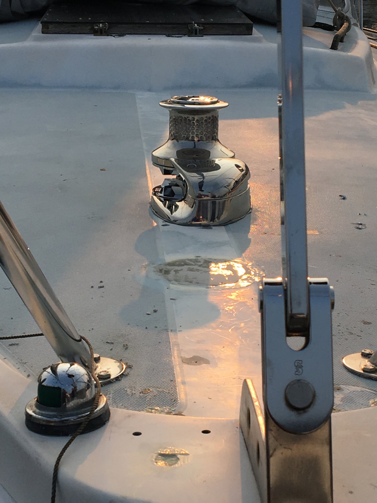

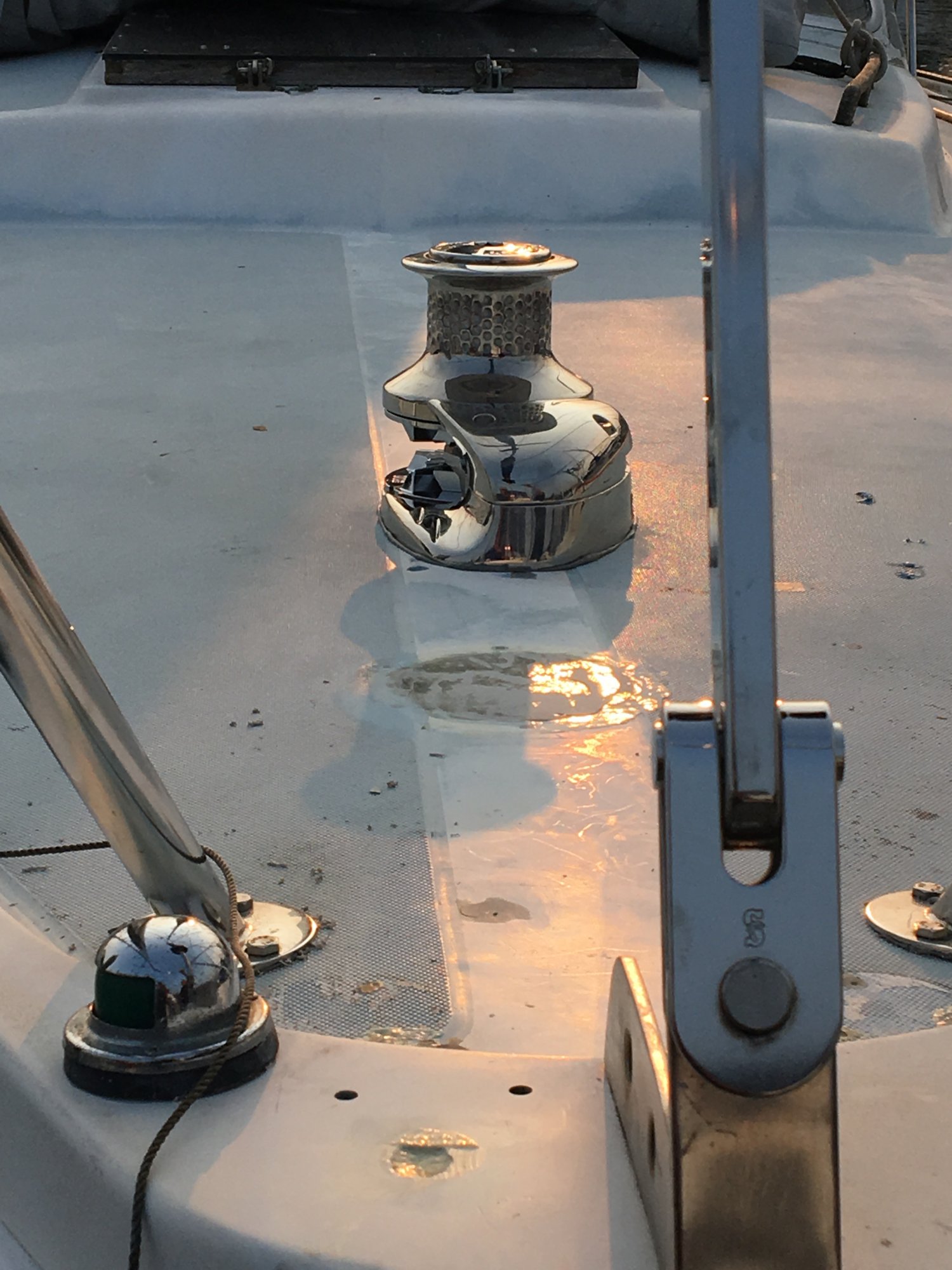

Thanks for everyone's advice. In the end I've gone with a similar approach to many others:
  • Split the door.
  • Mounted a 3/8" aluminum plate with 1/4" plate ears on it through-bolted outwards to stainless backer plates.
  • Put the partial door (with the balsa core stripped off of it) on the plate and filled the void with FRP resin.
  • Installed a Lewmar Pro-Series 1000 on top of the now-fixed section of door.
  • Did a fair bit of FRP rework to make pretty edges on both the fixed and moving sections of door so the whole thing looks intentional.
  • To my pretty complete amazement, 50' of 3/8" chain and 250' of rode fits with LOTS of room to spare. I really didn't think it was going to fit before I tried it.
  • I mounted the switch that comes with the windlass inside the locker, near the top on the starboard side, and also installed a cheap remote handheld switch ($35 or so on Amazon). The breaker is on the back wall of the forward cockpit cubby on the starboard side so it's easy to get to and very close to the batteries.
No pictures as I'm away from home at the moment. If anyone expresses interest I'll post some later.
I like that toe rail mounting for the windlass. It looks tidy.
