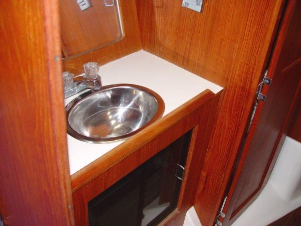

The mirrored slider panels in the vanity and head on my 34 were pretty rough. Doesn't look too nasty in the image, but you can see how the reflective film was flaking off the edges. A big chunk of the reflective film was missing out of one panel above the view shown below.
The head was worse. (sorry no pic)
I simply pulled out the panels, measured and ordered pre-cut replacements from Tap Plastics here.

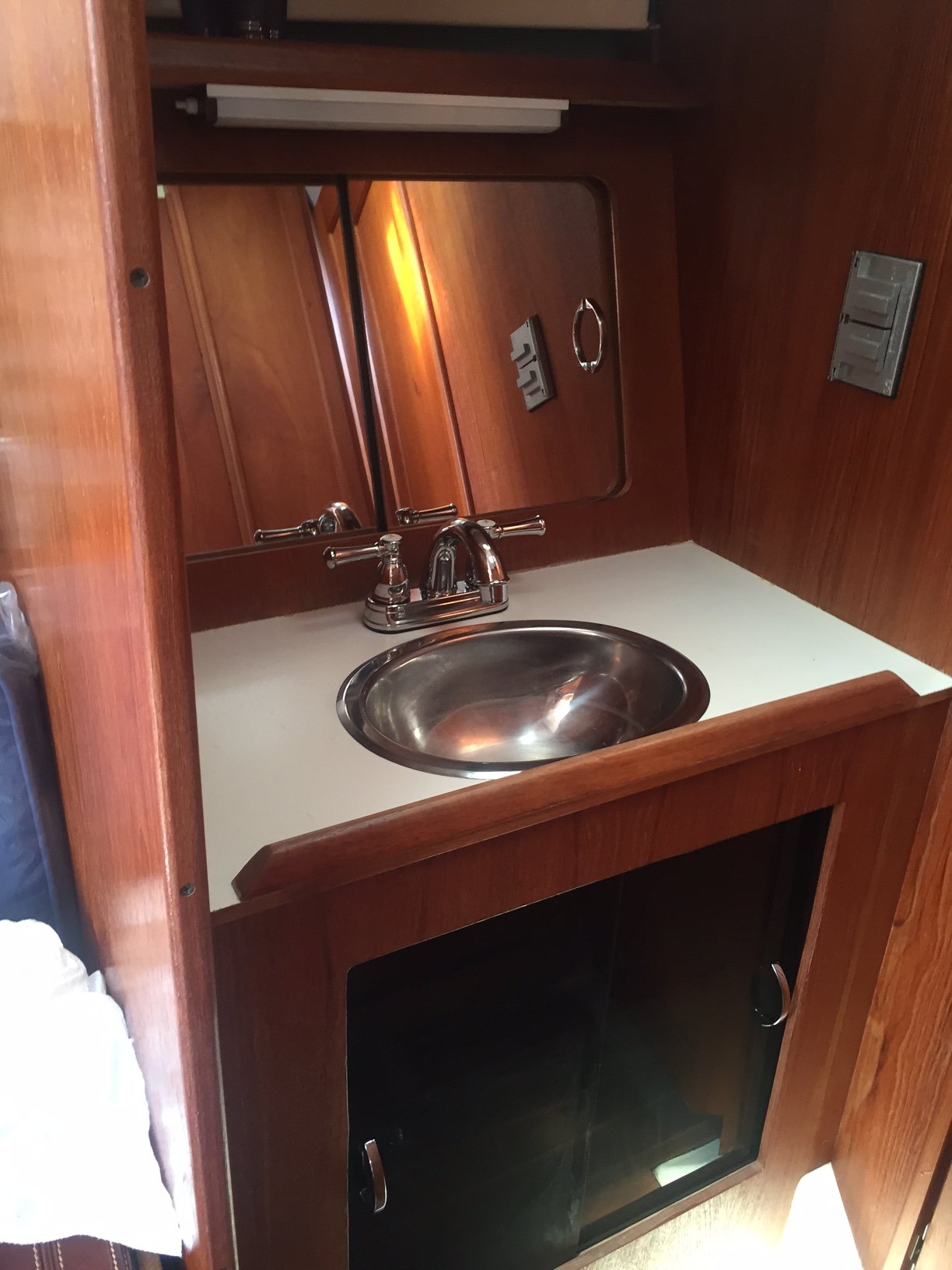

It's an inexpensive RV faucet. Not as substantial as a standard, but took maybe 10 minutes to install.
$32.95 from Amazon. Link here.
10,195
Quick note.. The shower diverter shown just below in the link works perfectly to replace the original. No modification necessary. My original cracked last year and I replaced it with that diverter..

This thread is going to cost me money. I showed it to my wife. I now have to do the mirror panels. And the faucet. And the shower diverter. And the galley faucet to match. Brushed satin. Oh, and the vanity sink, too (we have what is probably the original enamel sink).
Is that the original laminate? If not, how do you replace it without totally dismantling the interior of the boat? I'd love to do the galley laminate, but it looks like a nearly impossible project.
