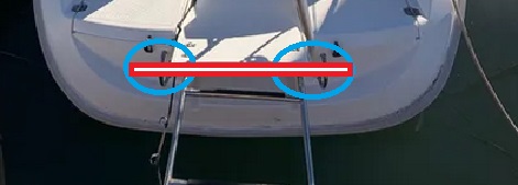

An outboard will be underpowered, in the wrong position and will not be in the water low enough, even with a super extended version. I had an O'Day 25 with an inboard that was unreliable so I installed an outboard. The outboard was mounted too high so it exacerbated the issues I'm about to describe. Your transom looks like it would force an outboard to be mounted much higher than on my O'Day.
A typical outboard is mounted to the side or in back of the rudder. This makes for sloppy steering because the thrust continues to push the boat forward instead of having 50% or more of it directed by the rudder in the desired direction to assist steering. Sailboats don't like to turn to begin with so that doesn't help matters. Acceleration will be drastically affected as you can imagine. a 10-15hp motor is typical for a small dinghy weighing less than 1000 pounds. Your boat is at least 10-15k. The two big issues I see with this maneuverability in a timely fashion. Can you get enough speed to steer the boat before the wind pushes you or that big freighter crosses your path? The other big issue is stopping power. It's a guarantee that someone will cross your path or cut you off. You wont be able to stop very quickly with an outboard. It's underpowered and the prop won't generate much torque compared to a full sized three blade prop.

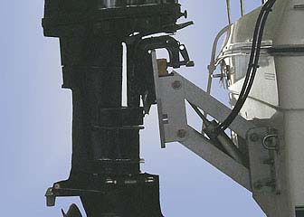

I would be using a jackplate that would keep the 25 hp outboard (or equiv elec) with a longshaft out of the water while not being used and then would lower down into the water when needed. As far as steering ,my thoughts were to use remote controls and mount them outside the cabin hatch entry.Again this is just a backup emergencey kicker "made it back to the dock" option .The boat has a electirc inboard that will be its main form of propulsion

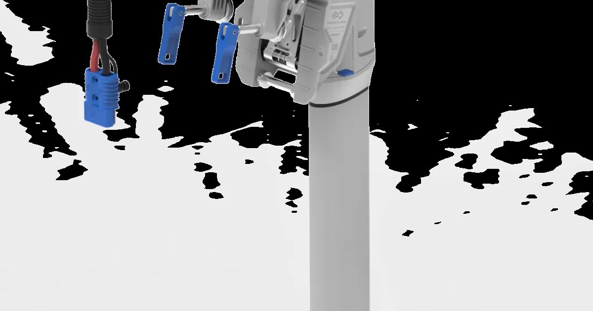

You might look at an ePropulsion Navy unit. They have the type of power you will need to move your boat. They are good on a pontoon boat. With the Battery stored power you indicate, an electric outboard would be better than a gas-powered system. No need to have the gasoline on board.
EFFICIENT LONG-RANGE OUTBOARD MOTORS

It has been discussed. Most people think an outboard hanging off the back of a medium or large boat to be an eye sore. Diesels are pretty reliable and will go 10-15k hours between overhauls. However, the real reason is that they don't work well in this application for the reasons I mentioned earlier. The closest analogy I can think of is an inboard is like driving on the road. An outboard will be like driving on wet grass or maybe snow (there's many different types of snow for those that aren't from northern climates).
