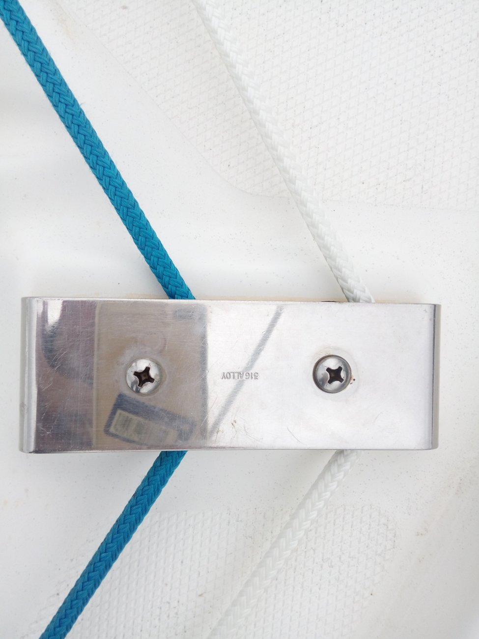

Zoom in on this picture. I have a 2-story double-sheave organizer. There’s no more room on the embedded plate for a third set of sheaves.

Cheers for the info Kermit. The embedded plate was also my worry. Do you know if it is just a single on top of another or is it actually a double because I've never seen one. It does look quite a neat affair and not to much of a toe stubber.

...Do you know if it is just a single on top of another or is it actually a double...
Ahem. You really think I know that much about my boat? I *think* it’s a true double but I honestly don’t know. To show you how much I know, I honestly thought it was a triple sheave double decker... Until I found the picture. Seriously, I’m not much of an expert on anything boat-related. My greatest boating achievement is always returning to the same slip with all crew alive and well.

That appears to be another two sheave deck organizer on top of another but with longer screws. I cannot remember if I installed it or the owner. Should be a Schaefer but if not a Harken
The easiest way for me is to put the port side organiser on top of the stb side and the buy a new one to replace the one I have robbed. I just can't find one to match the screw spacing of the original, that's when the manufacturer or/and chandler can be bothered to even list the spacing measurement . . . . they don't deserve custom.
Or I may fit a cheek block?
10,442
-na -NA Anywhere USA
Although the manual lists deck hardware, it does not give the manufacturer. If memory serves me, the two deck organizer was a Schaeffer marine deck organizer and I believe it is the series 5 with reference to 505-80 as the Harken one is different..

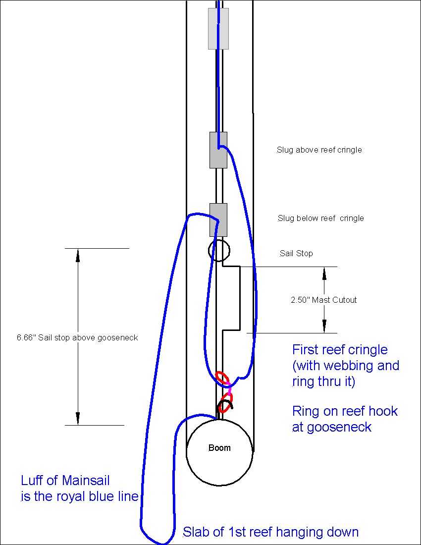

It's not necessary to remove any sail slugs from the mast track to reef, as long as the slug/slide above the reef cringle is high enough. You only have to get the bottom of the "slab" down far enough.
A careful sailmaker will ask you for measurements about the feeder slot and install the slugs/slides so you can get the reef grommet very close to the top of the boom. Since slugs and slides are usually spaced anywhere from 20 to 30" apart (+/- a few inches), it's not hard to accommodate a feeder slot and sail stop.
If you have a reef horn, put a "floppy ring" through the reef grommet. That's a ring on each side of the sail, connected by webbing or line. It's much easier to put the ring on the horn than to wrestle the grommet onto the horn.
If you're using a line rather than a hook for the fowrad reef line, do NOT put the line though the grommet, trapping the sail slides . Run it up one side of the sail to a ring or block at the reef, and back down on the SAME side.
See drawing below. (PS, I apologize for the crude drawing, I did it about 15 years ago with primitive software. It's ugly, but it gets my point across.)
Here's a drawing to show floppy rings. in Fig. 14. I don't remember where it's from so I can't give proper credit.
Judy
Thanks for this informative posting.
Could you expand on your "If you're using a line rather than a hook for the fowrad reef line, do NOT put the line though the grommet, trapping the sail slides . Run it up one side of the sail to a ring or block at the reef, and back down on the SAME side."comment? Is this H260 specific guidance? I ask because I have recently acquired a boat that has a two line reefing system that the original owner set up. The forward line in my case is attached to the mast, passes through the reef grommet and then to a small block and cleat system on the other side of the mast. I can of course alter the setup but can't visualize the problem created by going through the grommet.

While waiting for DrJudy to reply, I think that advice is to reduce friction as the line pulls down through the grommet. If you can reef easily with the line sliding against the lower surface of the grommet with your 2 line system, I don't think I'd bother to change it. But if friction is a problem for you, securing a block or appropriate ring at that grommet and letting the line roll around the sheave would make it easier.
Sep 22, 2018
1,869
Hunter 216 Kingston
Thanks
I am sort of assuming it has to do with friction reducing, what I’m having trouble understanding is how the slides get trapped or not. Maybe a seniors moment but can’t visualize.
