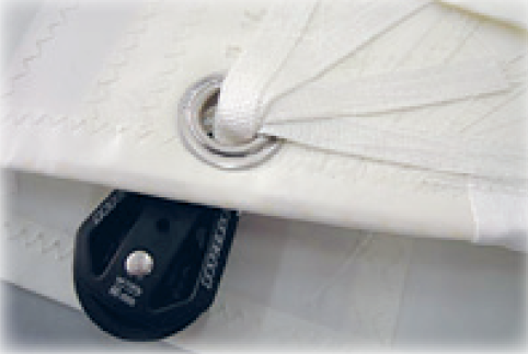

I'd suggest using very light weight composite blocks at reef points, rather than clew blocks. Clew blocks are very much more expensive and weigh more than a reefing block needs to.
Heavy blocks make the cloth flog harder, which breaks down the sailcloth faster.
I'd pick a block that attaches via webbing or lashing. Like the Rutgerson webbing block shown below (around $20-25 in a 50mm size and 112 gms weigh) or a Harken T2 (around $40-45 for a 57mm block, but only 57 grams)
From Rutgerson's sailmaker's catalog:

Not sure of your sail/boat size but a cheaper alternative is to have one or a pair of flat looped tapes stitched to main so they pull from different directions so to spread the load. The loops want to just pass through the cringle say from stb to port side so you can get a shackle through the loops and just hang a plain pulley block that will suit the sail size.
Dr Judy has beat me to it with a perfect photo of what I was trying to describe.

Well it looks like I’ve found a winter project. Next step will b to find a sail loft somewhere close to Arkansas. I have an H26 and I think the rest of what I need is already in place. I’m new on the docks at Eden isle but I bet someone will point me in the right direction. Dr Judy your picture and info will make this both doable and enjoyable. You too Gunni. Thanks all. Rog

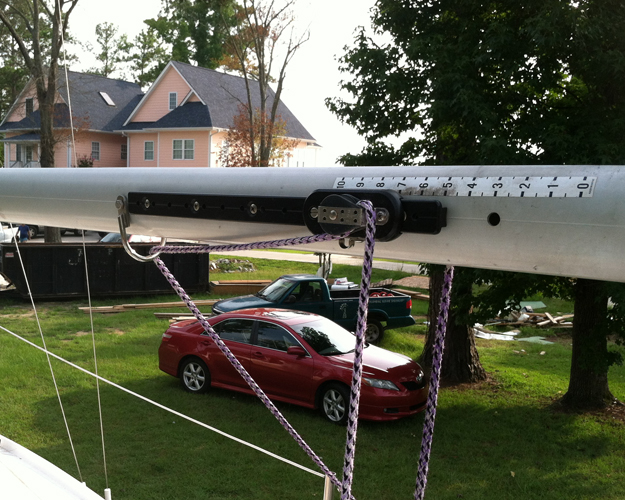

Oh, I do have this on my boom. But even with the picture I can’t get it rigged back the way the guy I bought it from had it. The purple line is the reefing line.
Nov 10, 2017
258
Hunter Legend 260 Epidavros
View attachment 163175 Oh, I do have this on my boom. But even with the picture I can’t get it rigged back the way the guy I bought it from had it. The purple line is the reefing line.
I sort of get this even though a little over done with the track, what do you have at the gooseneck end of the boom, the same?
