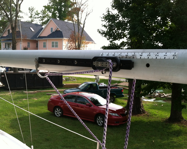

I sort of get this even though a little over done with the track, what do you have at the gooseneck end of the boom, the same?
There’s a mast at the gooseneck end of the boom. I know that sounds snide but basically that’s all there is. And I have to drop a fair amount of sail out of the mast gate to hook the grommet onto the hook. It’s a pain.
Nov 10, 2017
258
Hunter Legend 260 Epidavros
In that case I do feel as though that the tracked cheek block was used for something other than any single line reefing system or dual line for that matter. Unless someone knows different?
And I sympathise with you having to go to the mast head to reef. For me this is not acceptable.
Kermit
Jul 31, 2010
5,657
And I sympathise with you having to go to the mast head to reef. For me not acceptable.

Kermit, are you trying to figure out if you can rig single line reefing so you don't have to visit the mast? Do you know if the PO actually set it up that way, or if it is like your prior 23, which I assume had a single line that only handled the aftmost reef points? How many reef points does the main have?
Kermit
Jul 31, 2010
5,657
Well, I wasn’t trying to figure it out. But it’d be great if I could do that. The bigger pain than going to the mast is removing part of the sail from the track so the grommet will fit on the gooseneck.

Not being in the position just as yet to be totally sure but the way I see it. At the moment I can't see the sail/track slugs being an issue. Put the boat into wind and I feel the slugs will shake themselves quite easily with the draw of the reefing line, especially if they and the track are kept clean and with the aid of a light spray of dry silicone.
On a single line or two line reef you do not have the hang the forward cringle to the rams horn, the sail would hang from the reefing line blocks which would be as DrJudy has shown very clearly on her post #23.

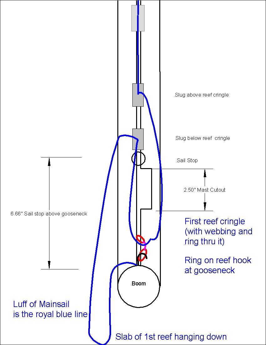

It's not necessary to remove any sail slugs from the mast track to reef, as long as the slug/slide above the reef cringle is high enough. You only have to get the bottom of the "slab" down far enough.
A careful sailmaker will ask you for measurements about the feeder slot and install the slugs/slides so you can get the reef grommet very close to the top of the boom. Since slugs and slides are usually spaced anywhere from 20 to 30" apart (+/- a few inches), it's not hard to accommodate a feeder slot and sail stop.
If you have a reef horn, put a "floppy ring" through the reef grommet. That's a ring on each side of the sail, connected by webbing or line. It's much easier to put the ring on the horn than to wrestle the grommet onto the horn.
If you're using a line rather than a hook for the fowrad reef line, do NOT put the line though the grommet, trapping the sail slides . Run it up one side of the sail to a ring or block at the reef, and back down on the SAME side.
See drawing below. (PS, I apologize for the crude drawing, I did it about 15 years ago with primitive software. It's ugly, but it gets my point across.)
Here's a drawing to show floppy rings. in Fig. 14. I don't remember where it's from so I can't give proper credit.
Jun 25, 2004
1,108
