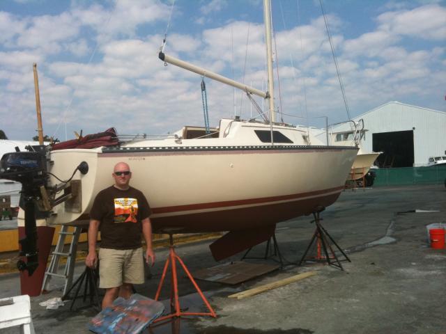

My H22 sits in the water year round, but when I have hauled it out for maintenance I noted that my keel doesnt snug up all the way. Mine hangs down as you described also. I would bet that if you were to suspend yours, like when doing a haul out (i dont have a trailer to put it on), it hangs all the time. I bet that it only snugs up cause its resting on the trailer.
ps - nice drawing ;) I will see if I can dig out a pic of the last haul out.

Jun 16, 2010
495
In search of my next boat Palm Harbor, FL
Photo as promised.
No offense to the artistically challenged. I have a BFA, so dont ask me to do math. As you will see in the photo I am follically challenged.

One more consideration, the swing keel is designed to be bouyant. thus, when at the mooring, there is some assistance to help the keel back up into the trunk. Hence the "haul-out" picture of the sagging keel from Inarathree is somewhat misleading as there is no bouyant force acting on the keel.
