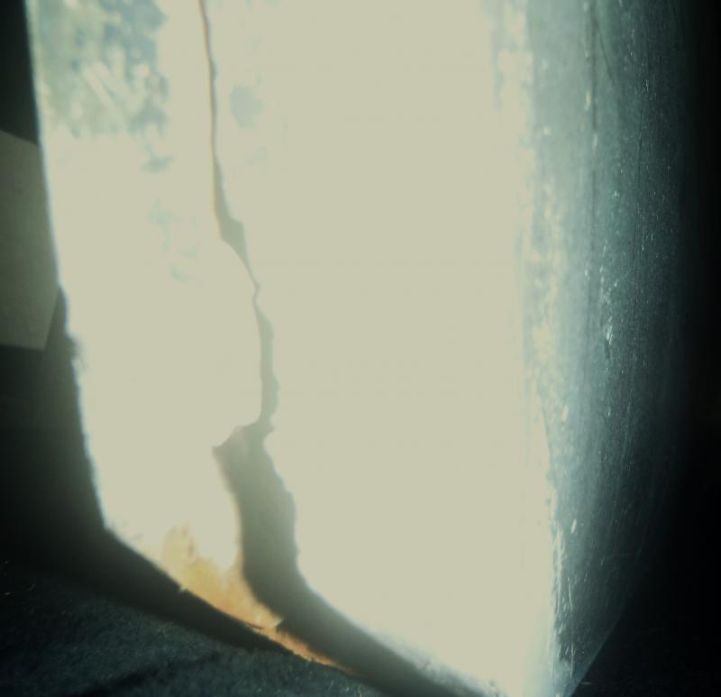

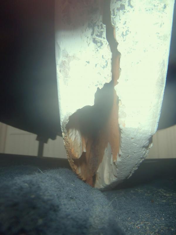

I have an issue that I hope I can get some advise for. I have a 1993 Hunter H 19 (19-2) and the bottom trailing edge of the keel is splitting, that is not what I am asking about (unless you feel like doing some glass work).

It should be a fairly straight forward repair. There is a keel pivot boat for the keel blade. Locate that, jack and support the hull above the trailer, remove the bolt with the blade supported and then lower the blade.
It looks like you might need to replace your keel blade if that crack is as big as it appears.

If this is a water ballast and I would assume so, there are a couple of things to consider which are important. Everyone calls them a swing keel but the correct terminology is Swing Centerboard as the ballast is the water ballast itself in the tank.
If the centerboard has cracked open, then water has seeped into the interior which is also made of foam and in many cases it cannot be repaired. You can order from this site a new centerboard if that is the case if unrepairable. If not, advise and I can direct you. Hhowever, I can tell you from the photos, you will have to replace it.
As for removal, if you will remove the cover plate inside the cabin at the base of the compression post, you will see one rather large stainless steel bolt which holds the centerboard bracket in place underneath the hull. If you are not savvy enough, for safety sakes, I would strongly suggest that you go ahead and have a yard to lift the boat up in order to remove the centerboard and housing.
