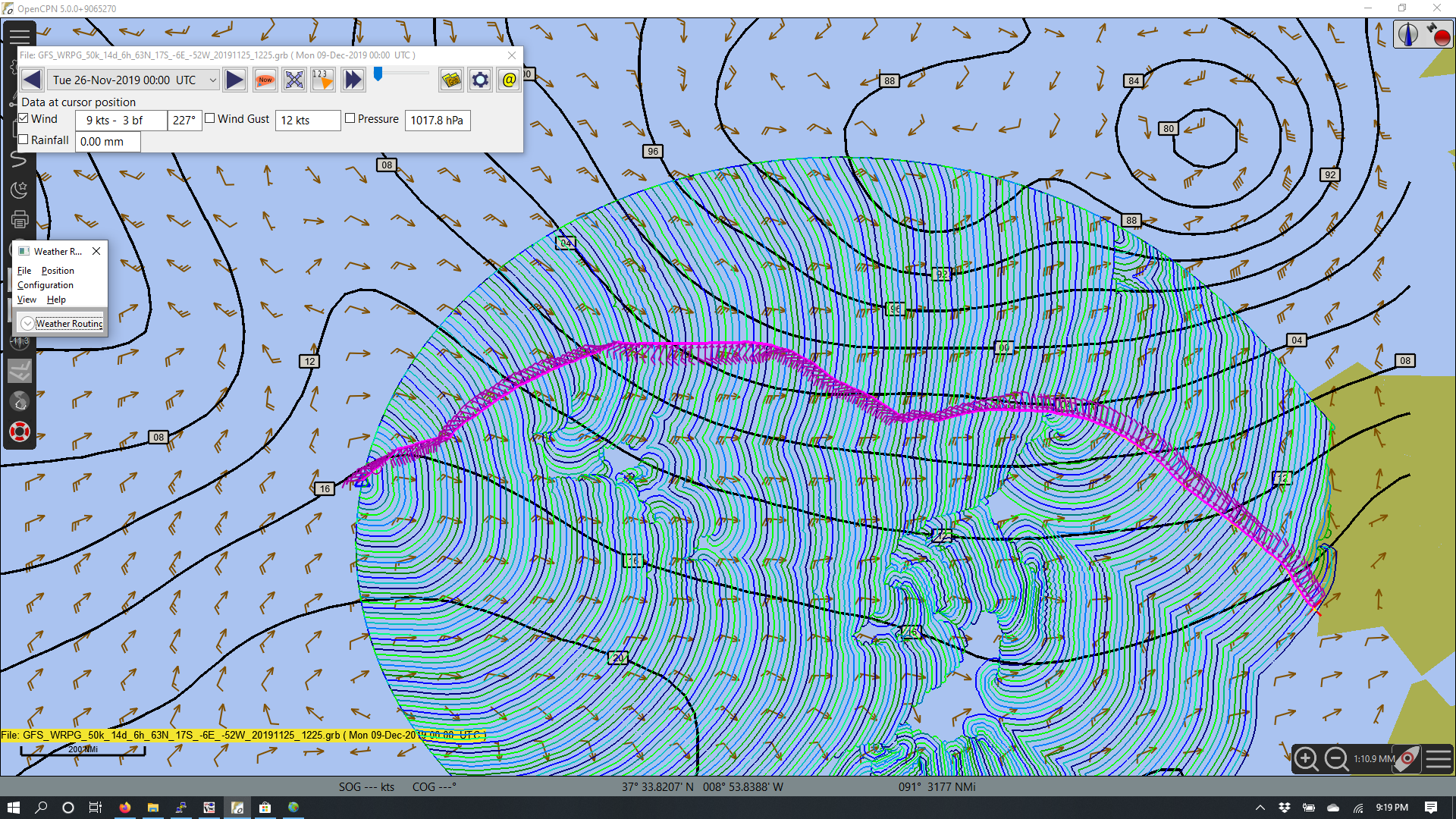

So, mostly for the learning experience, I added the Weather Routing plugin to my OpenCPN install and downloaded the GFS Grib to see what the routing would look like. Here's why I came up with, doing just a little guessing at their polars, and leaving the other settings as default:
This route has them arriving early on the 3rd, though my guesses at polar speeds are only wild guesses.
Really interesting to see how OpenCPN has all of this integrated now. There are a lot of other options in the Grib and Weather Routing plugins that I haven't played with yet either. Lots to explore and learn.
It also does matter what Grib you use. Loading one of the PredictWind Grib models takes a more southerly route instead, and arriving 15 hours later.
Sadly for @JamesG161 I can't find a combination of models and settings yet that moves arrival past December 9th. :beer:

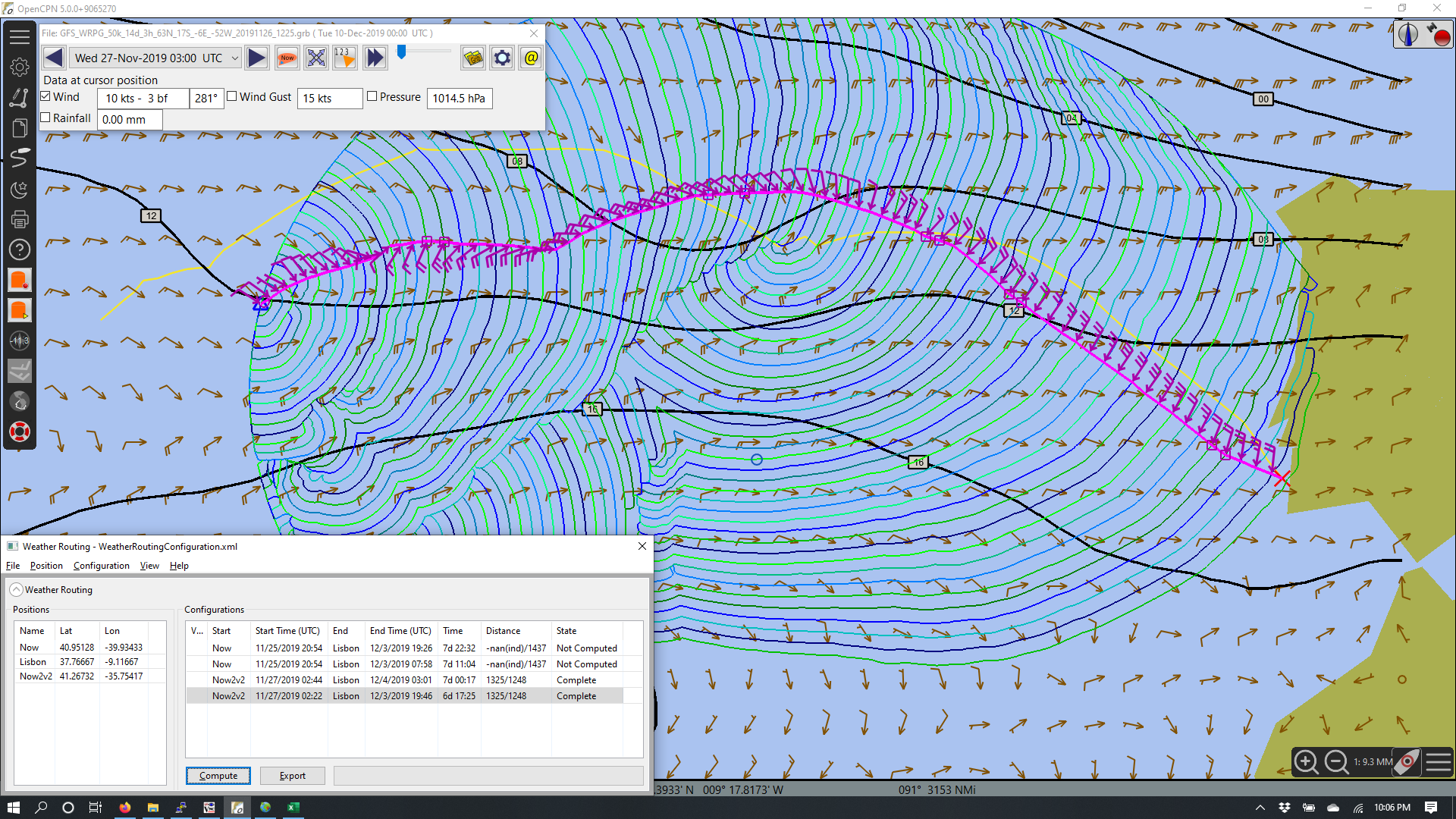

Here's what OpenCPN predicts for their route now (using the latest GFS Grib) -
I found a Polar for an Outremer 45, and slowed it down to match the types of speeds we've seen them going on this trip (probably due to ocean waves and not sailing the boat full out for comfort). ETA to Lisbon is now late on December 3rd.
The purple line is today's prediction; The yellow line above it is yesterday's. Looks like the rest of the trip is split into two halves - calm between meandering systems, followed by pretty strong winds on the beam for the last couple days.
