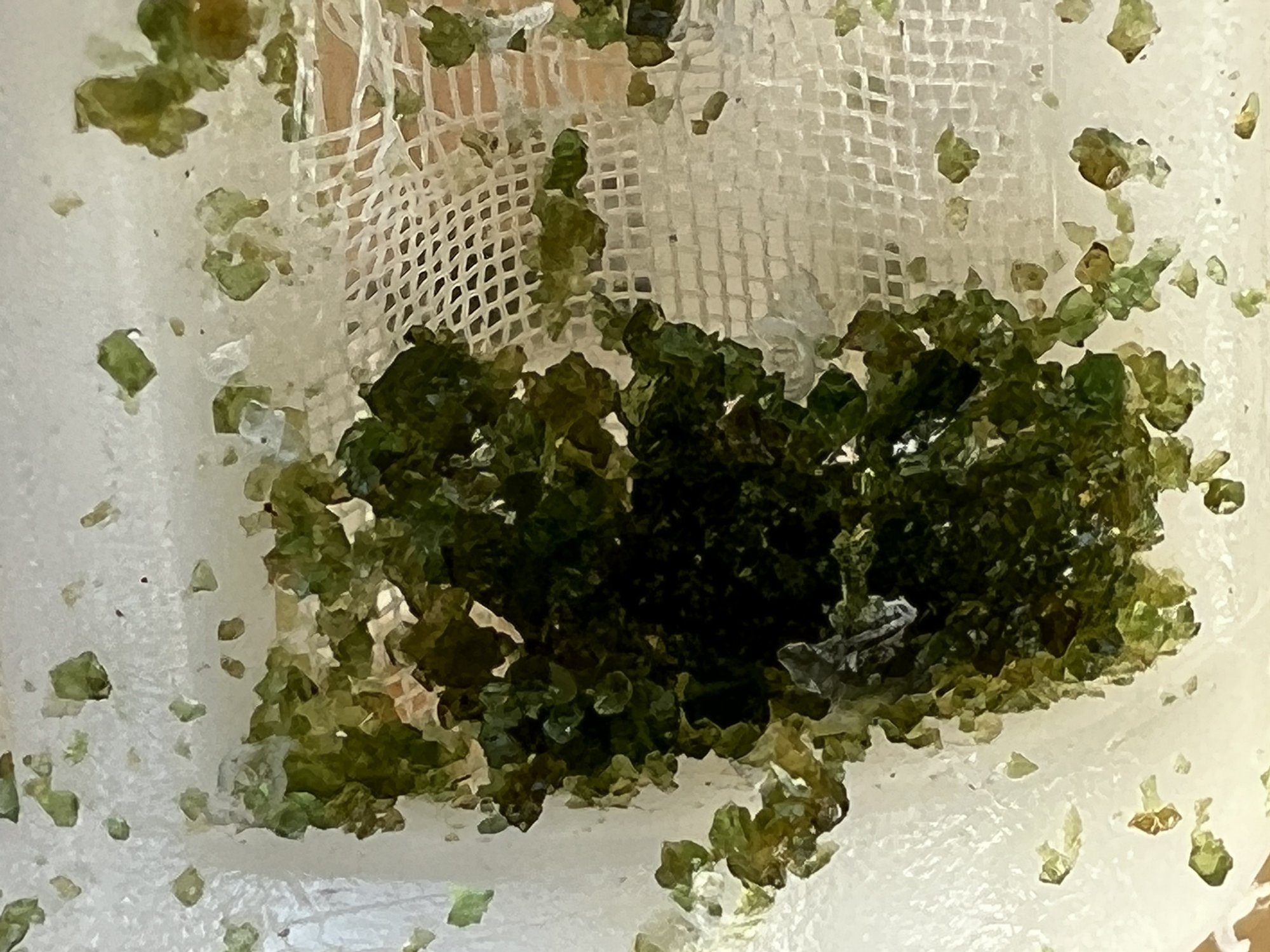

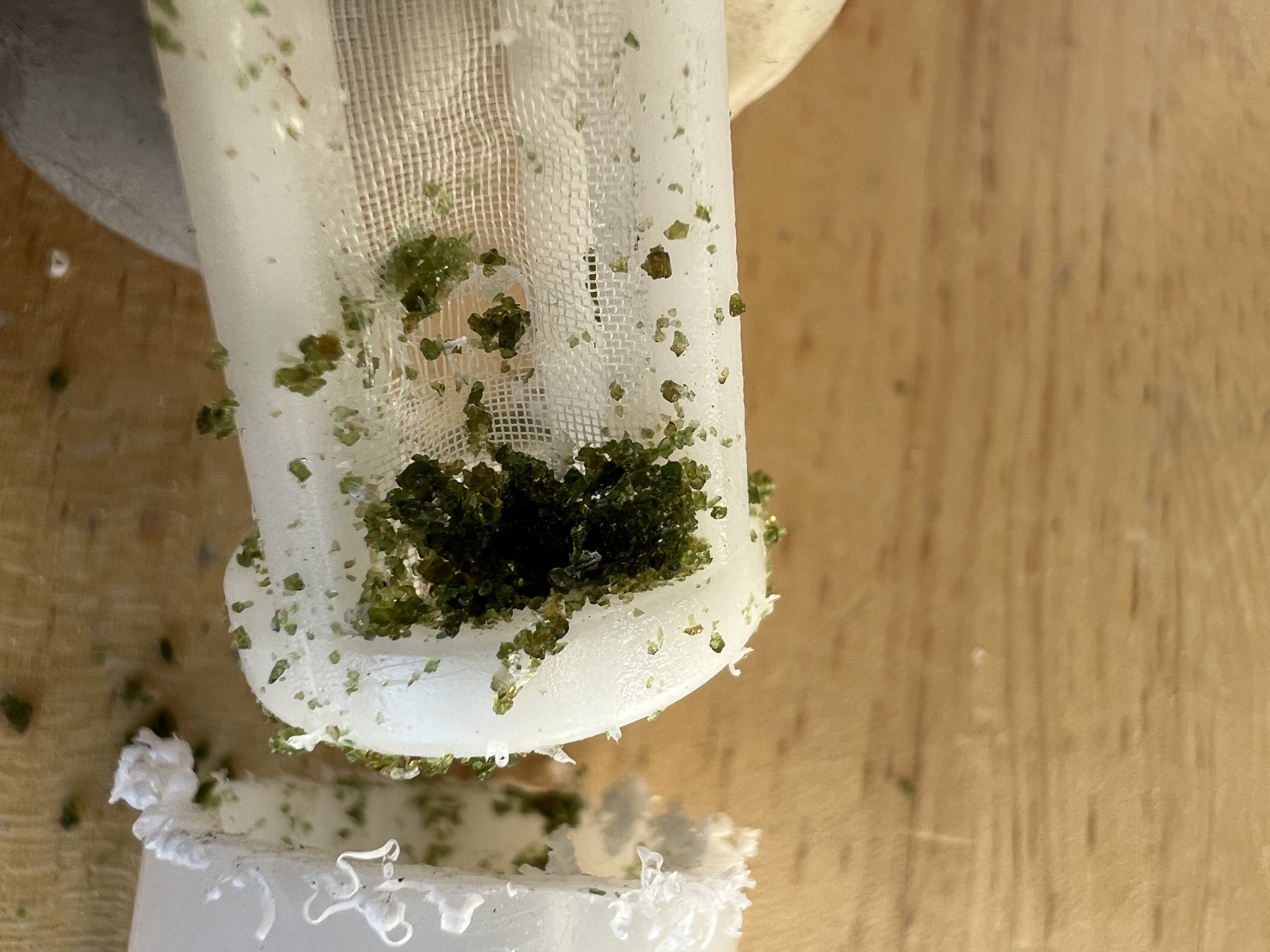

After having fuel starvation issues I have switched out my fuel filter on my 9.9hp outboard 3 times recently. The first couple of times i was out sailing/ motoring and I switched each filter out a day apart......he 3rd time I cut the filter open and found green crystals in the filter (see attached). Keep in mind that less than 3 gallons of fuel has ran through the lines and the filter. I syphoned out the fuel from both tanks through a filter and there was a small amount of brown sludge left in the filter. I then attached a clean rag to a stick and drained every drop of fuel and small dark particles that I could see in both plastic 3 gal fuel tanks.
They appear to be completely clean now, though I cannot clean the lines effectively.
Prior to this the engine ran flawlessly every weekend for months. I am curious if anyone has experienced this issue? Perhaps is was a bad batch of fuel? Maybe I should filter fuel when filling the 3 gal tanks? Maybe the fuel had a higher ethanol content? I just don't know so looking for suggestions.

Somebody put sugar in your fueltank? Sugar is a known sabotage act of petrol engines.
10,244
Going to guess a bad batch of gasoline, since it was in the plastic can before getting to the engine.. a slightly educated guess might be that the gasoline came from an underground tank that had recently been filled which stirred up some water/algae/schmutz that got to you.
Likes: ggrizzard
13,027
Are the cyrstals soluble in water? Have you tried putting one on the tip of your tonge?:yikes: It is not recommended but I definitly would have. :facepalm:

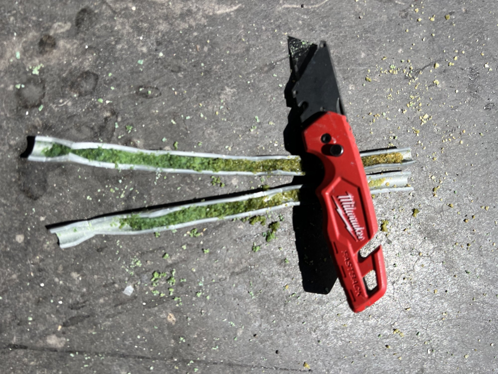

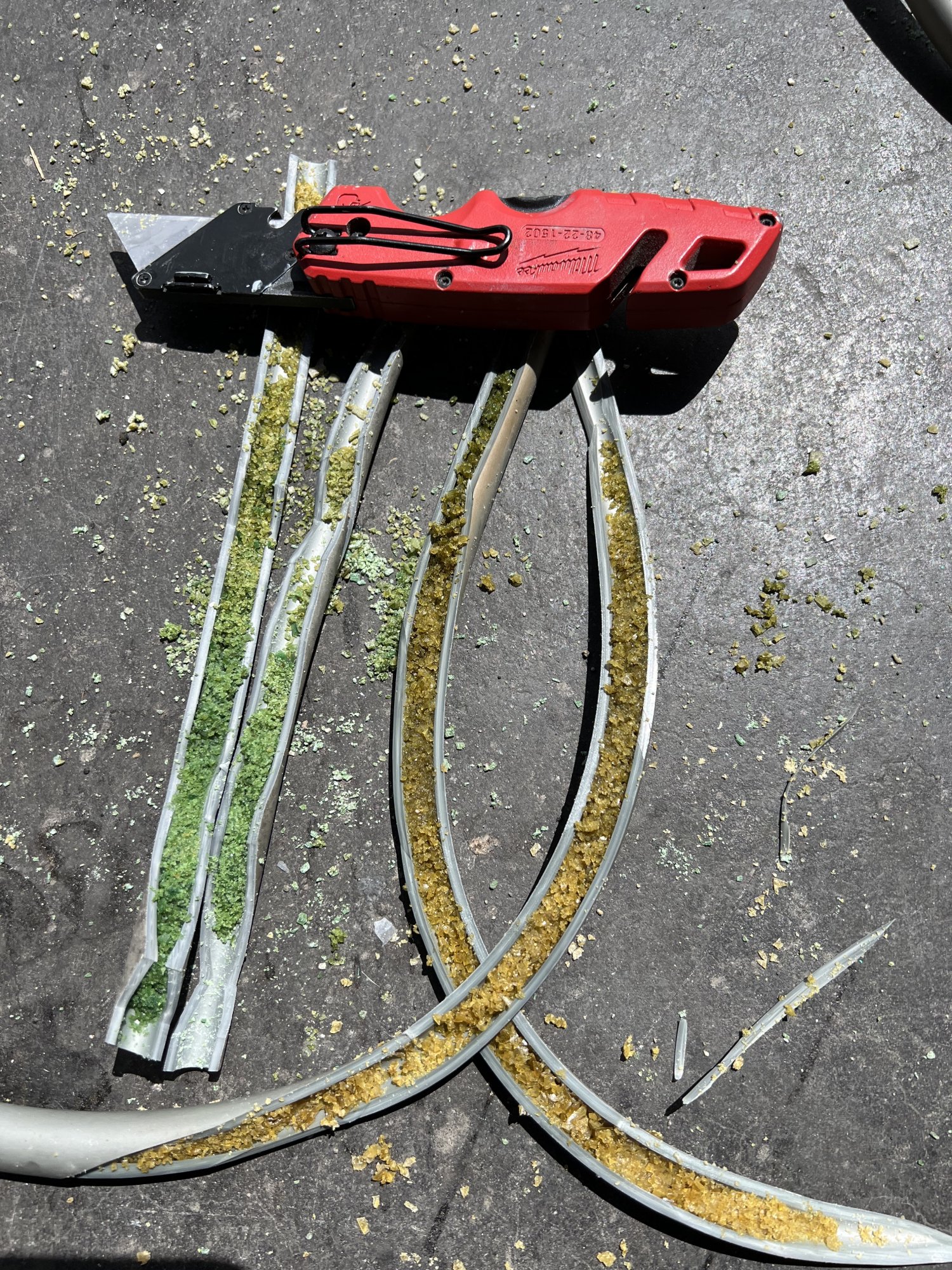

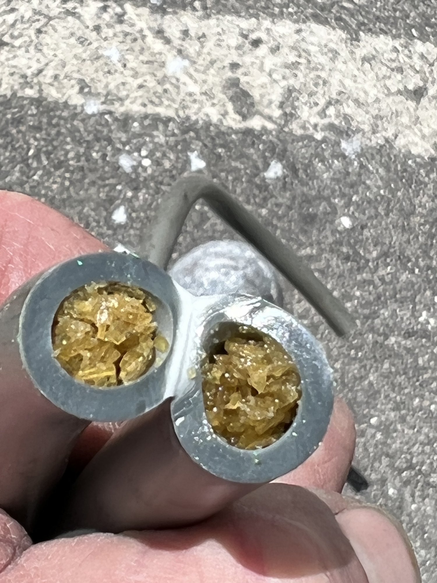

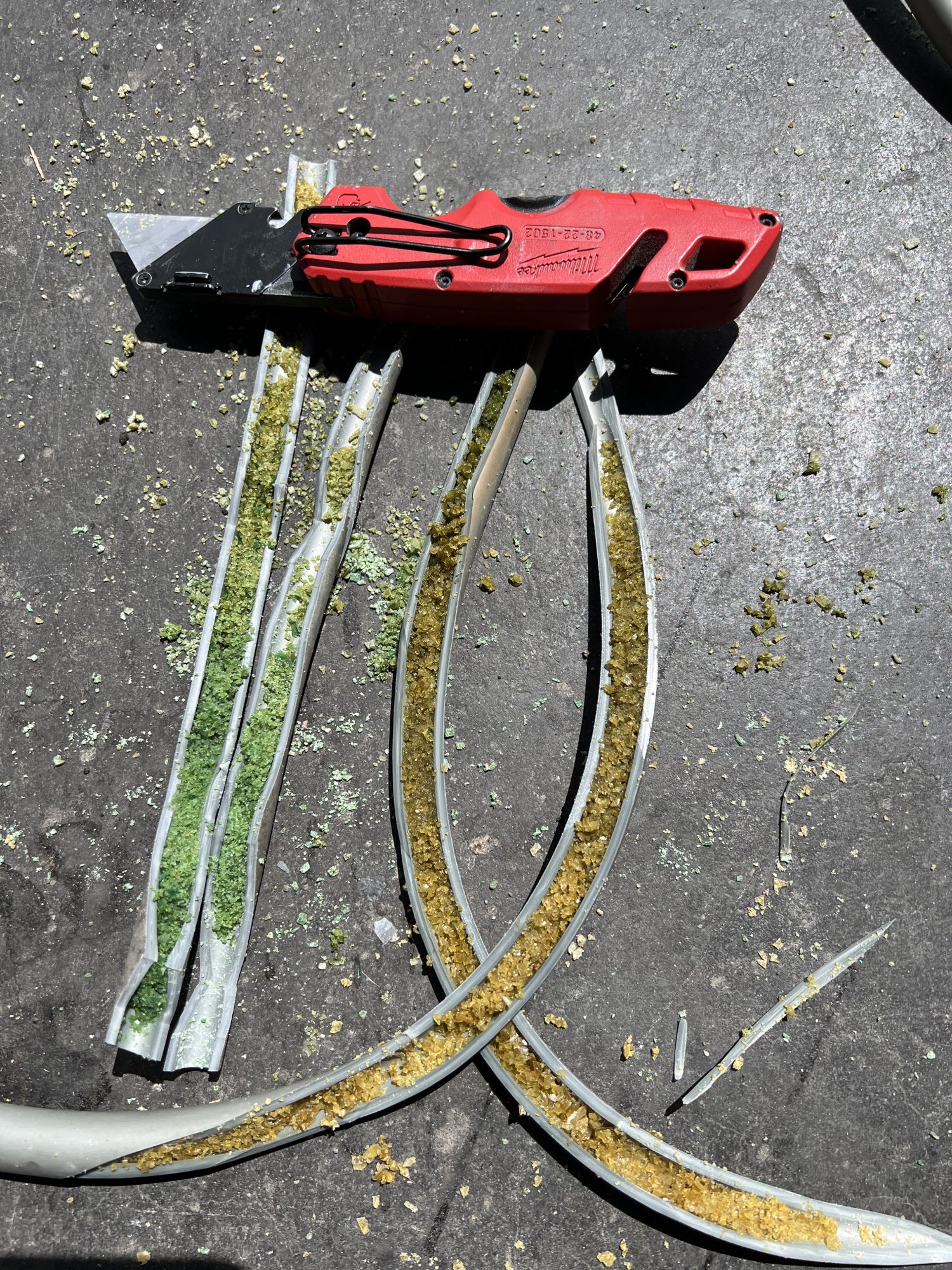

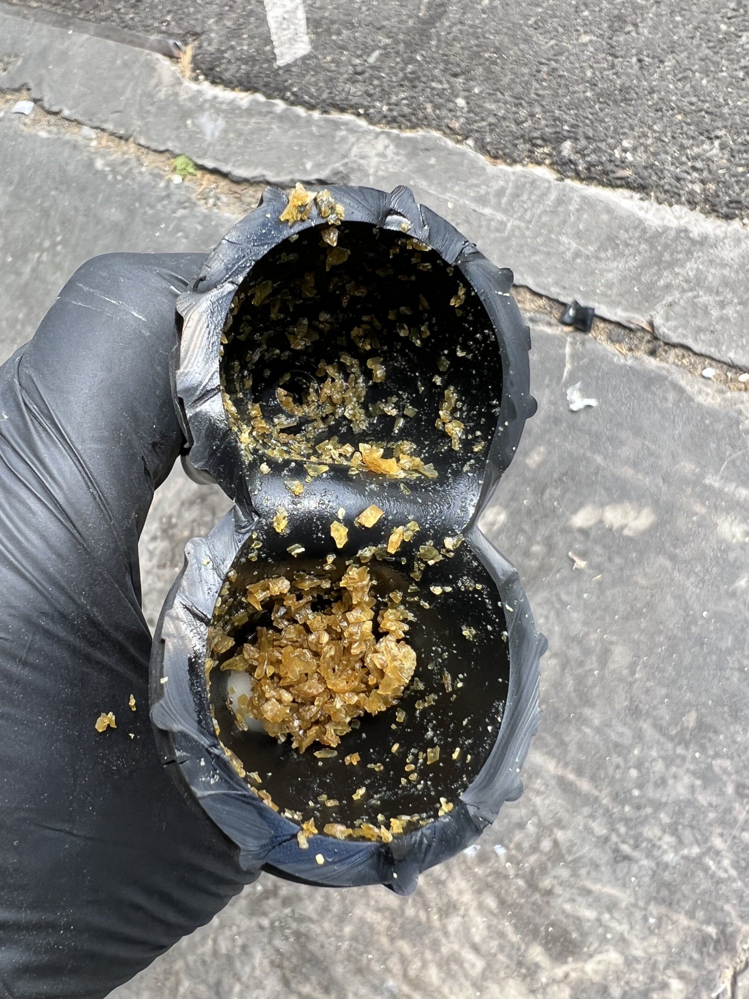

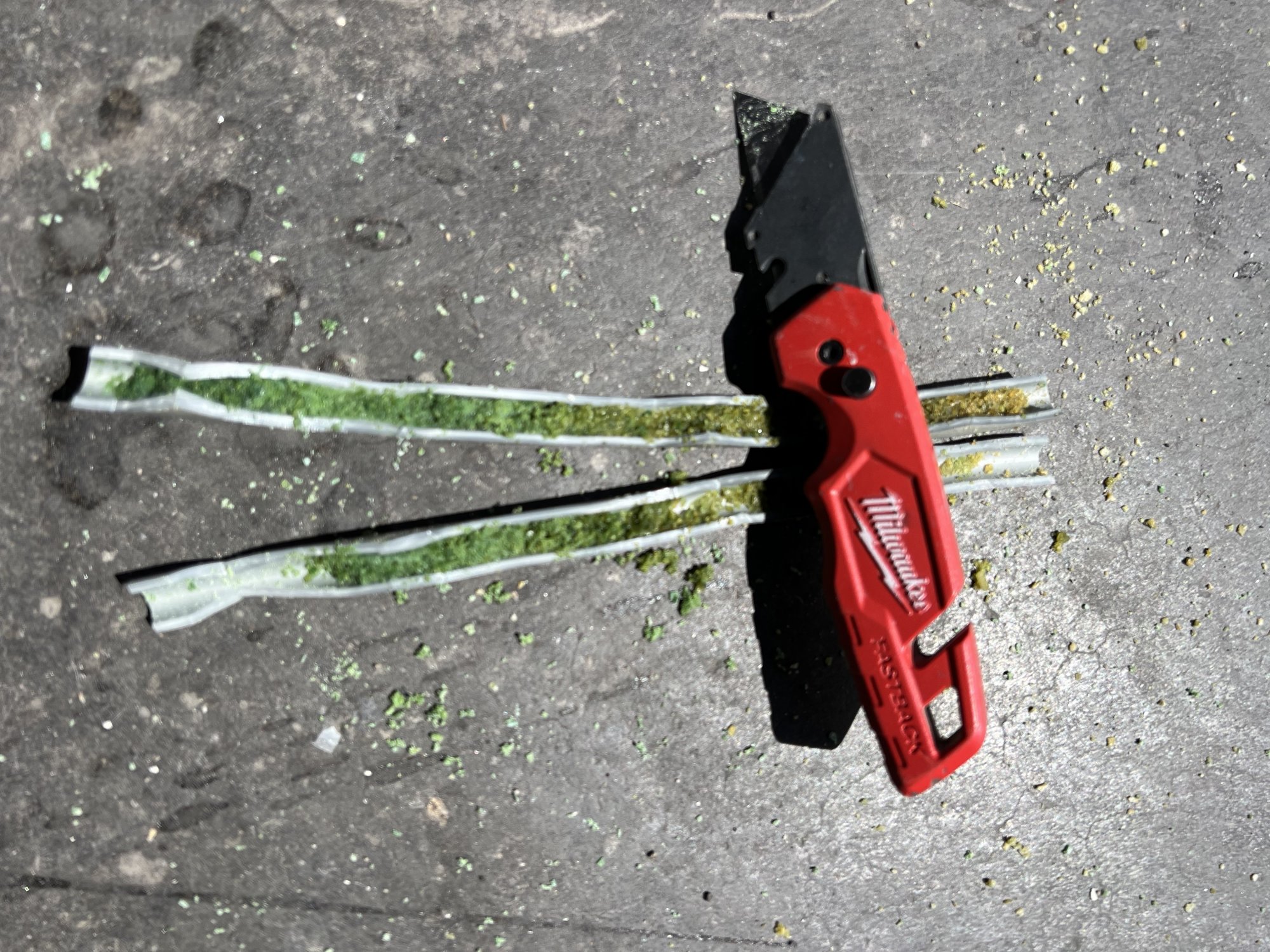

So today I pulled the fuel lines off and cut them at the hose clamps. Pushed a rag through like cleaning a rifle and it got stuck in one of the two lines. I filleted the line in 1/2 to see and was blown away by the amount of build up considering that the 3 gal tank showed no such signs. See attached photos. Line has been replaced, filter replaced again and I ran the engine for about 30 mins with no issues.
The black photo is the compression bulb cut in 2. The other line was completely clear. The prior boat owner was in Oklahoma. I know almost every crevice of the boat had dirt dobbers, cant imagine how something like this could build up other than bad fuel.
14,170
Well, the mystery of the fuel starvation is solved. Now for the next mystery, what is that stuff. Maybe one of our resident chemists would like a sample to analyze.

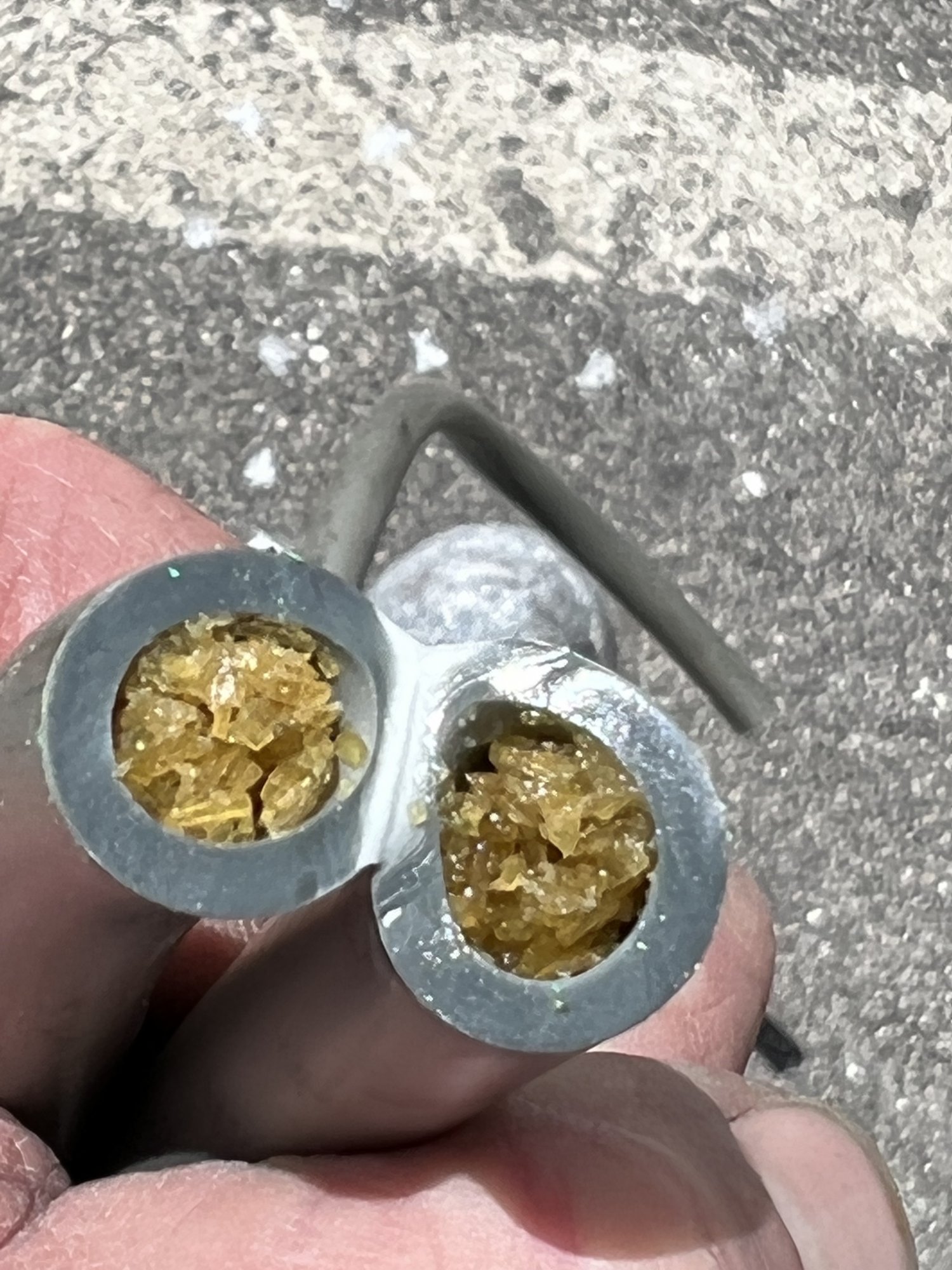

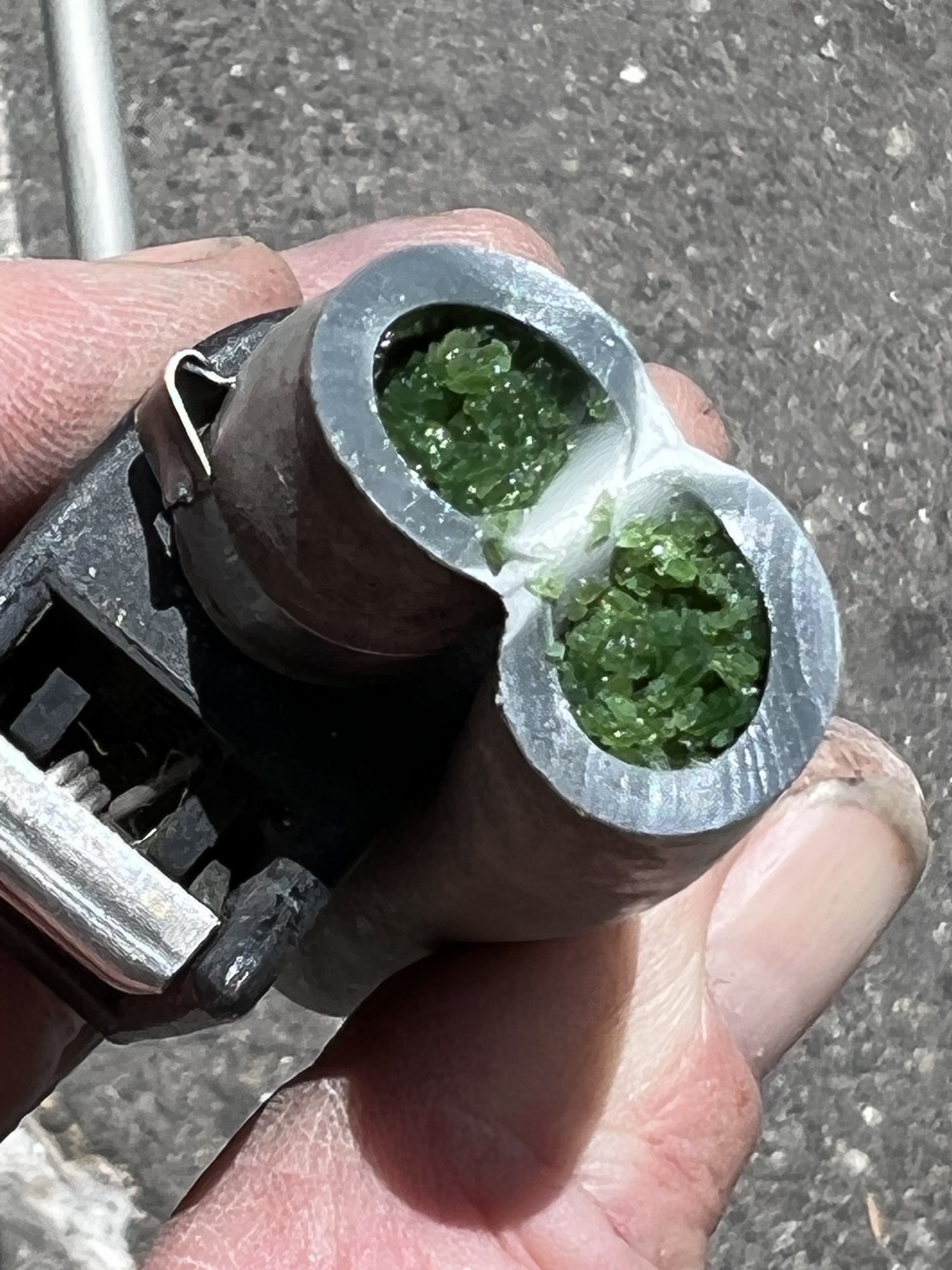

I would put a few a small sample in water and see if it dissolves. I would also put a small sample on a hot pan and see if it melts. Looks like sugar or salt to me.
13,027
That is not dirt or bacterial growth. It would not be crystalline if it were. Somebody added a salt or a sugar-like compound to your gas. Is there an odor associated with the cyrstals?

So, I see your fuel lines are grey… how old are they? The reason I ask, is SeaDoo and other water sports craft used these grey fuel lines back in the 90’s and early 2000’s that were not suitable for fuels with ethanol. Here in WA we have been using 10% ethanol since 91/92 ish. The fuel lines took a few years to deteriorate to the point yours are now, but it would happen. And the crystals could easily be the ethanol crystallizing. It’s possible it’s sugar, but sugar doesn’t usually turn green. Brown yes green no. When I see green sludge or crystals in grey fuel lines I think about all the Seadoos I have fixed over the years.

It was not sugar, It did not dissolve in hot water. Also, I have seen extensive comments regarding the break down of the grey fuel hoses. These hoses did not breaking down at all. I decided to only use premium gas from now on to avoid any gumming up in the carb.
