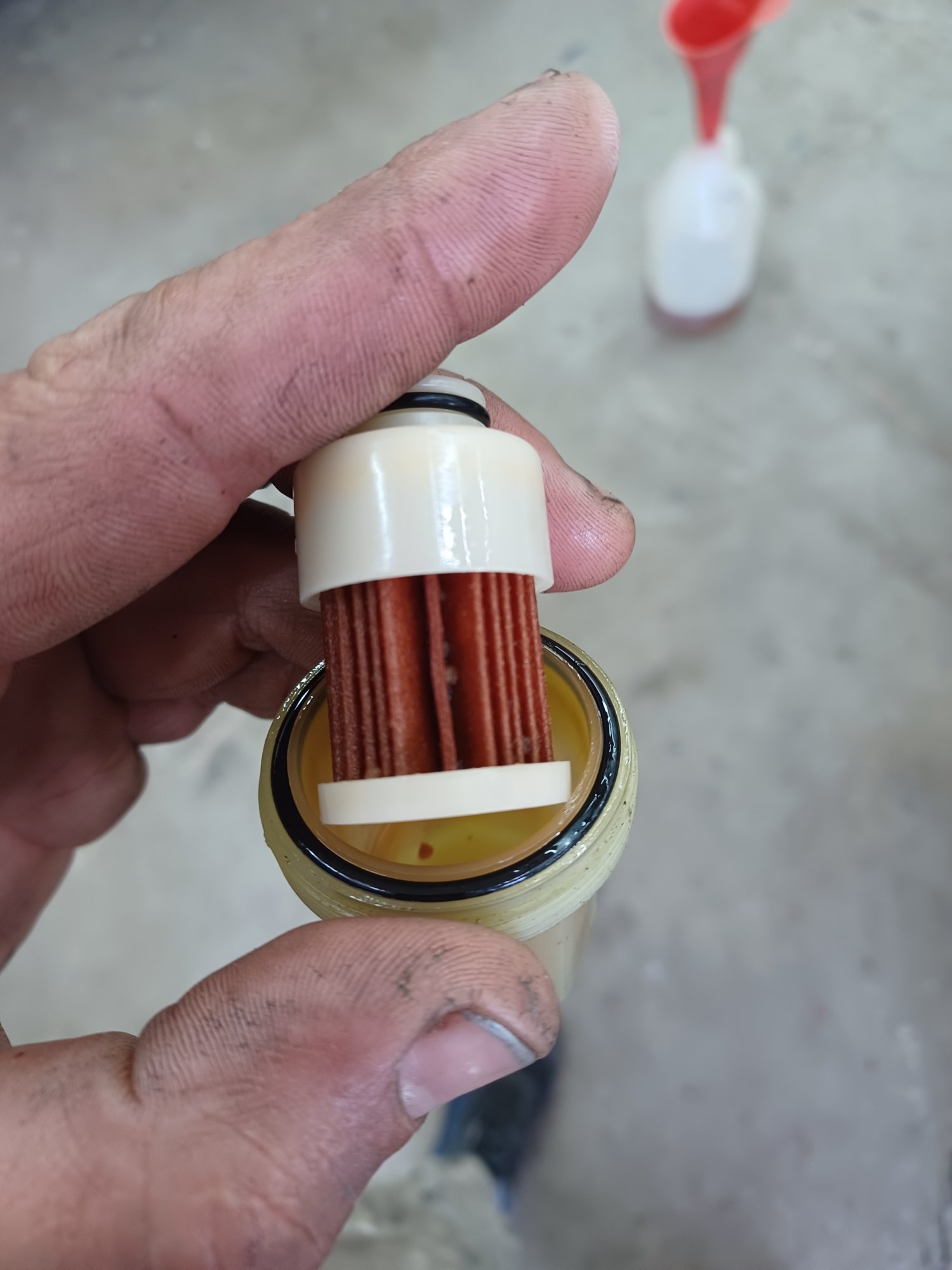

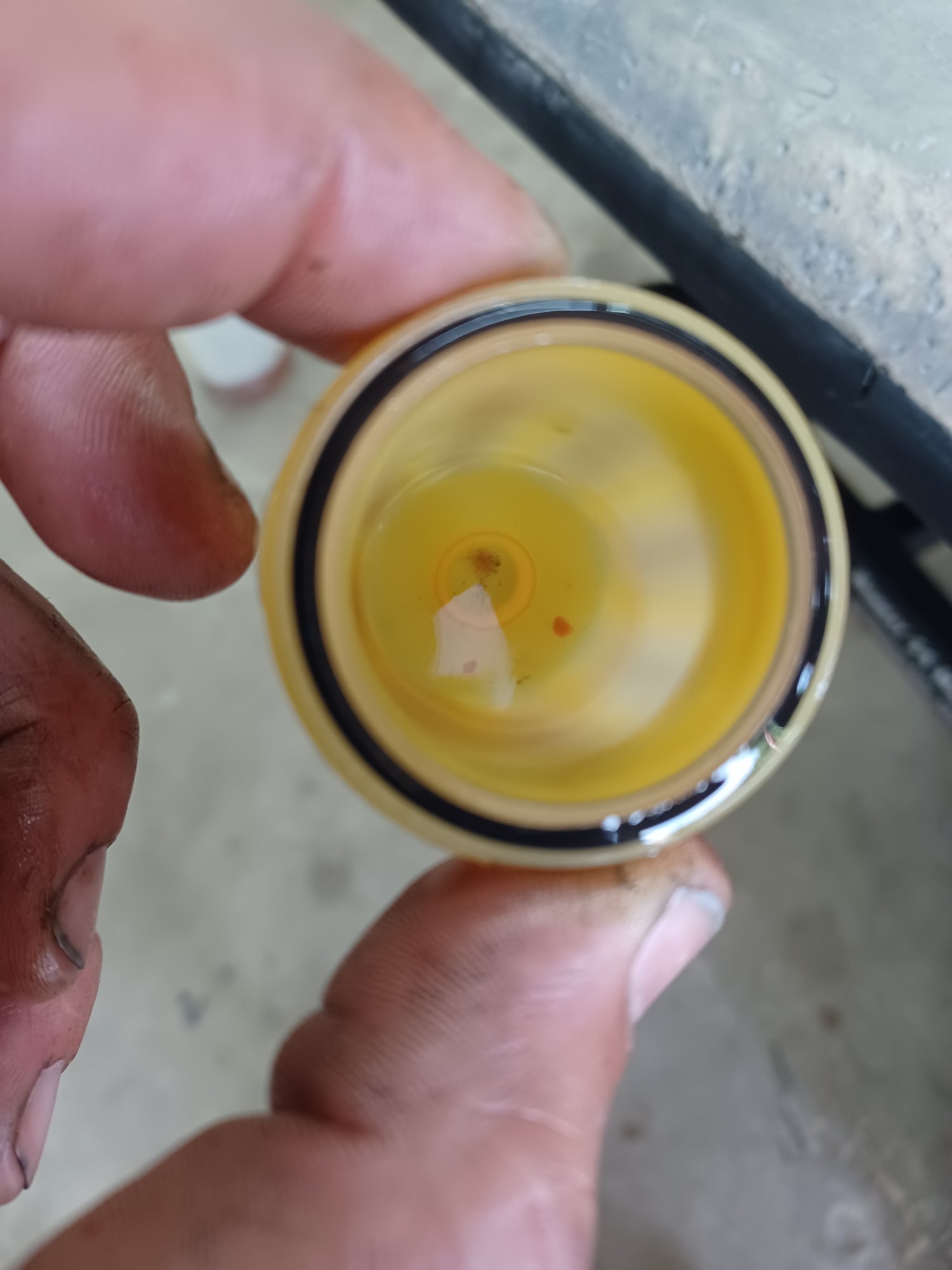

The way I see it, thinking as a detective, there are only two possibilities. One, someone sabotaged your fuel tank, or two, you accidentally filled your fuel tank with something other than fuel. I am not a chemist but I doubt there is any gasoline in those fuel lines; it must be something else.

I think it would be worth taking some of the crystals to a lab to get analyzed just to satisfy our curiosity. This is one of the stranger things I've seen on a boat.

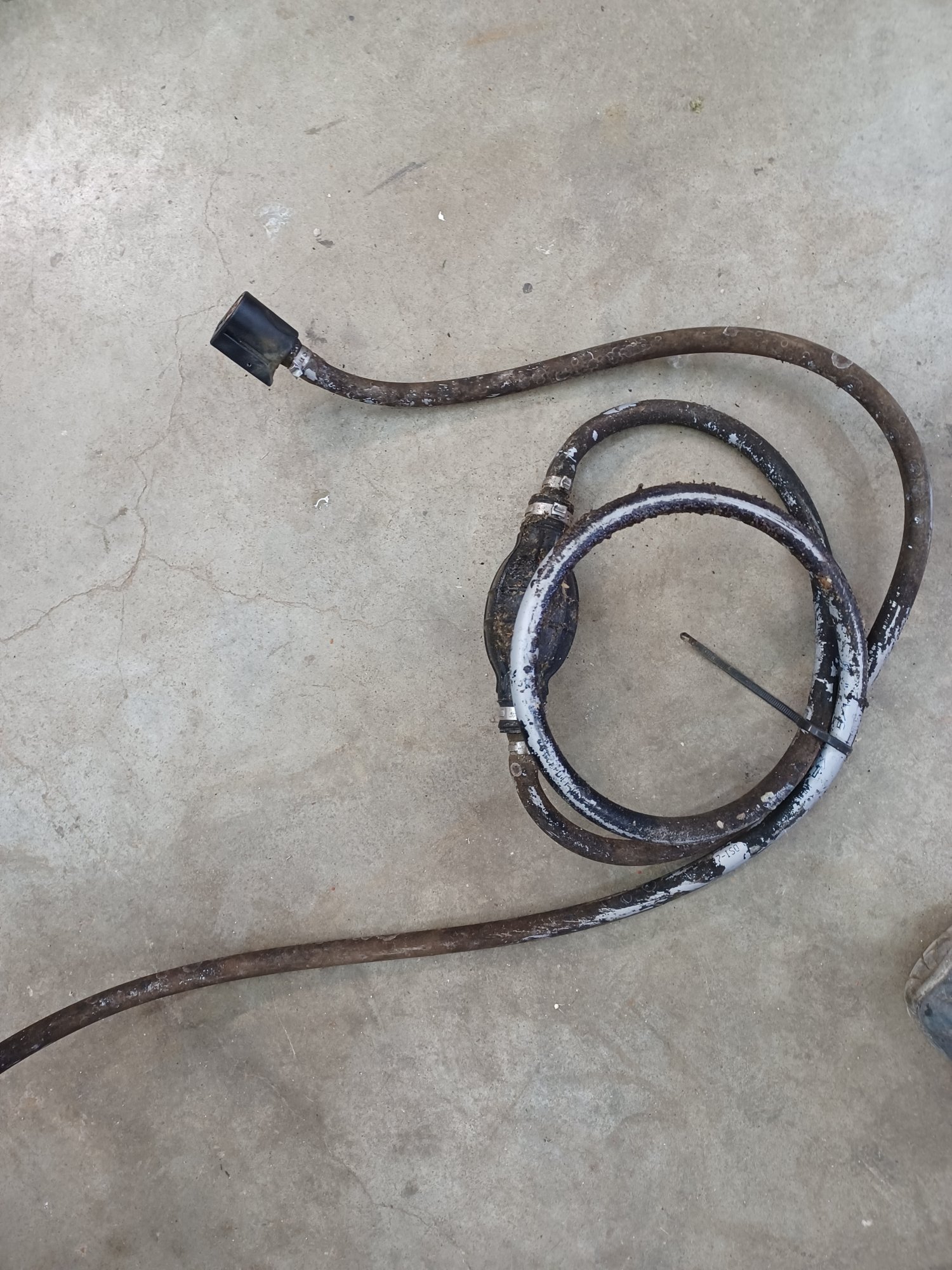

That grey fuel line has a liner that appears to be completely gone.
Don't use that stuff usually found at WalMart or WM. Go to a decent auto parts place and buy the black rubber fuel line. It may take a couple of stops to find but get the Coast Guard approved fuel line, its printed on the hose.
I think those crystals are the liner that has broken down.
This is what I was talking about from the Seadoos I have worked on. I have never seen it as a crystal, but a green gooey sludge that was once a fuel line. I imagine it could crystallize once dried, but I more figured it would just form a thin nasty film when dry. Honestly I never kept any of those lines around to find out what happens, they go into the garbage and the carbs get cleaned.

Replace your fuel lines. It's the liner. I see it in green and tan. Ethanol exacerbates the problem.

This makes the most sense, not very mysterious, but makes sense
Yeah, I find it in the fuel pumps a lot too. I've seen v6 mercury outboards with the entire inlet side of the fuel pump full of it. It's pretty common around here.

Here's some brown crystals. It's from this crappy old gray fuel line. Pretty common. Yes, it looks like dirty salt/sugar.
This one had just started failing on an 04 60hp merc 4stroke. Assuming the filter caught it before it hit the VST, we will clean the fuel pump, replace entire line/bulb/fitting
