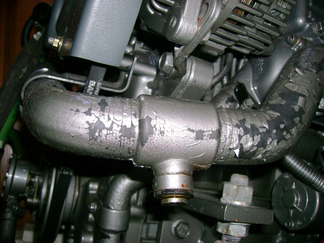

I have a Yanmar 3YM30 engine in my 5 yr old Hunter 33.
I didn't really pay attention when it was new, but I now realize that the engine was painted a gray color. I notice it now because the paint is flaking off the flexible parts - the rubber tubing etc. It's actually creating quite a mess. Is this normal? I'm wondering if the engine was actually an older one (a used one) that had been prettied up to appear new. I'm thinking this in part because the serial number appears to make it quite old (E04448) for a boat that is only 5 years old. Any help or suggestions would be welcome.

................... pretty well for the life of the engine. My 2GM20F is now thirteen years old and the grey paint is STILL flaking off the hoses and other flexible parts. Makes a bit of a mess but I just vacuum it up at every spring cleaning.

The 3YM series is one of Yanmar's newer designs - that's probably why you have a low SN.

I have a 2005 Hunter 33, It was also painted gray. there is some flaking of the paint from the flexible tubing, but not much. I'm not down at the marina so I can't give you a serial #.

Like already mentioned the #YM is the newer model Yanmar and no way you got a older used engine.

Sounds normal, Syoun. The serial number is lower than ya might expect because that is a European assembled engine. The only problem with that here in the US is that some ancilliary parts are slightly different.. I don't remember which ones, but ya have to make it a point to tell any service or parts guys that it is an "E" engine.
ENJOY.. My 27 year old gray Yanmar sometimes still flakes paint off the hoses ..

Perfectly normal, but a PITA. I too get flakes constantly in the oil drip pan. My 05 3YM30 is around that same serial no., so is nothing unusual either.

Thanks for all your responses here - very useful (at least I know the paint is normal). I had suspected it because of the overheating problem & whether it was a symptom of my being taken for a ride!
